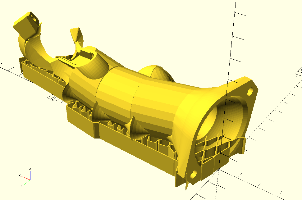

Hello Everyone
i am sorry if i am not off-topic with this,hope it is ok
i have thrown together a javascript tool to semi-automatically create
continuous sinusoidal support for my openscad models .i tried but failed
to implement it using  scad language only.
its aim is to minimize sharp corners and empty head moves(with filament
retractions) in the  inbuilt support of my openscad model.
in case you want to have a look,  i have put together some instructions
and put the tool on the github:
https://github.com/solidboredom/sinus-support/
After putting quite some effort into an .scad version of it, i could not
figure a possibility to make it continous around the parts outline
using openscad only, so i have aborted my efforts and created this
javascript tool.
external tool makes  the whole process more complicated, you have to
export SVG  and import twice.
so how could i simplify the process? is the only  way to implement
something like this directly in the source-code of openscad source?
reason i have made it:
i  was unhappy with slic3r generated support for long time.
it works very good on simple parts, but It fails quite a lot on my
complex models, and it fills all gaps in any height. i only wanted to
support the part from below.
the simple inbuilt support i have created before using n openscad  only,
always been slowing down my print because of discontinuities and sharp
corners.
so is this  possible to streamline the exchange between openscad and
javascript? (i actually do not think so)  is it time for an open
interface for openscad?
Peter

Pretty cool project.
With respect to your comments about an "open interface", I feel this is the
kind of project that ought to be possible in OpenSCAD. You are taking one
geometric object and transforming it into another, and that's exactly the
sort of thing that OpenSCAD ought to be good at, especially if the
application is 3D printing.
I don't know exactly what your roadblock was, but for support generation, I
think the missing feature is a full set of capabilities for querying the
geometry of an object. Creating a "plugin interface" to OpenSCAD is a big
can of worms, and in some ways it's easier to just fix the deficiencies in
the language. (Both approaches, plugins and geometric queries, are
controversial within the dev team, but my vote is to make the language more
powerful.)
As for Slic3r having poor support generation, this was being discussed in
another forum that I participate in, and a number of people recommend using
Simplify3D instead.
Note that Simplify3D is proprietary and costs money, but for some users,
that's not a problem. On the other hand, if OpenSCAD made it easier for
people to experiment with new support algorithms, then that could allow
progress to be made within the open source community without the
requirement to hack the internals of Slic3r or Cura.

Thanks Doug!
anyways by now i started to think  openscad really lacks extensibility,
through plugins (like i.e. in inkscape) there would be more efficient
possibilities for the problems at hand,perhaps there would alse be less
openscad-variants, and more improvements.
the reason to switch to Javascript for me was indeed  the inability to
query existing geometry,
If the question at hand was, wether to make openscad geomeries
querieable or to build the plugin interface, my answer would be a
definitive "both"!
but i just like you i consider the queriability more important.
if one  needs a result quickly and can't wait untill openscad evolves to
more extensibility,  going the Javascript route like i did is perhaps
not the worst solution,
if anybody has a use for my script as base for his own processing i will
be very happy. and would be even more so if it will me made availiable
for others to use
and thanks for the hint on Simplify3D, but it looks like i will not need
it anymore :)
Peter

How do you print your support structures? Do you slice them separately and
apply a Z offset?

i just include the support structure back into the .scad code of my model (or import the stl of the model into the support sructure .scad code) they get "Unioned" to a new model with inbuilt suport, which i can export as stl and slice. it is not a "proper" support in terms of own gcode settings (speed, extrusion thickness, etc..) but i do not care as long as i get better results than with the native one. so i just slice it as if it was a part of the models Material rather than trying to acheive it through slic3rs own support structues. Peter On 10.03.2016 19:32, nop head wrote: > How do you print your support structures? Do you slice them separately > and apply a Z offset? > > On 10 March 2016 at 15:46, pproj@posteo.de <pproj@posteo.de > <mailto:pproj@posteo.de>> wrote: > > Thanks Doug! > > anyways by now i started to think openscad really lacks > extensibility, through plugins (like i.e. in inkscape) there would > be more efficient possibilities for the problems at hand,perhaps > there would alse be less openscad-variants, and more improvements. > > the reason to switch to Javascript for me was indeed the > inability to query existing geometry, > > If the question at hand was, wether to make openscad geomeries > querieable or to build the plugin interface, my answer would be a > definitive "both"! > but i just like you i consider the queriability more important. > > > if one needs a result quickly and can't wait untill openscad > evolves to more extensibility, going the Javascript route like i > did is perhaps not the worst solution, > if anybody has a use for my script as base for his own processing > i will be very happy. and would be even more so if it will me made > availiable for others to use > > and thanks for the hint on Simplify3D, but it looks like i will > not need it anymore :) > Peter > > On 10.03.2016 03:19, doug moen wrote: >> Pretty cool project. >> >> With respect to your comments about an "open interface", I feel >> this is the kind of project that ought to be possible in >> OpenSCAD. You are taking one geometric object and transforming it >> into another, and that's exactly the sort of thing that OpenSCAD >> ought to be good at, especially if the application is 3D printing. >> >> I don't know exactly what your roadblock was, but for support >> generation, I think the missing feature is a full set of >> capabilities for querying the geometry of an object. Creating a >> "plugin interface" to OpenSCAD is a big can of worms, and in some >> ways it's easier to just fix the deficiencies in the language. >> (Both approaches, plugins and geometric queries, are >> controversial within the dev team, but my vote is to make the >> language more powerful.) >> >> As for Slic3r having poor support generation, this was being >> discussed in another forum that I participate in, and a number of >> people recommend using Simplify3D instead. >> >> Note that Simplify3D is proprietary and costs money, but for some >> users, that's not a problem. On the other hand, if OpenSCAD made >> it easier for people to experiment with new support algorithms, >> then that could allow progress to be made within the open source >> community without the requirement to hack the internals of Slic3r >> or Cura. >> >> On 9 March 2016 at 19:12, pproj <pproj@posteo.de >> <mailto:pproj@posteo.de>> wrote: >> >> Hello Everyone >> i am sorry if i am not off-topic with this,hope it is ok >> >> i have thrown together a javascript tool to >> semi-automatically create continuous sinusoidal support for >> my openscad models .i tried but failed to implement it using >> scad language only. >> >> its aim is to minimize sharp corners and empty head >> moves(with filament retractions) in the inbuilt support of >> my openscad model. >> >> in case you want to have a look, i have put together some >> instructions and put the tool on the github: >> https://github.com/solidboredom/sinus-support/ >> >> >> After putting quite some effort into an .scad version of it, >> i could not figure a possibility to make it _continous_ >> around the parts outline using openscad only, so i have >> aborted my efforts and created this javascript tool. >> >> external tool makes the whole process more complicated, you >> have to export SVG and import twice. >> so how could i simplify the process? is the only way to >> implement something like this directly in the source-code of >> openscad source? >> >> reason i have made it: >> i was unhappy with slic3r generated support for long time. >> it works very good on simple parts, but It fails quite a lot >> on my complex models, and it fills all gaps in any height. i >> only wanted to support the part from below. >> the simple inbuilt support i have created before using n >> openscad only, always been slowing down my print because of >> discontinuities and sharp corners. >> >> so is this possible to streamline the exchange between >> openscad and javascript? (i actually do not think so) is it >> time for an open interface for openscad? >> >> Peter >> >> >> _______________________________________________ >> OpenSCAD mailing list >> Discuss@lists.openscad.org <mailto:Discuss@lists.openscad.org> >> http://lists.openscad.org/mailman/listinfo/discuss_lists.openscad.org >> >> >> >> >> >> _______________________________________________ >> OpenSCAD mailing list >> Discuss@lists.openscad.org <mailto:Discuss@lists.openscad.org> >> http://lists.openscad.org/mailman/listinfo/discuss_lists.openscad.org > > > _______________________________________________ > OpenSCAD mailing list > Discuss@lists.openscad.org <mailto:Discuss@lists.openscad.org> > http://lists.openscad.org/mailman/listinfo/discuss_lists.openscad.org > > > > > _______________________________________________ > OpenSCAD mailing list > Discuss@lists.openscad.org > http://lists.openscad.org/mailman/listinfo/discuss_lists.openscad.org
pproj@posteo.de
Fri, Mar 11, 2016 3:17 PM
Rudolf yes i agree you have a point here.
and of course it would be difficult to program all the functionality a
native support can give you in javascript,
but in my experiments, when slicing the thin  structures in the .stl  it
turned out,  slic3r produces
gcode which seems close enough to what is needed to replace its native
support structures. ( for the parts i have tried  so far at least).
as to the proper alignment of the support material, the art itself and
interface layers, again i agree, that would be quite a big task to
program it all in the js, but i think it is not really eededin in very
may cases.
i do nor mind if i have no thinned out support interface layers, if the
support is thin enough to easy break it off.
i do not mind if the support fills a bit of my model to a certain
heigh,t like in the picture,i have attached, for the  same reason.
creating fine gridded interface layers on top of the coarser  support
(with longer sinus periods and bigger amplitudes at the bottom) might be
needed in some cases, but should be doable in openscad as well, if one
really needs it.
so of course this not an ideal approach, but i think it might be just
practical enough to quickly get  quickly printing  support done quickly.
from what i grasp, it is actually not that difficult to do much of what
you have mentioned in  opencad either.
i.e. just as you write creating a hull of the model and subtracting it
from the support structures will help,
if the Model is not convex it will not quite work, but one can
"subdivide" the model using a small cube  "rastering" the Space
containing your model, creating smaller Hulls in the intersection with
this cube and then unioning them together and subtracting the whole
thing from the support structure.
creating the thinned  "support Structure interface" area where your
support meets the model does not seem that difficult in openscad either,
since one can scale the support a bit higher into the model intersect it
with the model itself, erode the intersection with minkowsi to make it
thinner and move it back just under under the model.
i actually have experimented quite a bit with smoothing and eroding of
the model with hull and minkowski or moving  "rastering" cubes  and it
works, but it is incredibly slow on a complex model.
but like i have said before  i think in quite many cases we might not
need to do any of it, but the support will still be very useful.
Peter
