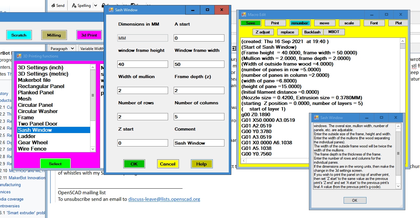

Nine or ten years ago, before the current diy fdm printing was as
popular, I fitted a purpose designed print head to my cnc mill. It all
worked fine, but it was very slow. I wrote software, for various objects
(example of a model window frame below) and that generated the gcode to
drive the mill/print head, laying down the filament one strand at a
time. No cad package, no stl file, no slicer involved, absolutely no
worry wrt level bed. This was simple g-code generation and worked well
for certain objects. However after a year or so, I removed the nozzle,
and reverted to a cnc mill. There would be no need to keep any files,
just re-enter the dimensions. There were only two filament types, pla
and  abs, and both needed no heated bed, just masking tape and
hairspray, and it was simple to preset the temperature. I may revise
that (the code used A for the extruder) and see how it compares with
trying to design in openscad and slice, etc. for the same object.  It'll
need a few things changed to get it to run in current Marlin type gcode,
but not much.
