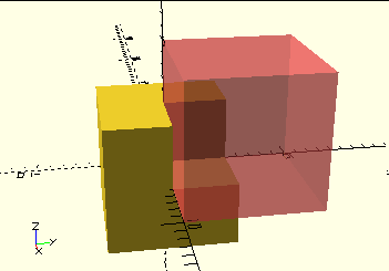

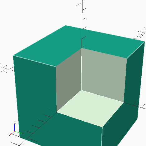

On 11/27/2020 1:28 PM, nop head wrote:
Even with booleans all the original primitives get drawn to add or
subtract. Isn't any vertex a vertex of a triangle from a tessellation
of a primitive?
I don't deeply understand the mesh geometry, but I don't think so.
I don't know how to show the triangles, but
    cube(10, center=true);
    #cube(10);
I assume that the triangles for the cube primitives are 45-45-90
triangles cutting across the diagonal one way or the other.
The three vertices at the corners of the cut-away portion are at the
centers of the faces of the two cubes, not their vertices.
(And of course the fact that they're at the centers of the faces are
just a coincidence caused by my choice of shapes to use.)
On 11/27/2020 1:28 PM, nop head wrote: > Even with booleans all the original primitives get drawn to add or > subtract. Isn't any vertex a vertex of a triangle from a tessellation > of a primitive? I don't deeply understand the mesh geometry, but I don't think so. I don't know how to show the triangles, but difference() {     cube(10, center=true);     #cube(10); } I assume that the triangles for the cube primitives are 45-45-90 triangles cutting across the diagonal one way or the other. The three vertices at the corners of the cut-away portion are at the centers of the faces of the two cubes, not their vertices. (And of course the fact that they're at the centers of the faces are just a coincidence caused by my choice of shapes to use.)
Fri, Nov 27, 2020 10:00 PM
If you show the edges, then if there is an actual vertex where edges meet
then it is a vertex of a primitive. So in that case only the point in the
middle.
The other six in the cut faces have no edges, so are not vertices in that
sense. I agree they are not calculated.
