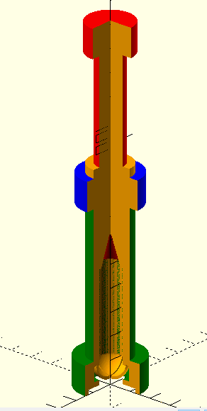

I am making an assembly for a customer consisting of 4 interlocking
parts.  I colored each and then cut into the assembly with a
difference() of a cube(), expecting the colors of the parts to persist
throughout the entire part.  Not so.
I don't know if this would be feasible, but the utility is obvious.
Anyone know of another way to visualize a series of parts like this?
Think of it as a complex syringe...

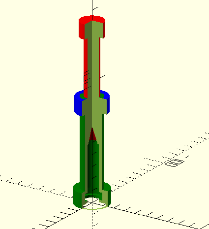

Great suggestion.  But it does not work...
I have four sections like this:
color("red")
        Plunger();
        translate([0, 0, -20])
            cube(1000);
There are four objects, colored red, blue, green, and orange. The
internal color is always the color of the last object.
Puzzling

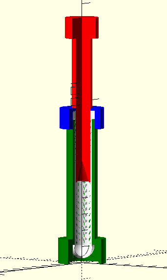

Sun, Feb 7, 2021 10:46 PM
Excellent!  if each object has a color() of a render() of the object,
then the colors work!
Thanks so much!

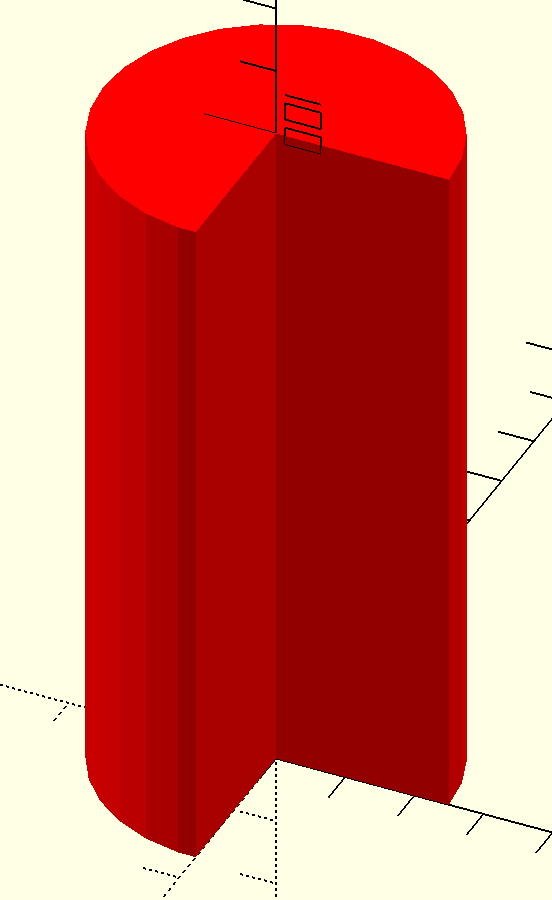

Sun, Feb 7, 2021 11:20 PM
Odd. It works for me in OpenSCAD 2021.01 (OS X):
color("red")
cylinder(d=50,h=100);
translate([0,-1000,-500]) cube(1000);
  • Revar

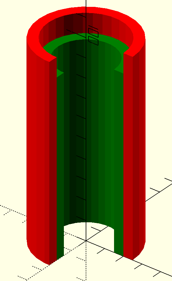

Sun, Feb 7, 2021 11:27 PM
Ahhhh.  I see.  If the removed cube has coincident faces to the other parts, the last cube’s color wins.  You can get the result you want by making the cubes very slightly offset from one another.
color("red")
cylinder(d=40,h=1000, center=true);
color("green")
cylinder(d=40,h=90);
cylinder(d=30,h=1000, center=true);
translate([-0.01,-1000+0.01,-500]) cube(1000);
