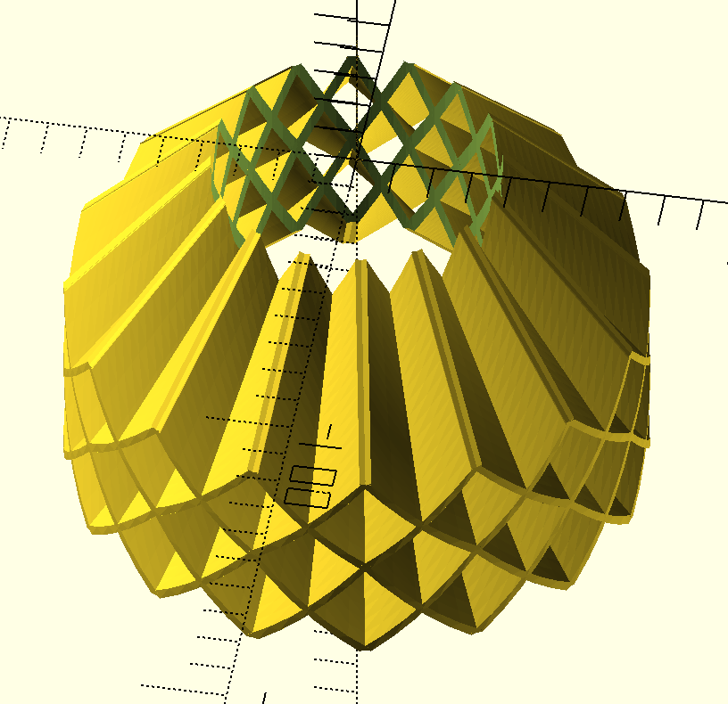

python code is here:
od=150
id=75
n=16
t=3
sl_ang=50
sl_h=(od/2-id/2)*tan(d2r(sl_ang))
a=c2t3(circle(od/2,s=n+1))
b=q_rot([f'z{360/len(a)/2}'],c2t3(circle(od/2,s=n+1)))
h=l_len(a[:2])/2
sol_1=[translate([0,0,ih],a) if i%2==0
else translate([0,0,i
h],b)
for i in range(5)]
a=flip(c2t3(circle(od/2,s=n+1)))
b=flip(q_rot([f'z{-360/len(a)/2}'],c2t3(circle(od/2,s=n+1))))
h=l_len(a[:2])/2
sol_2=[translate([0,0,ih],a) if i%2==0
h],b)
for i in range(5)]
a=c2t3(circle(id/2,s=n+1))
b=q_rot([f'z{360/len(a)/2}'],c2t3(circle(id/2,s=n+1)))
h=l_len(a[:2])/2
sol_3=[translate([0,0,ih],a) if i%2==0
h],b)
for i in range(5)]
a=flip(c2t3(circle(id/2,s=n+1)))
b=flip(q_rot([f'z{-360/len(a)/2}'],c2t3(circle(id/2,s=n+1))))
h=l_len(a[:2])/2
sol_4=[translate([0,0,ih],a) if i%2==0
h],b)
for i in range(5)]
a=[seg(p)[:-1] for p in cpo(sol_1)]
b=[seg(p)[:-1] for p in translate([0,0,sl_h],cpo(sol_3))]
sol_5=array([a,b]).transpose(1,2,0,3,4).tolist()
a=[seg(p)[:-1] for p in cpo(sol_2)]
b=[seg(p)[:-1] for p in translate([0,0,sl_h],cpo(sol_4))]
sol_6=array([a,b]).transpose(1,2,0,3,4).tolist()
f.write(f'''
include<dependencies2.scad>
for(p={sol_5})for(p1=p)
    let(
    a=slice_sol(p1,10)
    for(i=[1:len(a)-1])
hull(){{
p_line3d(a[i-1],{t/2},1);
p_line3d(a[i],{t/2},1);
    for(p={sol_6})for(p1=p)
    let(
    a=slice_sol(p1,10)
    for(i=[1:len(a)-1])
hull(){{
Apart from above you would need file dependencies2.scad, a library I have
written , which is a much smaller version of dependencies.scad
Also attached revised trial.scad

Here's my take on this in library-free OpenSCAD:
wall = 3;
cells_around = 16;
cells_down = 3;
down_ang = 50;
body_od = 150;
body_id = 75;
circ = body_od * PI;
cell_side = circ / cells_around / sqrt(2);
cell_l = (cells_down + 1) * cell_side;
cell_h = circ/cells_around;
module xflip_copy() {children(); mirror([1,0,0]) children();}
module zxskew(a) {multmatrix([[1,0,0,0],[0,1,0,0],[tan(a),0,1,0],[0,0,0,1]]) children();}
for (zi = [0:1:cells_down-2]) translate([0,0,cell_hzi]) {
xflip_copy() {
for (ri = [0:1:cells_around-1]) rotate(360
ri/cells_around) {
zxskew(-down_ang) {
linear_extrude(height=cell_h, center=true, twist=-360/cells_around, convexity=4) {
rotate(-180/cells_around) {
translate([body_od/4,0,0]) {
square([body_od/2,wall], center=true);
cylinder(d=body_id, h=10*cell_h, center=true);
