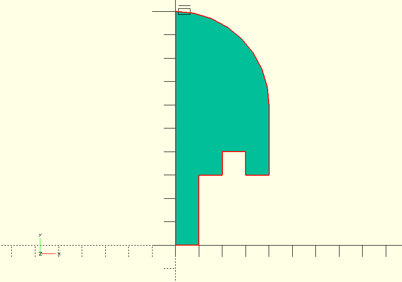

Hello,
i havesome trouble making a brim for a vessel with a complex cross section
profile. I stumbled upon the sweep function and scad utils with has some
other additional functions, but i dont really know what code to use.
Can you please tell me which package i have to get to use the sweep
function?

PYM
Tue, Jul 28, 2015 9:37 AM
Hello,
i cant post the vessel as code since i only have it as prototype model here.
I am fitting the Brim by measuring the vessel manually. However i made a
professional MS Paint drawing  describing the situation roughly so you can
maybe get the idea better.
Thanks for the reply, hope you can help me!
http://forum.openscad.org/file/n13328/Ellipsoid_Brim.jpg

N
Neon22
Tue, Jul 28, 2015 10:13 AM
You might consider a rotate_interpolate of a profile (the green shape) and
then scale the result more in Y than X.
E.g.
scale([x_scale,y_scale,1])
rotate_extrude($fn=Faceted)
polygon(profile);
Where profile is a list of xy points. [[x1,y1], [], ...]
You can make the path in inkscape and use "Paths to OpenSCAD"
Extension(plugin).
E.g. http://www.thingiverse.com/thing:923244/#instructions
I'm also reminded of this:
http://www.thingiverse.com/thing:116447
Which I think needs less code to do what its doing but is one way to do it.

PYM
Tue, Jul 28, 2015 11:39 AM
unfortunately rotate_extrude() followed by scale() will give me an uneven
brim Thickness. It will be wider in the scaled dimension and more narrow in
the shorter side of the ellipse, so it cant fit on the elliptic vessel which
has a constant wall thickness.

PF
Peter Falke
Tue, Jul 28, 2015 2:16 PM
Is this a good enough approximation for the cross section of the brim:
$fn = 32;
// vessel thickness = 4 (defined by the polygon in vessel())
vt=4;
// brim height
bh=10;
module vessel(){
polygon(
points=[[0,0],[1,0],[1,3],[2,3],[2,4],[3,4],[3,3],[4,3],[4,0],[4,-1],[0,-1]]
module brim_2d(){
translate([0,bh-vt,0])
circle(vt);
translate([-vt,0,0])square(2vt,true);
translate([0,-vt,0])square(2
vt,true);
square([vt,bh-vt]);
vessel();
brim_2d();

PYM
Wed, Jul 29, 2015 5:26 PM
@Peter
Yes it is a good approximation, but the opposite side points to the outside
of the vessel :)
View this message in context: http://forum.openscad.org/Please-help-with-path-extrusion-tp13322p13367.html
