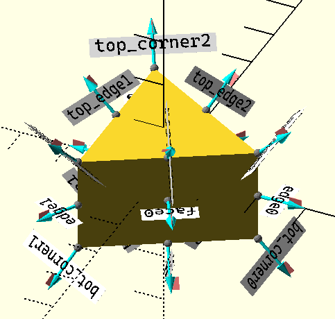

confusion is that setting anchor=LEFT causes the shape to move to the
right from its default centered position.
The anchor mechanism is not about moving the shape.  Rather, it
specifies where on the shape should be placed on the origin.
When you say anchor=LEFT, you are saying that the middle of the left
side of the shape should be put at the origin.  (It's the middle because
LEFT specifies only which point to use in the X axis, and the Y and Z
axes remain defaulted to centered.)
When you say to put the left side at the origin, yes, that moves the
shape to the right from its default centered position.
But if you think of it as where on the shape will be placed at the
origin, it makes sense.
When you say anchor=LEFT+FRONT+BOTTOM, you're saying that that corner
should be placed at the origin... which, for a cuboid, is the cube
default of putting the shape in the positive XYZ octant.

The "point on the shape" scheme is also required when you start playing
with shapes that have anchors other than the basic 27 anchors.  Consider
a triangular prism:
regular_prism(n=3, h=20, r=20) show_anchors(std=false);
Note the anchors:
Now let's position a cube at the far top corner, the one called
"top_corner2":
     position("top_corner2")
     cuboid(5);
