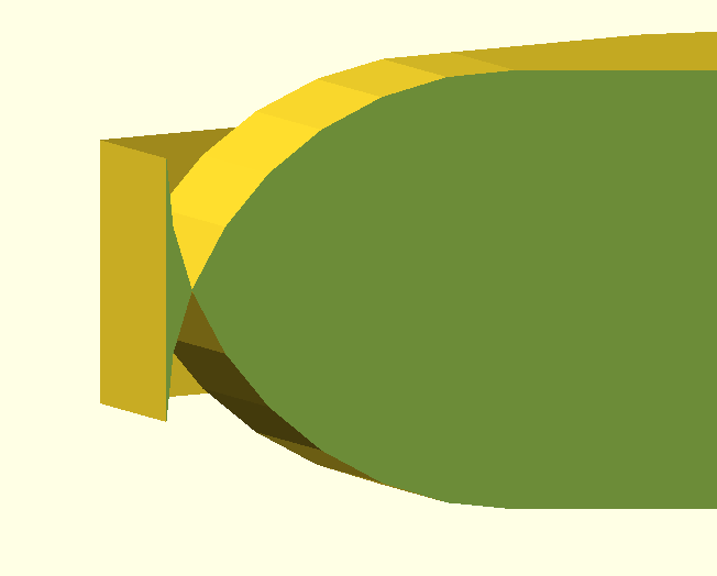

Hello OpenSCAD,
When I look at the F5 rendering of this I get exactly what I want.
F6 seems to have turned the difference inside out and with the cube in there for looking at cross sections (thank you to Roger Wolf) it gives an error on F6 but OK on F5.
Thank you for your help.  Yes, I am inconsistent with use of cylinder and cyl.  Just learning to use BOSL more.
Bob

Hi OpenSCAD,
Seems the culprit is the rounding on
cyl(d=Wh,h=H,rounding=2);  // main part of hat
I only wanted rounding on the top so I need to look up more about it on BOSL2
Bob

Hi Bob,
needed to say rounding1 instead of rounding.  BOSL2 is great!
Bob

I'm not sure what you were seeing about F5 and F6 disagreeing.  I get an
error from F6, and it's because the rounding is too big to fit and creates
a non-manifold self-intersecting shape.  This is actually a BOSL2 bug:  you
should get an error from BOSL2 that tells you your rounding is too big to
fit.

Thu, Nov 24, 2022 2:11 PM
Hi Adrian,
I tried to reproduce the error again.  I changed rounding1 to rounding and the F6 image came out as expected with the rounding at the bottom showing.
  That really should not be there so rounding1 is the answer. It is not too big for the that cylinder.
Adding the cutaway cube back in makes no difference.  It renders perfectly.  I don't get it.  I wish I had copied the original error, but what good is that if it can't be reproduced.
Bob

Thu, Nov 24, 2022 2:27 PM
The code I copied from your example had a cylinder with a height of T=2.5
and a rounding of 2.  This means round both ends with radius 2, which
doesn't fit in a total height of 2.5.  This is on the brim part of the
hat.  I don't know what you wanted to do, maybe a rounding of T/2?  But as
coded it does not fit and should be an error, and that is why F6 gives an
error.  Your picture is zoomed in so I'm not sure where it is in the
model, but somewhere else than the place I'm looking.
Bob
// top hat for earnest
// Bob Roos
// November 21, 2022
$fn = 36;
Wb = 100;
Wh = 60;
H = 45;
T = 2.5;
MH = 3;              // attachment hole for rubber band
union(){
translate([0,0,H/2])cyl(d=Wb,h=T,rounding=2);  // brim
translate([0,0,T])cylinder(d=Wh-2*T,h=H,center=true);  // remove
central part
 #translate([0,-(Wh+T)/2,(H)/2])cylinder(d=MH,h=T,center=true);  //
attachment hole
#rotate(9)translate([0,-(Wh+T)/2,(H)/2])cylinder(d=MH,h=T,center=true);
// attachment hole
#rotate(189)translate([0,-(Wh+T)/2,(H)/2])cylinder(d=MH,h=T,center=true);
// attachment hole
#rotate(180)translate([0,-(Wh+T)/2,(H)/2])cylinder(d=MH,h=T,center=true);
// attachment hole
translate([0,0,-H])cube([Wb,Wb,Wb]);  // examine cross sections

Hi Adrian,
You are correct it is somewhere else.  The line above the one you were looking at.
H = 45;
I changed that to rounding1=2.
Anyway, thank you to all for your help, I got the print I wanted and my grandson is delighted.
Bob
Bob
Thursday, November 24, 2022, 8:38:06 AM, you wrote:
I'm not sure what you were seeing about F5 and F6 disagreeing.  I get an error from F6, and it's because the rounding is too big to fit and creates a non-manifold self-intersecting shape.  This is actually a BOSL2 bug:  you should get an error from BOSL2 that tells you your rounding is too big to fit.
On Thu, Nov 24, 2022 at 6:11 AM Bob Roos roosbob@wybatap.com wrote:
Hi Bob,
Bob
Thursday, November 24, 2022, 5:43:01 AM, you wrote:
Hi OpenSCAD,
Bob
