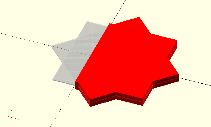

The following code may be a starting point to do what you want. For sake of
completeness I included a module ( boundingRect() ) that computes the
bounding rectangle of a 2D shape.
// the extent of the children projection on x axis
module xExtent()
hull() translate([0,1/2])
projection() rotate([90,0,0])
linear_extrude(1) children();
// the left extreme of the xExtent of children
module leftExtreme() difference() {
xExtent() children();
translate([1,0]) scale([1,1.1])xExtent() children();
// the lower left "point" of the children bounding rectangle
module lowerLeft() minkowski() {
leftExtreme() children(); // X
rotate(90) leftExtreme() rotate(-90) children(); // Y
// the positive part of the xExtent of children
module halfExtent(){
hull(){
translate([-1/2,0]) square(1,center=true);
lowerLeft() xExtent() children();
// a bounding rectangle of the part of children
// that has positive ordinate x
module halfBoundRect() offset(-1/2) minkowski() {
halfExtent() children();
rotate(-90) xExtent() rotate(90) children();
// the bounding rectangle of children
module boundingRect() offset(-1/2) minkowski() {
// a test shape
module shape() translate([2.5,0]){
rotate(0) square(10,center = true);
rotate(45) square(10,center = true);
%scale([1,1,0.1]) shape();
// the shape positive part
color("red")
intersection(){
shape();
halfBoundRect() shape();

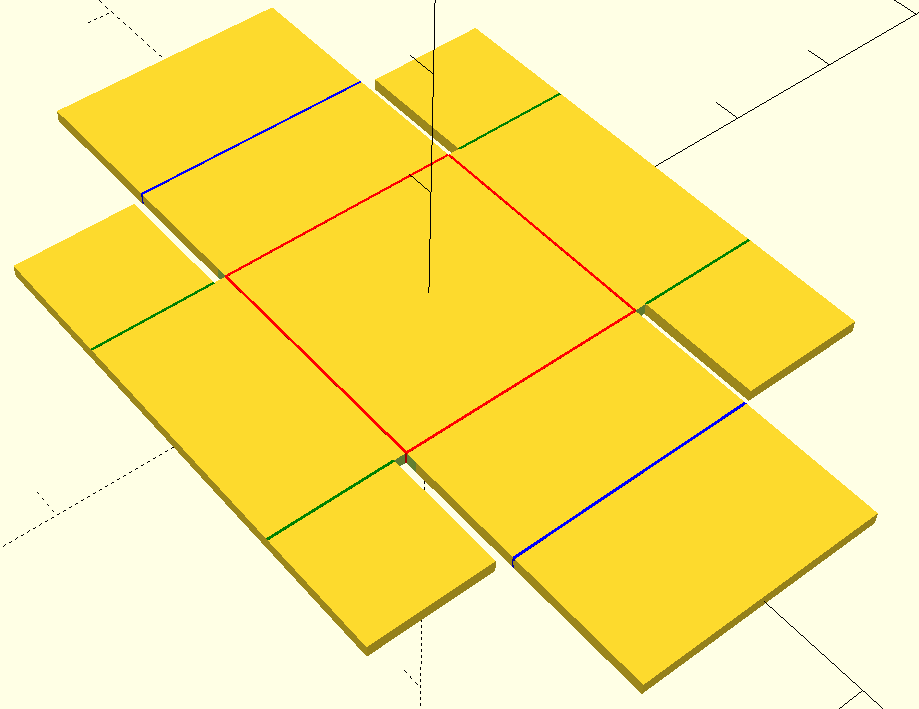

I have a reasonable idea of how I want to write most of the module - see
https://github.com/highfellow/openscad-sheet-folder . I am just stuck on
how to split a 2D object into two along a line. If anyone knows how to
do this that would be great; otherwise I'll have to use a less elegant
way of specifying which part of the shape to fold.
The code I have pasted below is an example of the kind of shape I want
to be able to fold. When folded along the red, green, and blue lines it
would make a simple cardboard box. (Although it really needs some tab
and slot retainers to stop it falling open again).
Cheers,
Andrew Baxter
----- code below ------
width=20;
height=10;
gap=1;
$delta=0.01;
for (x=[-1:2:1]) {
translate([x*(width/2+height+gap1.5),0,0])
square([height
2+gap+$delta,width], center=true);
for (y=[-1:2:1]) {
translate([0,y*(width/2+height/2+gap),0])
square([width2,height+$delta], center=true);
square(width + gap
2, center=true);
for (x=[-1:2:1], y=[-1:2:1]) {
translate([x*(width/2+gap/2),y*(width/2+gap/2),0])
square(gap+$delta, center=true);
color("red") translate([0,0,$delta]) {
for(x=[-1:2:1]) {
thinRect([xwidth/2,-width/2],[xwidth/2,width/2]);
for(y=[-1:2:1]) {
thinRect([-width/2,ywidth/2],[width/2,ywidth/2]);
color("green") translate([0,0,$delta]) {
for(x=[-1:2:1],y=[-1:2:1]) {
thinRect([xwidth/2,y(width/2+gap)],[xwidth/2,y(width/2+height+gap)]);
color("blue") translate([0,0,$delta]) {
for(x=[-1:2:1]) {
thinRect([x*(width+gap/2),-width/2],[x*(width+gap/2),width/2]);
module thinRect(start=[0,0],end=[1,1],width=0.2) {
diff=start-end;
length=sqrt(diff[0]diff[0]+diff[1]diff[1]);
normal=[diff[1],-diff[0]]/length;
polygon([start-normal
width/2,end-normal
width/2,end+normalwidth/2,start+normalwidth/2]);
