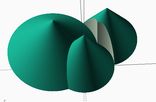

Assuming I have:
translate([4, 5, 0])
cylinder(d1=10, d2=0, h=10);
translate([-5, 3, 0])
cylinder(d1=15, d2=0, h=10);
The result is this:
http://forum.openscad.org/file/t2594/example_01.png
This is just a simple example. I need to be able to split this up into
chunks for 3d printing. (It's for an art project)
Right now, I'm doing 160x160 mm regions (via intersection with cube).
However, this leaves very very ugly inorganic seams.
I would like to be able to do basically "intersections between cones
extruded along z axis", for lack of a better term.
Where two of the cones intersect, I would like to be able to "cut straight
down" to the xy plane.
The result for this example would be three separate objects, that get
"cylinderified" at the points where they intersect.
Does this make sense? I can provide a pencil sketch if that would be helpful
also.
This must be possible, I just am not skilled enough with openscad to achieve
this.
My thought is perhaps create 2d profile shapes from the intersection of the
cones, projected to an xy plane at z = 0. Then extrude those above the cone
max heights. Finally, one by one, do intersections of those extruded
projections with each cone. I'm not exactly sure how to do this though.
(In addition, what is the name of the operation I am trying to accomplish
here?)
Thank you so much!!

That sounds about right, except you want to mix
a. difference() the extruded-projection from the outside cone(s).
b. intersection() the inner cone(s).
a.
http://forum.openscad.org/file/t359/Capture_cone_diff_a.jpg
Simple code:
module c1()  translate([4, 5, 0])
module c2()  cylinder(d1=10, d2=0, h=10);
module c3()  translate([-5, 3, 0])
c3();
linear_extrude(height=11)
projection() {
c3();
c1();
c1();
Make it more generic:
module diff_extr_proj() {
children(0);
projection() {
children(0);
children(1);
children(1);
diff_extr_proj() {
c3();
c1();
For b. just rearrange the above.

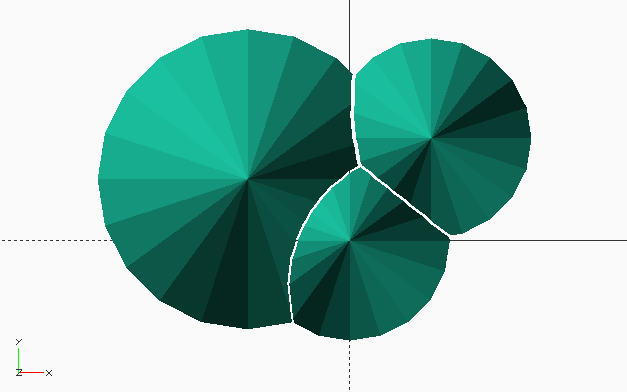

I think MIchael's code can be simplified by:
module cutCyl() {
children(0);
for(i=[1:1:$children-1])
linear_extrude(height=1000)
projection() children(i);
cutCyl() { c1(); c2(); c3();} };
However, the union of that last object with c2() and c3() does not seem to
be the intended split of the cone union.
[image: CutCones.PNG]
The problem as I see is that the line of intersection of two cones is in a
vertical plane just in the very specific case where both cone have same
height and base diameter. In those case, a vertical plane can "organically"
split the twp cones.
I think MIchael's code can be simplified by: module cutCyl() { difference() { children(0); for(i=[1:1:$children-1]) linear_extrude(height=1000) projection() children(i); } } cutCyl() { c1(); c2(); c3();} }; However, the union of that last object with c2() and c3() does not seem to be the intended split of the cone union. [image: CutCones.PNG] The problem as I see is that the line of intersection of two cones is in a vertical plane just in the very specific case where both cone have same height and base diameter. In those case, a vertical plane can "organically" split the twp cones.
Sat, Jul 6, 2019 2:20 AM
I think now I have understood guaranteed_interwoven's construction. Very
clever split.
$fn = 20;
t1 = [4, 5, 0];
t2 = [0, 0, 0];
t3 = [-5, 3, 0];
delta = 0.02;
module c1() translate(t1) cylinder(d1=10, d2=0, h=10);
module c2() translate(t2) cylinder(d1=10, d2=0, h=10);
module c3() translate(t3) cylinder(d1=15, d2=0, h=10);
module cutCyl()
children(0);
projection()
children(0);
for(i=[1:1:$children-1]) children(i);
translate(deltat1) cutCyl() { c1(); c2(); c3();}
translate(delta
t2) cutCyl() { c2(); c1(); c3();}
translate(delta*t3) cutCyl() { c3(); c1(); c2();}

You folks are my heroes :)
This last one is exactly what I needed! Especially with the delta in there,
that is very slick.
