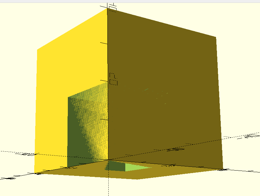

Ubuntu hard-dropped support for my graphics driver (NVIDIA). So as
we're now 4 years further, I was hoping the open source version
would've matured to the level to be usable.
I remember trying it 4 years ago, finding it unusable for some reason
and then switching to "nvidia" without any further problems....
Well now trying nouveau again... openscad shows the classic
Z-fighting that we all recognize when objects coincide.
e.g.
difference () {
cube (40);
cube (20);
but now for all planes. In the "z-fight.png" screenshot I've turned
the above so you can see a fully non-transparent (minus about 100
pixels) side, a fully shimmered side, and a half-open side.
At this orientation. I don't get the shimmering on the sides that
normally don't shimmer.
On this object, the "no shimmering expected" faces don't do it that
often. Only on very rare orientations. WIth my real model that I'm
working on, it is about about 50% of the faces that get hit on every
possible orientation.

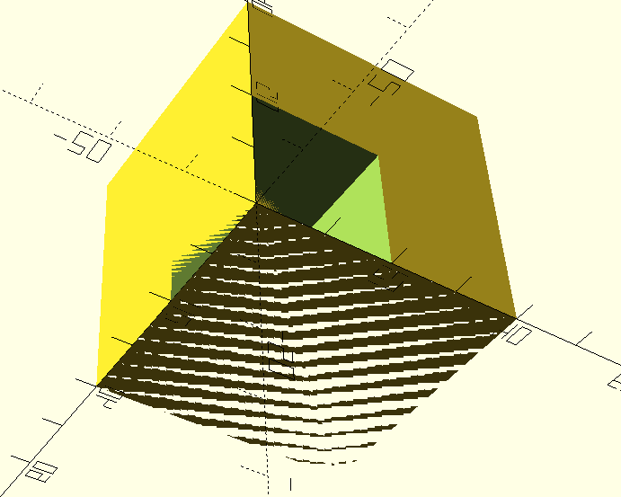

See z-fight2.png for where the whole bottom surface is partly
transparent.
With some back-and-forth with an AI, it seems that openscad is drawing
both the front and back faces of objects, with the back face making
the pixels transparent when they get drawn.
But they shouldn't be drawn because they need to be "deeper". This
Z-buffer offset is calculated at the corners of the triangles,
interpolated while the GPU iterates along the scanlines, and sometimes
the offset is not enough to cause the back-side to be "deeper" than
the front side.
Is this Z-offset trick fully driver-side so I should complain to the
nouveau guys, or is this a: "an offset of 1 guarantees it will be
deeper(*)" that is somehow a constant inside the openscad 3D code?
(*) That's wrong as soon as interpolation starts happening.

Tried it on my machine, and all looks as expected, z-fighting on 1/4 of
three faces.
I'm running Ubuntu 22.04.5 LTS MATE.
My graphics card:
Advanced Micro Devices, Inc. [AMD/ATI] Cezanne (rev c9)
No idea if that helps you, but only a few pixens were inconvenienced.

That second picture, where the entire bottom of the cube is messed up,
doesn't seem like it can be tied to the difference.  I'm not deeply
familiar with the previewer, but I don't think that a difference
generates any triangles that are "outside" the negative volume, and so I
don't think it can cause Z-fighting problems for the other 3/4 of that
face.
Random diagnostic thought:  perhaps we should have a way to dump the
list of triangles (and other parameters) that we're handing to OpenGL,
and a separate program that consumes that list and feeds it to OpenGL.
That would allow for exercising these cases with more repeatability and
precision, and giving OpenGL providers simple(r) test cases to look at.

Fri, Jun 12, 2026 6:27 PM
08-Feb-2026: OpenCSG 1.8.2 release with rendering fixes for Linux
with Nouveau driver
The new release fixes a z-fighting bug in the SCS algorithm, that was
known for a long time, under Linux with Nouveau graphics driver.
as we're now 4 years further, I was hoping the open source
version would've matured to the level to be usable. I remember
trying it 4 years ago, finding it unusable for some reason and
then switching to "nvidia" without any further problems.... Well
now trying nouveau again... openscad shows the classic Z-fighting
that we all recognize when objects coincide. e.g. difference () {
cube (40); cube (20); } but now for all planes. In the "z-
fight.png" screenshot I've turned the above so you can see a
fully non-transparent (minus about 100 pixels) side, a fully
shimmered side, and a half-open side. At this orientation. I
don't get the shimmering on the sides that normally don't
shimmer. On this object, the "no shimmering expected" faces don't
do it that often. Only on very rare orientations. WIth my real
model that I'm working on, it is about about 50% of the faces
that get hit on every possible orientation. See z-fight2.png for
where the whole bottom surface is partly transparent. With some
back-and-forth with an AI, it seems that openscad is drawing both
the pixels transparent when they get drawn. But they shouldn't be
drawn because they need to be "deeper". This Z-buffer offset is
calculated at the corners of the triangles, interpolated while
the GPU iterates along the scanlines, and sometimes the offset is
not enough to cause the back-side to be "deeper" than the front
side. Is this Z-offset trick fully driver-side so I should
complain to the nouveau guys, or is this a: "an offset of 1
guarantees it will be deeper()" that is somehow a constant
inside the openscad 3D code? Roger. (

 With changing the view angle, I can momentarily get the z fighting
over the whole base of the large cube, I can't get it on the whole large
sides, but  provided it is shown somewhere, that is a good thing. z
fighting is important, since. it shows the ambiguity in the design. The
f6 render 'papers over that ambiguity', f5 does not.
three faces.
My graphics card:
I'm an idiot, thinking it was only "nouveau" that mattered (that
what the thing that changed and made the difference).
Mine is:
01:00.0 VGA compatible controller: NVIDIA Corporation GK208B [GeForce GT 730] (rev a1)
Turns out my other workstation has:
01:00.0 VGA compatible controller: NVIDIA Corporation GF119 [GeForce GT 610] (rev a1)
and has been running openscad on Nouveau fine for years.
It's the GT730 that nouveau is not happy with.
