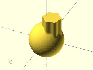

example attached where a fillet is created:
calculations for this are done in python.
[image: Screenshot 2023-07-22 at 9.41.49 PM.png]

example attached where a fillet is created: calculations for this are done in python. [image: Screenshot 2023-07-22 at 9.41.49 PM.png] On Sun, 23 Jul 2023 at 21:37, Sanjeev Prabhakar <sprabhakar2006@gmail.com> wrote: > In the past I have shared few examples which probably are very difficult > to do in pure openscad. > > Python is a very convenient, easy to learn and use language as per me. > > Is probably not more than 2 years that I started learning python. I > wouldn't call myself proficient in the language but at the least I could > make few very complicated models through this. > > > >
Sun, Jul 23, 2023 4:45 PM
That is great stuff, but in my view it would belong into the geometry
engine.
Maybe you can help with the calculation side of that?

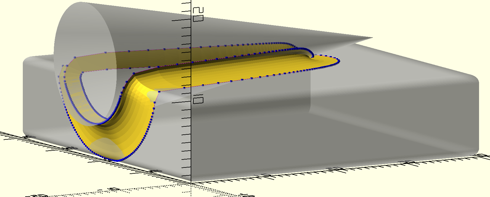

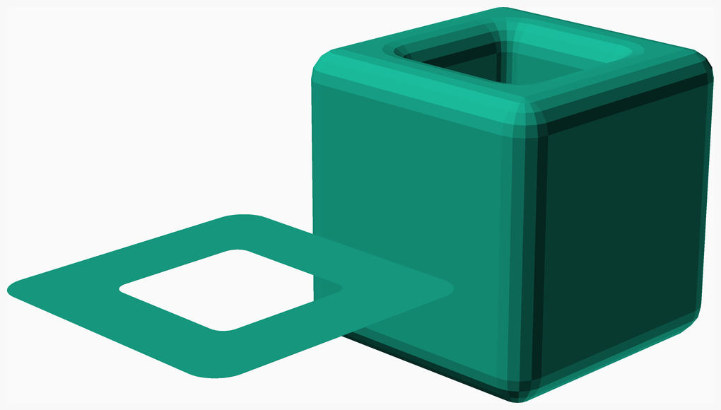

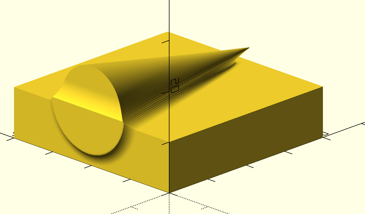

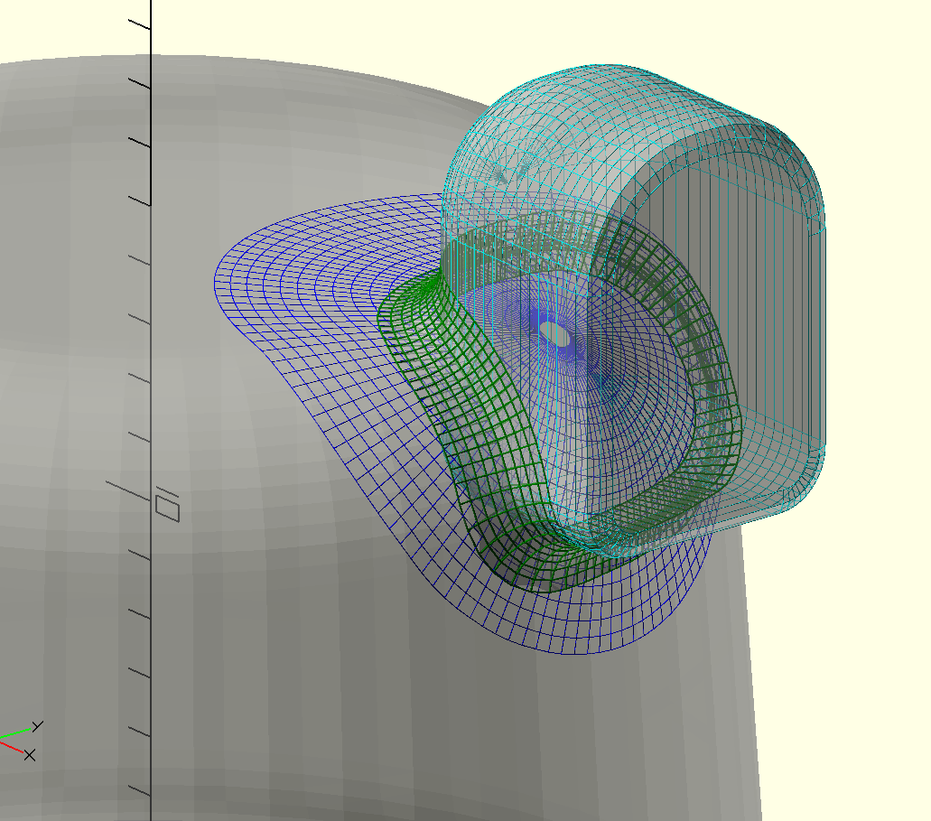

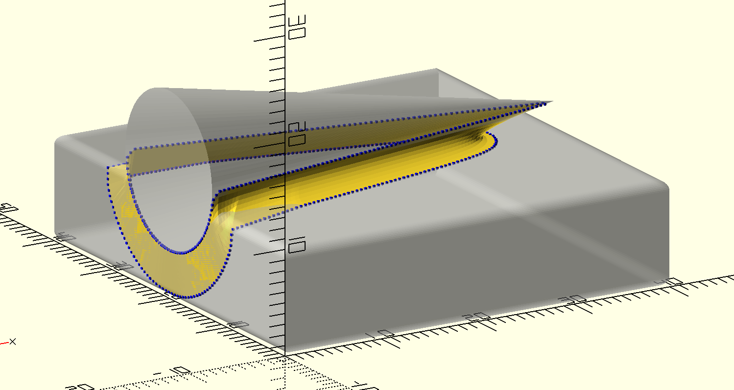

I've been working on BOSL2 for a while with Revar, and we have 60k lines of
OpenSCAD code.  Based on that experience, I think that the problem with the
OpenSCAD language is NOT fundamentally that it is functional.  The benefit
of python is NOT fundamentally that it is procedural.  There are two basic
problems with OpenSCAD for doing more complicated user space processing.
One is the inability to gain access to geometry, so to do user space
design, everything from the ground up has to be done "outside" of the
OpenSCAD geometry engine.  The second problem is about efficiency.
OpenSCAD has no data structures.  Graphics algorithms assume access to
sophisticated and efficient data structures like a priority queue or a tree
or other kinds of things that are impossible to implement efficiently in
OpenSCAD.  So, yeah, you can implement the data structure, but instead of
being O(log N) or whatever it will be O(N^2).  So then trying to implement
that process that uses that data structure in user space becomes
intractable.  It's not clear to me that this limitation is fundamentally
about the language being functional.
Note that the filleting process displayed by Sanjeev is straight forward to
implement in principle.  You just find the intersection of two things and
put a fillet there.  Two complications arise for doing this in userspace in
OpenSCAD.  The first is representing the things, because again, you can't
use the geometry engine to do it.  Now maybe a solution to that problem is
coming?  The second complication is dealing with self-intersections of the
resulting polyhedron, because that's intractable in OpenSCAD.  Really it
seems like OpenSCAD should have a primitive that accepts a series of
profiles and links them together into a polyhedron, even if it's
self-intersecting.
Here's examples of doing the fillet problem entirely in OpenSCAD
userspace.  There are many examples at the link below.  I show a single one
in this message.
https://github.com/BelfrySCAD/BOSL2/wiki/rounding.scad#functionmodule-join_prism
to implement in principle.  You just find the intersection of two things
and put a fillet there.  Two complications arise for doing this in
userspace in OpenSCAD.  The first is representing the things, because
again, you can't use the geometry engine to do it.  Now maybe a solution to
that problem is coming?  The second complication is dealing with
self-intersections of the resulting polyhedron, because that's intractable
in OpenSCAD.  Really it seems like OpenSCAD should have a primitive that
accepts a series of profiles and links them together into a polyhedron,
even if it's self-intersecting.
in this message.
forward to implement in principle.  You just find the intersection of two
things and put a fillet there.  Two complications arise for doing this in
in this message.

SureI will try to explain the logic maybe in a day or two for the benefit of all who maybe interested in geometry manipulations.
Mon, Jul 24, 2023 4:31 PM
please see the explanation.
Although it seems quite complicated, but it takes around 1 sec to compute
and display the results
I hope this helps

Thanks for your nice explanation of the algorithm.
But what happens if I try to fillet this with radius of about 5:
cube ([40,40,10]);
translate ([0,20,12]) rotate ([0,90,0]) cylinder (d1=15, d2=0, h=40);
At x=0... the intersection line is not a line, but a plane. Or the
curve is not closed as you expect.
Near x=0, there is probably no problem.
But as x increases... ehh actually, directly from the start: the
bezier will partially lie INSIDE the orginal object. This means that
if you take that curve instead of the original object you'll have
taken material AWAY from the object. That is something that you don't
want to happen with a fillet.Think of adding a fillet as adding putty
to the sharp corner between the objects. This only ADDS to the
objects, never subtracts.

The approach explained in my earlier message will not work in such cases. [image: Screenshot 2023-07-24 at 11.32.15 PM.png] On Mon, 24 Jul 2023 at 22:35, Rogier Wolff <R.E.Wolff@bitwizard.nl> wrote: > On Mon, Jul 24, 2023 at 10:01:22PM +0530, Sanjeev Prabhakar wrote: > > please see the explanation. > > Although it seems quite complicated, but it takes around 1 sec to compute > > and display the results > > I hope this helps > > Thanks for your nice explanation of the algorithm. > > But what happens if I try to fillet this with radius of about 5: > > cube ([40,40,10]); > translate ([0,20,12]) rotate ([0,90,0]) cylinder (d1=15, d2=0, h=40); > > ? > > At x=0... the intersection line is not a line, but a plane. Or the > curve is not closed as you expect. > > Near x=0, there is probably no problem. > > But as x increases... ehh actually, directly from the start: the > bezier will partially lie INSIDE the orginal object. This means that > if you take that curve instead of the original object you'll have > taken material AWAY from the object. That is something that you don't > want to happen with a fillet.Think of adding a fillet as adding putty > to the sharp corner between the objects. This only ADDS to the > objects, never subtracts. > > > > > Roger. > > > On Sun, 23 Jul 2023 at 22:43, Sanjeev Prabhakar < > sprabhakar2006@gmail.com> > > wrote: > > > > > Sure > > > I will try to explain the logic maybe in a day or two for the benefit > of > > > all who maybe interested in geometry manipulations. > > > > > > > > > > > > > > > > _______________________________________________ > > OpenSCAD mailing list > > To unsubscribe send an email to discuss-leave@lists.openscad.org > > > -- > ** R.E.Wolff@BitWizard.nl ** https://www.BitWizard.nl/ ** +31-15-2049110 > ** > ** Delftechpark 11 2628 XJ Delft, The Netherlands. KVK: 27239233 ** > f equals m times a. When your f is steady, and your m is going down > your a is going up. -- Chris Hadfield about flying up the space shuttle. > _______________________________________________ > OpenSCAD mailing list > To unsubscribe send an email to discuss-leave@lists.openscad.org >
Mon, Jul 24, 2023 7:05 PM
Thanks for the explanation, this is nicely visualized. I suppose
subdividing some of the surfaces might also be needed?
Are there solutions that are more general? For the experienced user
it's probably fine to give a couple of strategies and let them decide,
but for the casual user that could be difficult to select what to use
and when.
What do GUI CAD systems come up with for this example with the cone?

rather than exactly matching the cone base with the cube it can be offset
to get the 3 lines and then shave off the extra cone.
This could be one solution I can think off

Wed, Jul 26, 2023 1:05 AM
here is another approach for filleting such type of intersection, it was
suggested by someone earlier, I did some modification and it is super
efficient.
it took 0.4 sec to render.
But it works only for convex intersections.
fillet here is 5 mm
[image: Screenshot 2023-07-26 at 6.33.44 AM.png]

here is another approach for filleting such type of intersection, it was suggested by someone earlier, I did some modification and it is super efficient. it took 0.4 sec to render. But it works only for convex intersections. fillet here is 5 mm [image: Screenshot 2023-07-26 at 6.33.44 AM.png] On Tue, 25 Jul 2023 at 20:25, Sanjeev Prabhakar <sprabhakar2006@gmail.com> wrote: > I have not used minkowski method in openscad, maybe someone else can > comment > > On Tue, 25 Jul 2023 at 14:34, Rogier Wolff <R.E.Wolff@bitwizard.nl> wrote: > >> On Mon, Jul 24, 2023 at 11:36:35PM +0530, Sanjeev Prabhakar wrote: >> > The approach explained in my earlier message will not work in such >> cases. >> >> Isn't fillet about the same as: >> >> minkovski with a sphere of the fillet radius, Then invert, again >> minkovski with that sphere and then invert again. >> >> That would at least give a defined result for my "difficult case". >> >> Roger. >> >> -- >> ** R.E.Wolff@BitWizard.nl ** https://www.BitWizard.nl/ ** +31-15-2049110 >> ** >> ** Delftechpark 11 2628 XJ Delft, The Netherlands. KVK: 27239233 >> ** >> f equals m times a. When your f is steady, and your m is going down >> your a is going up. -- Chris Hadfield about flying up the space shuttle. >> _______________________________________________ >> OpenSCAD mailing list >> To unsubscribe send an email to discuss-leave@lists.openscad.org >> >
Wed, Jul 26, 2023 3:43 AM
super efficient.
On my machine...
F5: Total rendering time: 0:00:00.789
F6: Total rendering time: 0:00:00.290
Ubuntu MATE,
OpenSCAD version 2023.02.15.ai13654
fillet here is 5 mm
