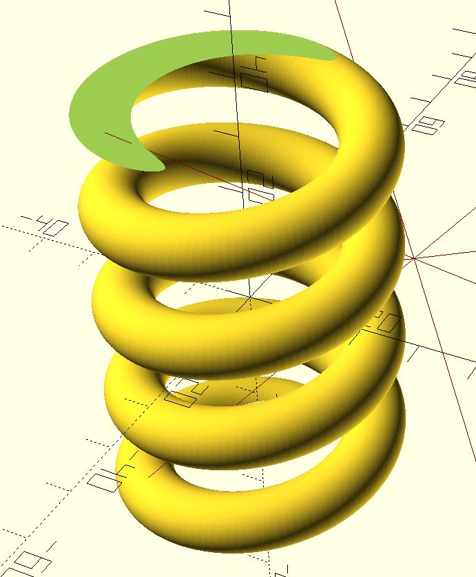

I am trying to create some threads with linear extrude. These are not standard size, I am trying to replace a broken part. They need to be placed at the right level around a hollow cylinder. So I need to have a code section that creates threads without anything else like a bolt or nut.
First one I made sort of works. The problem I have is when I extrude a circle it gets really thin in larger sizes. If I could extrude a sphere it would work great. I have tried rotate and other things but can't get it.
I suppose I should download a threads module but I didn't want to take the time to learn it. The images show nuts and bolts, not what I need. For an example think of a soda pop cap, that is close but I need external.

not entirely certain the shape you're aiming for, do you have a crude drawing or picture of the off-the-shelf version? On Sat, Dec 2, 2023, 22:08 Lee A via Discuss <discuss@lists.openscad.org> wrote: > I am trying to create some threads with linear extrude. These are not > standard size, I am trying to replace a broken part. They need to be placed > at the right level around a hollow cylinder. So I need to have a code > section that creates threads without anything else like a bolt or nut. > > First one I made sort of works. The problem I have is when I extrude a > circle it gets really thin in larger sizes. If I could extrude a sphere it > would work great. I have tried rotate and other things but can't get it. > > I suppose I should download a threads module but I didn't want to take the > time to learn it. The images show nuts and bolts, not what I need. For an > example think of a soda pop cap, that is close but I need external. > > Thanks > Lee > > > _______________________________________________ > OpenSCAD mailing list > To unsubscribe send an email to discuss-leave@lists.openscad.org >
LA
Lee A
Sun, Dec 3, 2023 5:37 AM
This is part of the bouncing spring on the cheat sheet. This is what I want except I want it round.

Is this any good to you Lee?
$fn = 128;
spiral_sweep(circle(5), h=90, r=20, turns=5);
translate([0,0,43])
cube([50,50,15],center=true);
translate([0,0,-43])

On 12/3/23 00:07, Lee A via Discuss wrote: > I am trying to create some threads with linear extrude. These are not > standard size, I am trying to replace a broken part. They need to be > placed at the right level around a hollow cylinder. So I need to have a > code section that creates threads without anything else like a bolt or nut. > > First one I made sort of works. The problem I have is when I extrude a > circle it gets really thin in larger sizes. If I could extrude a sphere > it would work great. I have tried rotate and other things but can't get it. > > I suppose I should download a threads module but I didn't want to take > the time to learn it. The images show nuts and bolts, not what I need. > For an example think of a soda pop cap, that is close but I need external. > > Thanks > Lee I needed a buttress thread so I made a small polygon describing the tooth , extruded it o be about a degree thick, tilted it just enough the steps in the thread pitch disappeared then looped it on the outside of a cylinder to make a bolt. then to actually make the parts, if its being used to difference() to make a nut, I make it a teeny bit bigger than the printer nozzle, or if making a bolt I reduce the size by the same amount. Easier to describe than do but that is the outline. The whole thing is around 45 mm in diameter but the shrink is only limited by the printers definition and nozzle size. This is not brittle PLA territory, but PETG, much more resilient. Take care and stay well Lee. Cheers, Gene Heskett. -- "There are four boxes to be used in defense of liberty: soap, ballot, jury, and ammo. Please use in that order." -Ed Howdershelt (Author, 1940) If we desire respect for the law, we must first make the law respectable. - Louis D. Brandeis
Sun, Dec 3, 2023 7:22 AM
Linear extrude with a twist seems like such an obvious way to make
threads or a helix... and it really doesn't work, if you want a round
cross-section.  It's possible to do, if you make a helix and slice it
and then extrude that slice, but that slice is hard to derive.  (It
looks sort of like a banana.)
Use a threads library.
https://github.com/BelfrySCAD/BOSL2/wiki/threading.scad
has a ton of technical details on how threads are designed, but the
examples are relatively simple.  Find an example that looks sort of like
what you want, and tweak it to your exact requirements.
The right sidebar lists a couple of specialized threading sub-libraries.

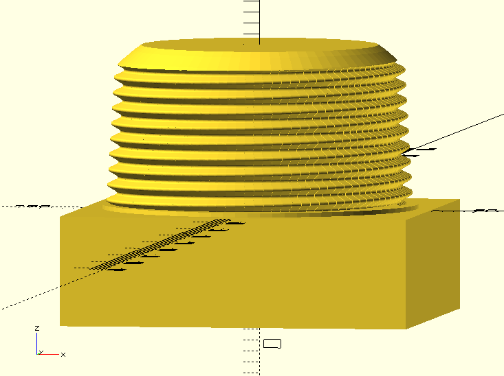

Hi Lee,
As others may or may not have said, a thread is a profile, which is
rotated and moved up or down a certain amount, usually an equal amount,
per rev, so to speak. A single  for loop can do that.
The profile can be generated by points on a polygon, or by combining
whatever shape you want, and it is linear extruded a small amount,
depending on what material and process you are using to create the
thread.  I then rotate that shape, and then rotate it and move
vertically in the desired direction and rate.It is easier to visualise
and create an external thread, and if you want internal threads, then
difference it from whatever object you want to be internally threaded.
Be aware of clearance, and the fact that many internal threads and
matching external thread do not have the same profiles.
I've attached the scad files that I  use. A Whitworth thread profile
example (whitprof.scad), and the file to generate a tapered plug. You
can adapt it to your needs if you wish. This tapered plug can take a
long time to process, but for a quick look, change the $fn value to
something smaller, However,  in the code attached, I've commented out
the lines that are not  not required so that a plain thread, with no
fancy ends is created.
Best wishes,
Ray
