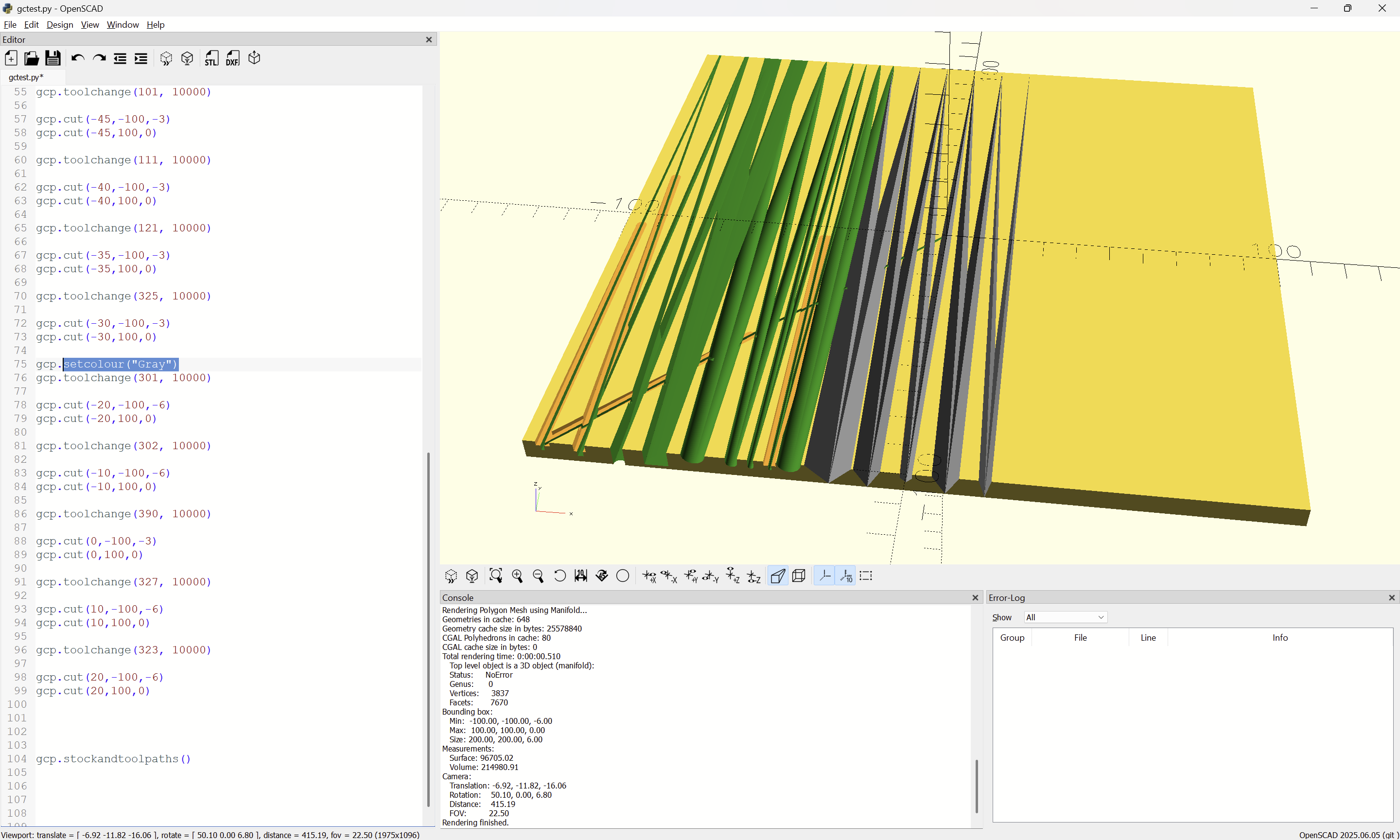

Did you check out
Its based on openscad and it can help you to display the gcodes
This runs in a couple of modes, and is fully programmatic (but that
should
be okay for folks on this list).
https://github.com/WillAdams/gcodepreview/blob/main/gcpdxf.py
is a basic Python file which will make a multi-colour DXF (uploaded a
converted SVG version --- let me know if you have trouble making the
DXF)
I'm currently deep into a rewrite which flattens out the (currently)
ever
deeply more nested CSG unions and incorporating better support for
colour
should dovetail well with that.
If someone would provide an example DXF file (where different colours
are
coded to different laser operations) and pseudocode for creating that
file,
I'll do my best to at least keep that in mind as I work on the re-write.

Okay, I added a command for changing colour:
setcolour("Gray")
(see attached screen grab)
One interesting complication/consideration is that there is a limited intersection in named colours betwixt OpenSCAD's support of the named Web Colors (see article on Wikipedia) and the basic numbered colours in the DXF format:
\item "Black" (0)
\item "Red" (1)
\item "Yellow" (2)
\item "Green" (3)
\item "Cyan" (4)
\item "Blue" (5)
\item "Magenta" (6)
\item "White" (7)
\item "Dark Gray" (8)
\item "Light Gray" (9)
with the common options being:
\item Black
\item Red
\item Yellow
\item Green
\item Blue
\item White
\item (Dark) Gray
Black and White aren't that useful/are potentially confusing since at least one program toggles them so as to make Dark Mode work, so we are down to red, yellow, green, blue, and (dark) gray --- can those be made to work for this?
