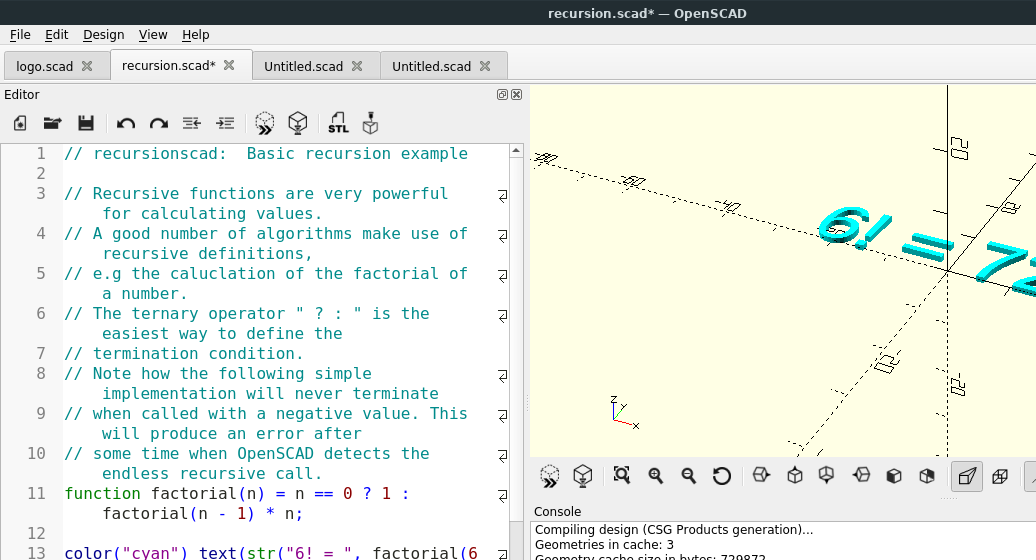

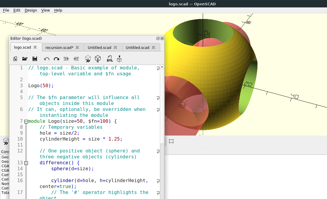

Greetings everyone,
I have been working to support the feature of multiple tabbed file editing
in OpenSCAD. This feature is now merged in master branch and the
corresponding snapshot(OpenSCAD-2019.07.28) for linux and windows can be
found at https://www.openscad.org/downloads.html. Snapshot for macos will
be available soon.
I hope users find this feature useful, and let me know of any suggestion or
bug. 😀
Here's a quick peek of the gui:
[image: imgg1.png]
[image: imgg2.png]
With regards,
Romit Kumar
