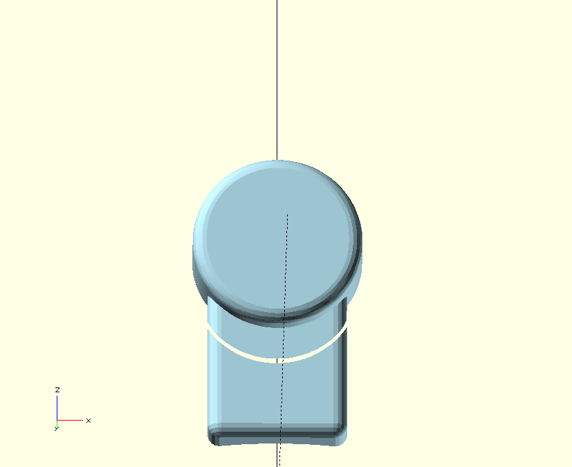

there was no definition for ContreAlesage() and alesage(). So I commented
this out.
Then I found that you drive "minkowski()", with $fn=120 which is pretty
much (regarding the extremely expensive algorithm). I got initially (on
macOS) a never ending spinning ball. I reduced it to $fn=20 and then it
(attached) worked like that:
[image: Bildschirmfoto 2021-10-28 um 10.34.27.png]

hello, I don't understand where is the mystake .
on my computer this file make an white circle ... the mystake is in
module "affichage"
My apologise for my porr english language.
for your information it's a design for ETX 125 telescope.

Thanks,  $fn=20; is good idea to have a speed vision..
if you get an screen, whithout visserie, vue générale, réparation  (
all= "N")
you can have a better view of mystake...
