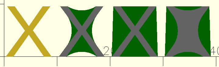

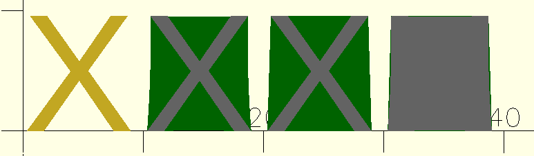

Mon, Sep 30, 2024 12:18 AM
On 9/29/2024 4:21 PM, Jesse Campbell via Discuss wrote:
The reason I use offset() instead of hull() is that offset() forms a
base that closely follows the shape of the input SVG.  Hull() sometimes
creates parts that are not in the input file.
I'd be interested to see examples of what you mean.
Now, to be clear, this is for offset that is large relative to the
object - as is the case here.  If the offset is similar in size to the
concavities in the object, it's a different picture.
Enclosed below please find a test program to examine the differences.
For a simple test case (an X), here's the results:
Left is the original object.
Next is the difference between the original and the offset scheme - gray
is in both the original and the result, green is new in the result, and
red (of which there isn't any) is removed.
Third is the difference between the original and the hull scheme.
Fourth is the difference between the offset scheme and the hull scheme.
(Gray is common, red is offset-only, green is hull-only.)
You'll notice that I set $fs and $fa.  Without those, the results for
the offset scheme are pretty ugly:
The results for the particular SVG have the two schemes almost
identical.  I won't include them here, because they're big if you want
to be able to see any differences, but you can experiment.
Those are with an offset of 100.  With an offset of 10, more around the
size of the concavities in the object, there's much more of a
difference.  With an offset of 5 (and the $fa/$fs settings):
