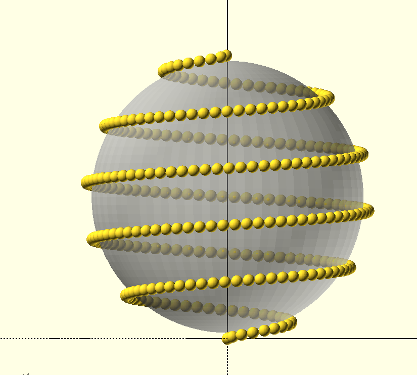

I would think in terms of defining a function that describes the spiral -
probably based on an Archimedean spiral
https://en.wikipedia.org/wiki/Archimedean_spiral - and then dividing
that path into N equal segments and placing a dot at each of those points.
To my eye, Archimedean spirals start to degenerate during the center loop,
violating the constant-distance-between-loops behavior that you see in the
rest of the spiral. I would cope with that by either skipping that loop,
or by placing the dots there "by hand".
I think that what's going on in the center is that you're normally looking
at the distance from one loop to the next, 360° further along the spiral,
but in that innermost loop there is no loop further in, and you're
looking at the distance from one point to another point that is closer than
360° away. Looking at the Wikipedia page, the most extreme case looks like
measuring from the center point to the first time the spiral crosses the +Y
axis. That's only a quarter of a loop-to-loop distance, which looks really
small... and that's that because it's only 90° away, not 360°.
Now, I say that like I know how to do those things. I don't. I don't
know what an Archimedean spiral mapped onto a sphere really looks like. I
suspect that it is phi = a + b*theta, but I'd have to plot that out to be
sure. I have no idea how to measure the length of that path and no idea
how to find a particular point given a distance along the path. (Well,
other than iteratively, but that's just wrong.)
BOSL2 implements this using the "Golden Spiral Method". You could use
that...or read the code.

If you already have the path, then you can use BOSL2’s path_copies() to get an equidistant spread of items along that path.

I wrote some code to create a spiral of spheres around the surface of a larger sphere. It works fine, but the spacing is too tight near the poles.
If I were writing in a "normal" language, I would calculate the position of each possible new sphere, then calculate the distance from that sphere to the most recently successfully placed sphere, and avoid placing the new one if the distance was too small. But I am writing in OpenSCAD, so that approach will not work; at least, I don't know how to do this in OpenSCAD.
Any thoughts?
function x(r, theta, rho) = r * sin(theta) * cos(rho);
function y(r, theta, rho) = r * sin(theta) * sin(rho);
function z(r, theta, rho) = r * cos(theta);
sphereD = 5;
numRots = 7;
numSpheres = numRots * 360;
r = 100;
for (rho = [0:5:numSpheres])
let (theta = (180 * (rho / numSpheres)))
translate([x(r, theta, rho), y(r, theta, rho), z(r, theta, rho)])
sphere(d = sphereD);

I assumed that he really wants a nice result on the sphere. The
path_copies() module implements something like what nophead
suggested----his suggestion, by the way, is really kind of nontrivial to
implement.

Wed, Mar 1, 2023 4:42 PM
is this what you were trying to do?
[image: Screenshot 2023-03-01 at 10.00.00 PM.png]
I did this with a slightly different approach.
steps:
- created a normal helix
- connected all helix points with the center line z-axis, so that all the
lines are parallel to x-y plane
- found intersection of the lines with sphere. This gives the helical path
along the sphere surface
- Divided the path in equally spaced points.
- translated spheres with diameter equal to the length between each point
steps:
1. created a normal helix
2. connected all helix points with the center line z-axis, so that all the
3. found intersection of the lines with sphere. This gives the helical path
4. Divided the path in equally spaced points.
5. translated spheres with diameter equal to the length between each point

Yes, Sanjeev, that was my objective. Basically a single line of
additional code using BOSL2
steps:
the lines are parallel to x-y plane
path along the sphere surface
On Wed, 1 Mar 2023 at 04:49, jon jon@jonbondy.com wrote:
Yes. Updated the library, and the path_copies() approach worked
perfectly!
> steps:
> perfectly!
> I love that BOSL2 library!
