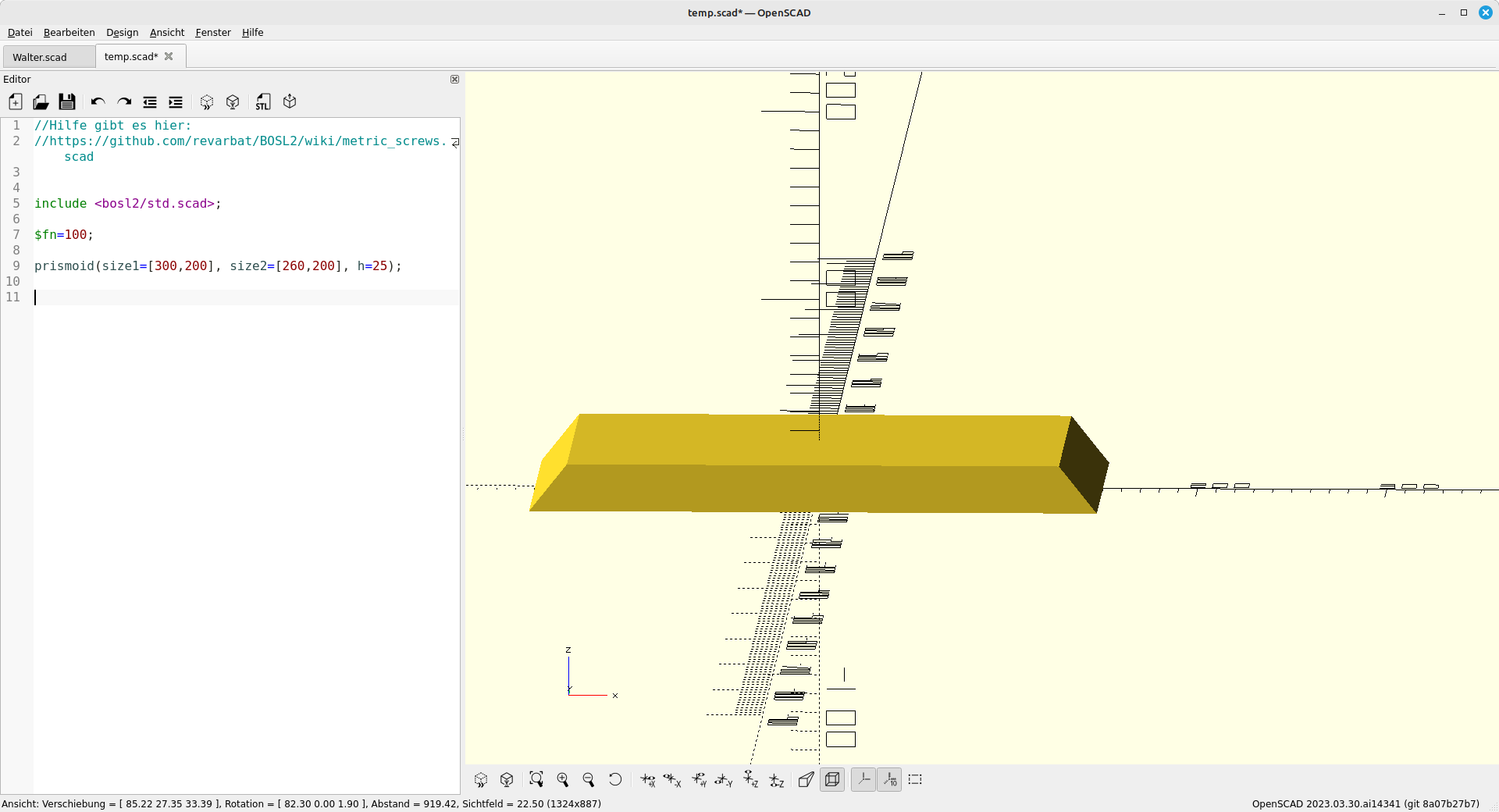

Dear all,
more and more I am flirting with a CNC milling machine. But am I right,
that a piece of wood like in the attachment cannot be printed with a 3
axis machine?
thanks
Karl
Dear all, more and more I am flirting with a CNC milling machine. But am I right, that a piece of wood like in the attachment cannot be printed with a 3 axis machine? thanks Karl

I believe it can: no overhangs.

Sure it can. One thing I do though is put a translate() in front of the
make it call that puts it at the center of the printers bed, and the
bottom at exactly bed height.  I use Cura for a slicer, and its auto
placement of .stl's or .3mf's is not always what you want. And sometimes
also a rotate 45 on Z if the bed is too small for straight across.
Depending on your slicer that might not be needed.

Yes, of course this could be cut --- it would be trivial if you have a V tool which matches the desired angle.
If you wished to do it as 3D, then you would export the STL from OpenSCAD and then use a 3D CAM tool such as Kiri:Moto --- note that this would require cutting deeper than the bottom of the stock by the radius of the tool used.
If you're willing to use Python in OpenSCAD:
http://www.guenther-sohler.net/openscad/
then you may find my project, gcodepreview of interest:
which is all about how to model 3D parts as if they were cut out using a CNC --- while it can directly output G-code, that (and to be honest the entire project) is still quite primitive with limitations such as not having loops set up for iteratively cutting down and setting Depth Per Pass on a per cut basis.
What sort of projects do you wish to do?

In which case it can be done, either by actually converting the slicer
output to run on the mill, Or writing your own gcode, which I would but
my choice of milling cutter would be a round nose, which would also cut
into a sacrificial board under it.
But why bother, you could do this on just about any table or chop saw in
well under 10 minutes. And probably cleaner. And that includes selecting
the scrap off the pile under the chop saw table and marking it up for
the cuts. I can do it either way, but writing the gcode would take at
least a week.  A 4 or 5 axis machine would greatly simplify the gcode.
Both of my mills are 4 axis.
