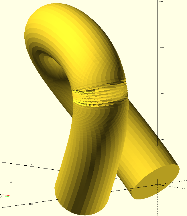

I am unclear why this code results in a pristine cylindrical extrusion
EXCEPT for one small place where it seems to twist frantically...
include <sweep.scad>
function f(a) = [18sin(360a), 18-18cos(360a0.7), 36sin(360*a/2)];
function shape(d) = let (dd = 5 * (1.2 - d/steps))
    [for (i=[1:10:360]) [ddsin(i), ddcos(i)]];
step = 0.005;
steps = 1/step;
path = [for (t=[step:step:1-step]) f(t)];
path_transforms = construct_transform_path(path);
sweep(shape(1), path_transforms);

@jon The original sweep.scad may show wild twists when the path gets a
vertical (along z) step. This is discussed in
http://forum.openscad.org/Twisty-problem-with-scad-utils-quot-sweep-quot-tc9775.html.
There you will find also change suggestions to overcome that behavior. I
have implemented those suggestions in a fork of sweep.scad and the results
are far better. You may find my fork in
https://github.com/RonaldoCMP/list-comprehension-demos.

Thank you for recalling the thread so clearly!  Very helpful.  I did
notice more than one "sweep.scad" on my computer, but was not able to
recall why I should use one over the other.
