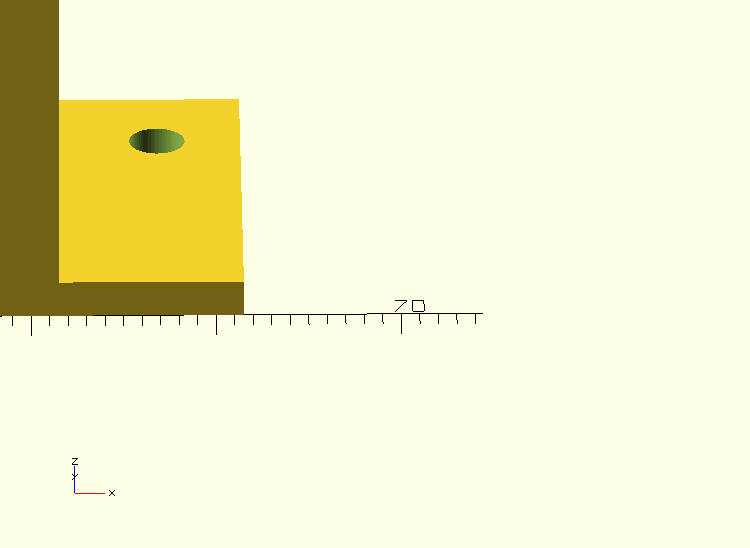

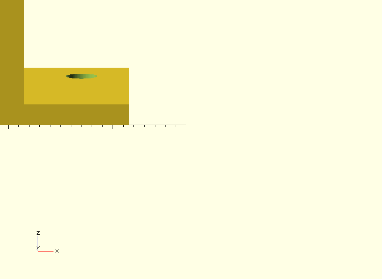

My screenshot shows an example of a problem I frequently encounter. When I want
to visually check some distance and select Right or Left, Orthogonal views, the
Axes and Scale Markers are not displayed. Presumably because they are being
'viewed' head on. Is there any no-brainer work around please?
Image attached or here:
https://www.dropbox.com/s/7rkt7jgmjahcxc1/MissingScale.jpg?raw=1

You could model in your own ruler.  Use % so that it's not part of the
final model.

My no-brainer workaround is to left-click and rotate the view slightly.

I can't get any such small rotation to display a readable scale. Could you show
me a screenshot please?
Code attached, or here:
https://www.dropbox.com/s/ohatuqot75zz8dp/TrayForCanon-HobbyServoMount-Minimal.scad?raw=1

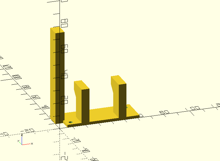

I see your particular object is positioned in such a way as to make it
difficult to use the scale markers at all, except for the Y markers,
and that, only for the tall vertical piece. All other parts are not
near any of the scale markers.
Sorry, but when I said it was easy, I was assuming that the object
would have several parts of interest at the origin lines, and that you
wanted to find measurements of an STL that you had not coded yourself.
So what I did, to place things next to scale markers:
Exported the object as an STL
ran a python script called stlplace on the STL, available at
https://github.com/lar3ry/OpenSCAD---Move-STL-to-origin/blob/master/stlplace.py
This will give you translate() statements to position the object at
various places:
Positions: NE, NW, SW, SE, Centre XY, Centre All
Making it a lot easier to see the markers.
I then copied the NE translate, and added lines at the beginning and
end of your code:
translate([ 6.0 , -10.0 , -0.0 ]) {
<your code>
See the attached for a picture.
From there, simply use one of the other positions from stlplace or
adjust the translate to bring objects of interest into the appropriate
place.
Once you have something against the appropriate markers, it's easy to
see.
One caveat; if you zoom in, at some point, the scale markers will not
be numbered unless thay are multiples of 10, but you can look at the
bigger picture before zooming.
A mmore accurate way is to create an object and place it over the part
you want to measure, and adjust it so it creates 'Z-fighting". Use the
for the object.

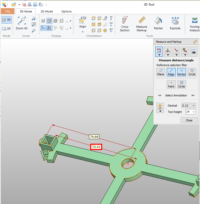

In theory you do not need to measure or eyeball things, you know from the
code you wrote where you placed it.
In practice, you want to make sure your code is correct, and does what was
intended.
I am no exception. After I code the translate, rotate, sin(dist), a>b?1:0
and so on - was my thinking correct? My tool for measuring is to export the
STL and use an STL viewer, which has the facility to measure the
distance (and angle or radius) between any points, lines or surfaces ->
www.3d-tool.de (use the free version). It does slow down the loop: code,
render, export STL, import, do measurement, and then go back and iterate,
but that is my encouragement to think more and experiment less :-)
(Sorry, the original OpenSCAD code has aged out of my mailwastebaset, but
here is a screenshot of something similar with a measurement
Note it has "found" the centre of the circle even though it is in midair.)
various places:
end of your code:
<your code>
place.
see.
for the object.
In theory you do not need to measure or eyeball things, you know from the code you wrote where you placed it. In practice, you want to make sure your code is correct, and does what was intended. I am no exception. After I code the translate, rotate, sin(dist), a>b?1:0 and so on - was my thinking correct? My tool for measuring is to export the STL and use an STL viewer, which has the facility to measure the distance (and angle or radius) between any points, lines or surfaces -> www.3d-tool.de (use the free version). It does slow down the loop: code, render, export STL, import, do measurement, and then go back and iterate, but that is my encouragement to think more and experiment less :-) (Sorry, the original OpenSCAD code has aged out of my mailwastebaset, but here is a screenshot of something similar with a measurement [image: image.png] Note it has "found" the centre of the circle even though it is in midair.) On Wed, 20 Oct 2021 at 19:53, larry <lar3ry@sasktel.net> wrote: > On Wed, 2021-10-20 at 09:27 +0100, Terry wrote: > > On Mon, 18 Oct 2021 13:22:24 -0600, you wrote: > > > My no-brainer workaround is to left-click and rotate the view > > > slightly. > > > I can't get any such small rotation to display a readable scale. > > Could you show > > me a screenshot please? > > I see your particular object is positioned in such a way as to make it > difficult to use the scale markers at all, except for the Y markers, > and that, only for the tall vertical piece. All other parts are not > near any of the scale markers. > > Sorry, but when I said it was easy, I was assuming that the object > would have several parts of interest at the origin lines, and that you > wanted to find measurements of an STL that you had not coded yourself. > > So what I did, to place things next to scale markers: > > Exported the object as an STL > ran a python script called stlplace on the STL, available at > > https://github.com/lar3ry/OpenSCAD---Move-STL-to-origin/blob/master/stlplace.py > > This will give you translate() statements to position the object at > various places: > Positions: NE, NW, SW, SE, Centre XY, Centre All > > Making it a lot easier to see the markers. > > I then copied the NE translate, and added lines at the beginning and > end of your code: > > translate([ 6.0 , -10.0 , -0.0 ]) { > <your code> > } > > See the attached for a picture. > > From there, simply use one of the other positions from stlplace or > adjust the translate to bring objects of interest into the appropriate > place. > > Once you have something against the appropriate markers, it's easy to > see. > > One caveat; if you zoom in, at some point, the scale markers will not > be numbered unless thay are multiples of 10, but you can look at the > bigger picture before zooming. > > A mmore accurate way is to create an object and place it over the part > you want to measure, and adjust it so it creates 'Z-fighting". Use the > # for the object. > > _______________________________________________ > OpenSCAD mailing list > To unsubscribe send an email to discuss-leave@lists.openscad.org >
