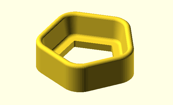

Did I start right? (or is it better to start with a block and remove
unwanted material?)
Is it difficult to build a shape and make it follow a curve (eg Bezzier)
If I understand correctly, the operation you require (to define a solid by
moving a 2d profile along a path) is usually called sweep (or loft). That
is not a native operation in OpenSCAD. If the profile is made of just
horizontal and vertical edges, the sweep could be produced by
union/difference of linear_extrude(s). In more general cases, sweep is done
by constructing a polyhedron(). There are many implementations of sweep.
Here is an example of using BOSL2 module path_sweep() to get a wall similar
to yours contouring a rounded pentagon. A more complex path even using
Bezier could be done. However, you should take into account that sweep
requires that both the profile (or section) and the path be lists of points
so you cannot build your wall as a module as you did. In my code, the
boolean operations of polygons to produce the wall section shape were done
using the BOLS2 concept of region and its operations.
verts = pentagon(30,rounding=11,$fn=66);
path = path3d(reverse(verts));
section = wall();
path_sweep( section, path, closed=true);

Hi!
Background .:
( I'm trying to learn openSCAD)
Had intended to build a protective box for a position light to be placed
on a trailer.
Instead of drawing a "boring" square box, I thought it would follow the
shape of the lamp. (which requires rounded shapes)
I have built a 2D model of the wall.
It has a straight outside and a sloping inside.
(and looks a bit like an "L") Later I thought to supplement with a bottom.
My desire .:
unwanted material?)
Below I have made a "shape" and two examples of "curves" to follow.
A "shape" of the wall  to the box .: (excuse comments in Swedish)

First thought to build the wall in the following way (but did not get the
right structure)
Now this is only teslines as the wall above maybe can follow? (if possible)
