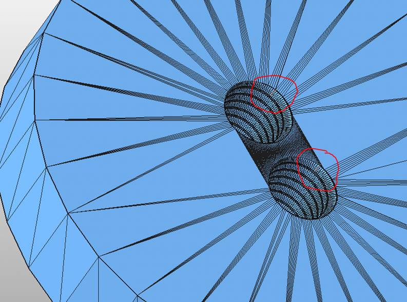

hello i
use a library to generate threads.
in the OpenSCAD 3D-Window it locks OK and in Prusa slicer 2.3.0 as well
After sicing the the body and the Threaded holes got invertet so that there
are an array of threaded bolts and not a body of threaded holes.
when set the number of holes to one, the thing got sliced proberly.
Any number bigger than one resultes in an faulty sliced objekt.
any ideas?
the library i am using is https://github.com/adrianschlatter/threadlib
and the OpenSCAD version is 2021.01.03 on snapcraft.
gretings

The Variables anz_x and anz_y determine the amount of threaded holes
one each will result in a Single threaded hole that will do fine on slicing
More will cause problems.
I also tested to generate two threads by using translate(){} two times whit
same result.
I tested whit ordinary cylinders that will work like a charm.
I am courious whats wrong.
dosen't make sense.
I think the source is the library.
greetings. R

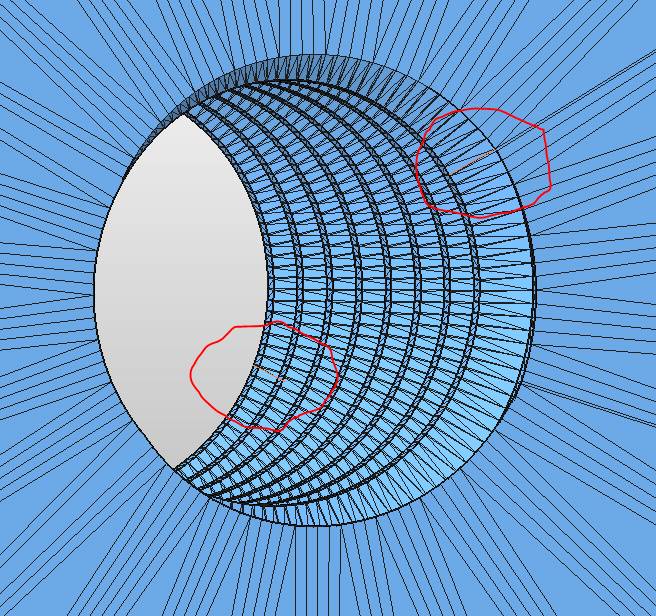

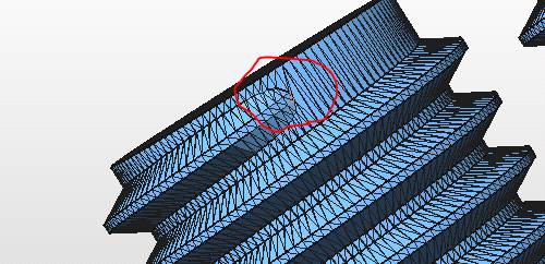

Unfortunately it looks like threadlib had degenerate faces in the bolt.
and also on the other end.
With 2019.05 your model gets a CGAL error.
With 2021.01.03 it doesn't, but the export has degenerate faces.
and also on the other side.

Unfortunately it looks like threadlib had degenerate faces in the bolt. and also on the other end. With 2019.05 your model gets a CGAL error. With 2021.01.03 it doesn't, but the export has degenerate faces. and also on the other side. > -----Original Message----- > From: Discuss [mailto:discuss-bounces@lists.openscad.org] On Behalf Of RajHid > Sent: Wed, 6 Jan 2021 09:37 > To: discuss@lists.openscad.org > Subject: Re: [OpenSCAD] faulty threads after slicing > > The Variables anz_x and anz_y determine the amount of threaded holes > one each will result in a Single threaded hole that will do fine on slicing > More will cause problems. > > I also tested to generate two threads by using translate(){} two times whit > same result. > I tested whit ordinary cylinders that will work like a charm. > > I am courious whats wrong. > dosen't make sense. > I think the source is the library. > > greetings. R > > > /* > Generates an Disc shaped insert for a metal box to stor 3D-Printer Nozzles > */ > > // ================================== > // = Used Libraries = > // ================================== > // Used Librareis and usage > // == Threads == > > use <threadlib/threadlib.scad> > // LINK: > //// https://github.com/adrianschlatter/threadlib > // USAGE: > //// bolt("M6", turns=10, higbee_arc=30); > //// tap , bolt, nut > > //m6(); > > module m6(){ > union(){ > difference(){ > cylinder(h=5,d1=25,d2=25, $fn=4); > bolt("M6", turns=6, higbee_arc=30); // tap , bolt, nut > translate([12.5,0,5]){ > //cube([25,25,10],center=true); > } > } > } > } > > > // ================================== > // = Variables = > // ================================== > > // == Disc insert == > > Diameter=51.2; // Disc diameter > Height=10; // Disc Height > > anz_x=2; // count of x holes > anz_y=2; // count of y holes > Stepping=1.5; // amont of distance between holes in hole > diameter > > // === 1 === > > > // === Nozzle === > NozzleThread=6; // Tread Major diameter > NozzlHex_h=3; // Height of hex section > NozzlHex_d=8; // Diameter of hex section > NozzlCone_h=2; // height of the end Cone > NozzlConeBase_d=4.00; // Diameter at base of Cone > NozzlConeTip_d=1.00; // Diameter at tip of Cone > NozzlFilam_d=2; // inner Nozzle diemeter > NozzlFilam_h=10; // lenght of the bore for the filament > NozzlNozzl_d=0.4; // Nozzle diameter for printing > NozzlTreadSection_h=7.50; // Length of the thread section > NozzlTreadSection_minor_d=4.75; // Tread Core Diameter > > NozzlInnerCone_h=2; // > NozzlInnerCone_d=NozzlFilam_d; > > // === 3 === > > // == Positioning Variables == > > // == Dependant Variables == > > > > // === Facettes Numbers === > // - $fn Values for Cylinders and Spheres > > FN_HexNut=6; > FN_Rough=12; > FN_Medium=36; > FN_Fine=72; > > FN_M8=8.00; > > > // == Calculated Variables > > // === 1 === > > // === 2 === > > // === 3 === > > // ================================== > // = Tuning Variables = > // ================================== > // Variables for finetuning (The Slegehammer if something has to be made > fit) > > tune_ScaleThread=0; // widens the M6 Thread of the Nozzle thread > for easy fitting > > // ================================== > // = Test Stage = > // ================================== > > //Holes(); > > // == See me == > // For Testing and Development > > see_me_half(); // for debugging and stuff > module see_me_half(){ > difference(){ > union(){ > Disc_Insert(); > translate([0,0,0]){ > //Nozzle_Template(); > } > } > translate([5,5,0]){ > cube([20,20,50]); // Cutting Cube > } > > } > } > > > // == Cutting == > > // ================================== > // = > // ================================== > > // ================================== > // = Stage = > // ================================== > // Final module for Produktion > > > // > =============================================================================== > // =--------------------------------- Modules > -----------------------------------= > // > =============================================================================== > > module Disc_Insert(){ > difference(){ > cylinder(h=Height,d1=Diameter, d2=Diameter); > translate([ -NozzleThread*Stepping*anz_x/2+NozzleThread*Stepping/2, > -NozzleThread*Stepping*anz_y/2+NozzleThread*Stepping/2, > 0 ]){ > //debug_Holes(); > Holes(); > } > } > } > module Nozzle_Template(){ // a Template of a Nozzle > difference(){ > union(){ > bolt("M6", turns=6, higbee_arc=30); > translate( [0,0,0]){ cylinder( > h=NozzlTreadSection_h, > d1=NozzlTreadSection_minor_d, > d2=NozzlTreadSection_minor_d, > $fn=FN_Fine); > translate( [0,0,NozzlTreadSection_h]){ cylinder( > h=NozzlHex_h, > d1=NozzlHex_d, > d2=NozzlHex_d, > $fn=FN_HexNut); > translate( [0,0,NozzlHex_h]){ cylinder( > h=NozzlCone_h, > d1=NozzlConeBase_d, > d2=NozzlConeTip_d, > $fn=FN_Fine); > } > } > } > } > translate([0,0,NozzlFilam_h+NozzlInnerCone_h]){ > > #cylinder(h=NozzlInnerCone_h,d1=NozzlNozzl_d,d2=NozzlNozzl_d,$fn=FN_Fine); > translate([0,0,0]){ > > //cylinder(h=NozzlFilam_h,d1=NozzlFilam_d,d2=NozzlFilam_d,$fn=FN_Fine); > } > } > translate([0,0,NozzlFilam_h]){ > > #cylinder(h=NozzlInnerCone_h,d1=NozzlFilam_d,d2=NozzlNozzl_d,$fn=FN_Fine); > } > translate([0,0,0]){ > > #cylinder(h=NozzlFilam_h,d1=NozzlFilam_d,d2=NozzlFilam_d,$fn=FN_Fine); > } > translate([0,0,-0.5]){ > cube([10,10,1],center=true); > } > } > } > > // > =============================================================================== > // ---------------------------------- Cutting Modules > ---------------------------- > // > =============================================================================== > > > > //Holes(); > > module debug_Holes(){ // generates two holes whitout using a loop > translate([0,20,0]){ > Thread_Nozzle(); > } > translate([0,-20,0]){ > Thread_Nozzle(); > } > > } > module Holes(){ // generates an array of anz_x times anz_y > objekts > difference(){ > union(){ > for(j=[0:1:anz_y-1]){ > for(i=[0:1:anz_x-1]){ > translate([ NozzleThread*Stepping*i, > 0, > 0 ]){ > //echo(i); > translate([ 0, > NozzleThread*Stepping*j, > 0 ]){ > > //cylinder(h=12,d1=NozzleThread,d2=NozzleThread); > > scale([ 1+tune_ScaleThread, > 1+tune_ScaleThread, > 1 ]){ > translate([0,0,Height]){ > > cylinder(h=Height,d1=NozzleThread*1.2,d2=NozzleThread*1.2,center=true,$fn=FN_Fine); > } > //bolt("M6", turns=15, higbee_arc=30); > Thread_Nozzle(); > } > } > }//NozzleThread*Stepping:Stepping*anz > } > } > } > } > } > > > > module Thread_Nozzle(){ > difference(){ > bolt("M8", turns=15, higbee_arc=30); > cube(10); > } > } > // > =============================================================================== > // ---------------------------------- Linear Extrude Modules > --------------------- > // > =============================================================================== > > > > -- > Sent from: http://forum.openscad.org/ > > _______________________________________________ > OpenSCAD mailing list > Discuss@lists.openscad.org > http://lists.openscad.org/mailman/listinfo/discuss_lists.openscad.org -- This email has been checked for viruses by AVG. https://www.avg.com
R
RajHid
Thu, Jan 7, 2021 10:39 AM
OK. thanks
So how do one solve the issue?
And why one Thread will be generated fine and more dosen't
what kind of Program you were using.
I have MeshLab available and what i have to do?
OK. thanks So how do one solve the issue? And why one Thread will be generated fine and more dosen't what kind of Program you were using. I have MeshLab available and what i have to do? -- Sent from: http://forum.openscad.org/
Fri, Jan 8, 2021 1:49 AM
It happens with one thread too
That is Netfabb.
A degenerate triangle is tiny, needle like, being so small means
that the points can be affected by floating point inaccuracy.
They can make a hole in the mesh.
The triangle could face the wrong way, ie inside-out.
How particular software copes or not is not easily predictable.
How you described it:
"After sicing the the body and the Threaded holes got invertet so that there are an array of
threaded bolts and not a body of threaded holes."
Seems that Prusa followed a hole and ended up treating the inside as the outside.
Netfabb can fix these sometimes.
I've never been able to fix them with MeshLab.
