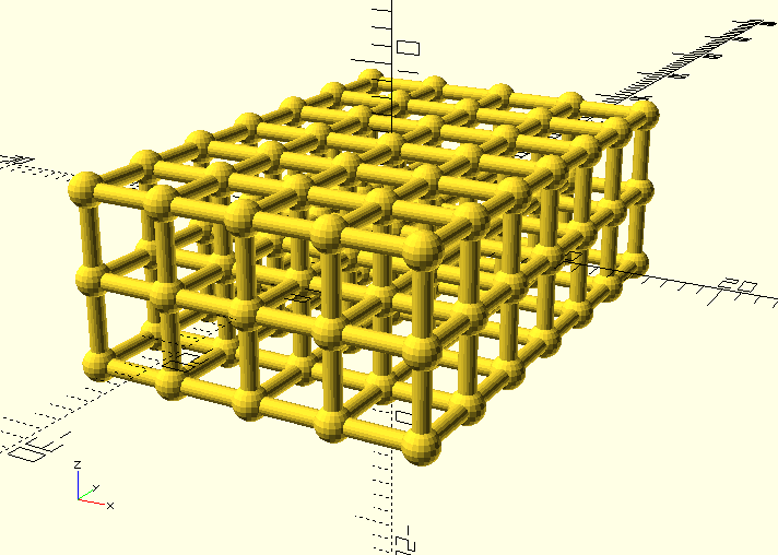

Fri, Mar 24, 2017 12:07 PM
That is exactly the point. Anything beyond linear_extruding a 2d object, is
exactly where the problem starts. Try to render (F6) the following small
piece - about 6 minutes on my machine. Then just multiply any dimension sx,
sy, or sz by just 2 and watch how render time grows.
http://forum.openscad.org/file/n21013/lattice.png
$fn = 20;
n = 2; // joints per 10mm
sx = 20;
sy = 30;
sz = 10;
th = 1;
lattice();
module lattice()
for(x=[0:10/n:sx], y=[0:10/n:sy], z=[0:10/n:sz] )
translate([sx/2-x,sy/2-y,sz/2-z])
sphere(th);
for(x=[0:10/n:sx], z=[0:10/n:sz] ) // y bars
translate([sx/2-x,0,sz/2-z])
rotate([90, 0])
cylinder(r=th/2, h=sy, center = true);
for(y=[0:10/n:sy], z=[0:10/n:sz] ) // y bars
translate([0, sy/2-y,sz/2-z])
rotate([0, 90])
cylinder(r=th/2, h=sx, center = true);
for(x=[0:10/n:sx], y=[0:10/n:sy] ) // z bars
translate([sx/2-x, sy/2-y])
cylinder(r=th/2, h=sz, center = true);
View this message in context: http://forum.openscad.org/Lattice-structure-tp21001p21013.html

I am not sure what "That is exactly the point" means, Parkinbot. I reviewed the thread, and was still unclear. A number of points were made in the thread. Exactly what is it that your example, below, demonstrates, please. Jon On 3/24/2017 8:07 AM, Parkinbot wrote: > That is exactly the point. Anything beyond linear_extruding a 2d object, is > exactly where the problem starts. Try to render (F6) the following small > piece - about 6 minutes on my machine. Then just multiply any dimension sx, > sy, or sz by just 2 and watch how render time grows. > <http://forum.openscad.org/file/n21013/lattice.png> > > >> $fn = 20; >> n = 2; // joints per 10mm >> sx = 20; >> sy = 30; >> sz = 10; >> th = 1; >> >> >> lattice(); >> module lattice() >> { >> >> for(x=[0:10/n:sx], y=[0:10/n:sy], z=[0:10/n:sz] ) >> translate([sx/2-x,sy/2-y,sz/2-z]) >> sphere(th); >> >> for(x=[0:10/n:sx], z=[0:10/n:sz] ) // y bars >> translate([sx/2-x,0,sz/2-z]) >> rotate([90, 0]) >> cylinder(r=th/2, h=sy, center = true); >> >> for(y=[0:10/n:sy], z=[0:10/n:sz] ) // y bars >> translate([0, sy/2-y,sz/2-z]) >> rotate([0, 90]) >> cylinder(r=th/2, h=sx, center = true); >> >> for(x=[0:10/n:sx], y=[0:10/n:sy] ) // z bars >> translate([sx/2-x, sy/2-y]) >> cylinder(r=th/2, h=sz, center = true); >> } >
DM
doug moen
Fri, Mar 24, 2017 2:40 PM
Parkinbot is pointing out that the "obvious" way of constructing a 3-D
lattice in OpenSCAD (unioning together the lattice elements) is likely to
be unacceptably slow, so you need to resort to other techniques.
Linear_extrude of a 2-D lattice works, as long as your lattice can be
described that way, and so far, s.dwivedi's examples are all
linear-extrudeable. The more general approach is to use polyhedron, but
that's more difficult. Once you have a big lattice, you have to be careful
not to union it with other shapes, or the performance problem reappears.
This issue (complex lattices vs boolean operations) is a limitation in the
design of OpenSCAD.

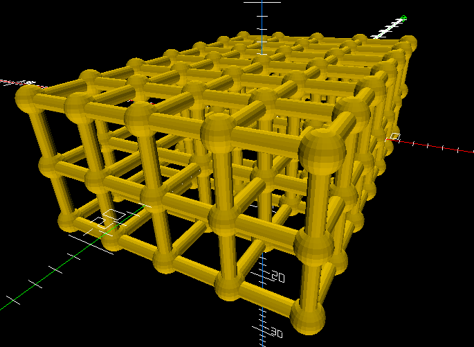

I tried your code on my new Linux machine using 2015.03-1 and found it
(F6) completed in 2 minutes and 48 seconds. I also translated your
OpenSCAD code into AngelScript and ran it through my Carve based boolean
engine on the same computer. It completed in 23 seconds, with a result
that looks similar to openSCAD.
Elsewhere, doug moen mentions that "This issue (complex lattices vs
boolean operations) is a limitation in the design of OpenSCAD."
One could argue that it is probably not so much a limitation in the
design of OpenSCAD but perhaps more a question of the characteristics of
the boolean engines (CGAL vs. Carve).
One thing I found was that creating subgroups (spheres+ybars, xbars,
zbars) was helpful in speeding things up in my code. I am guessing it is
because of bounding box checks.
As mentioned before, I am going to release my carve based engine on
github when I get around to it (need to learn git as well).
