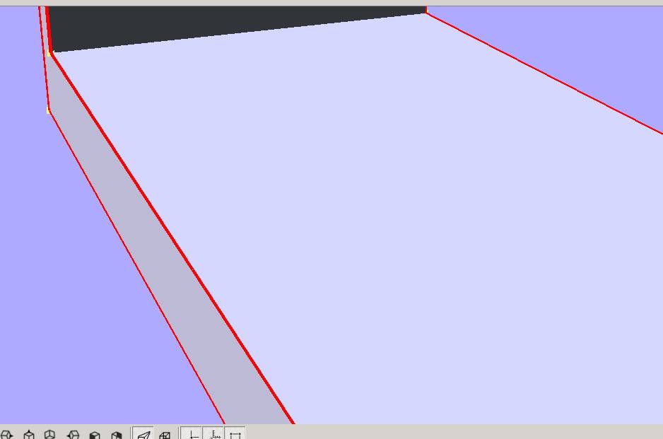

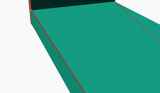

These are viewport parameters that give me the detached edges in perspective mode:
$vpt = [ -16.23, -7.25, 7.21 ];
$vpr = [ 64.10, 0.00, 69.10 ];
$vpd = 4.13;
still don't get your offset edges, 2015.03 & 2020.04.01 & 2020.07.05

This is what I get with those parameters with the snapshot I am using and
with OpenSCAD 2019.05:
An odd thing is when I first open OpenSCAD, load the file and press F6 the
lines are in the right place but if I switch to another window and back
again, or pan or zoom a tiny amount to provoke a redraw they move and seem
to stay like that until I zoom out.

Thu, Jul 23, 2020 8:04 AM
I even downloaded that exact snapshot, still not reproducing it.
This is a VM with S/W OpenGL render, I'll try it on my other physical box.
$vpd = 4.13;

I even downloaded that exact snapshot, still not reproducing it. This is a VM with S/W OpenGL render, I'll try it on my other physical box. _____ From: Discuss [mailto:discuss-bounces@lists.openscad.org] On Behalf Of nop head Sent: Thu, 23 Jul 2020 16:25 To: OpenSCAD general discussion Subject: Re: [OpenSCAD] Show edges broken This is what I get with those parameters with the snapshot I am using and with OpenSCAD 2019.05: image.png An odd thing is when I first open OpenSCAD, load the file and press F6 the lines are in the right place but if I switch to another window and back again, or pan or zoom a tiny amount to provoke a redraw they move and seem to stay like that until I zoom out. This is what my library info looks like: OpenSCAD Version: 2020.04.26.ci4968 (git 648206e2) System information: Windows(TM) 6.1 SP 1.0 NTW 1 MSDN 724833 4 CPUs 7.90 GB RAM User Agent: OpenSCAD/2020.04.26.ci4968 (git 648206e2) (Windows(TM) 6.1 SP 1.0 NTW 1 MSDN 724833) Compiler: GCC "7.4.0" 64bit MinGW build: MingW64 Debug build: No Boost version: 1_60 Eigen version: 3.3.7 CGAL version, kernels: 4.11, Cartesian, Extended_cartesian, Epeck OpenCSG version: OpenCSG 1.4.2 Qt version: 5.13.0 QScintilla version: 2.11.2 InputDrivers: GLib version: 2.50.2 lodepng version: 20180910 libzip version: 1.5.2 fontconfig version: 2.13.1 freetype version: 2.10.1 harfbuzz version: 2.4.0 lib3mf version: 1.8.0 Features: input-driver-dbus, function-literals, lazy-union Application Path: C:/Program Files/OpenSCAD Documents Path: C:\Users\ChrisP\Documents User Documents Path: C:\Users\ChrisP\Documents Resource Path: C:/Program Files/OpenSCAD User Library Path: C:/Users/ChrisP/Documents/OpenSCAD/libraries User Config Path: C:\Users\ChrisP\AppData\Local/OpenSCAD Backup Path: C:/Users/ChrisP/Documents/OpenSCAD/backups OPENSCADPATH: W:/CHRIS/Projects/RepRaptor/OpenSCADLibs OpenSCAD library path: W:/CHRIS/Projects/RepRaptor/OpenSCADLibs C:/Users/ChrisP/Documents/OpenSCAD/libraries C:/Program Files/OpenSCAD\libraries OPENSCAD_FONT_PATH: OpenSCAD font path: C:/Windows/fonts C:/Users/ChrisP/.local/share/fonts C:/Users/ChrisP/.fonts D:/usr/X11/lib/X11/fonts D:/System/Library/Fonts D:/Library/Fonts C:/Users/ChrisP/Library/Fonts GLEW version: 1.12.0 OpenGL Version: 4.0.0 - Build 10.18.10.4425 GL Renderer: Intel(R) HD Graphics 4000 GL Vendor: Intel RGBA(8888), depth(24), stencil(8) GL_ARB_framebuffer_object: yes GL_EXT_framebuffer_object: yes GL_EXT_packed_depth_stencil: yes Qt graphics widget: QGLWidgetGL Extensions: GL_3DFX_texture_compression_FXT1 GL_ARB_ES2_compatibility GL_ARB_ES3_compatibility GL_ARB_arrays_of_arrays GL_ARB_base_instance GL_ARB_blend_func_extended GL_ARB_buffer_storage GL_ARB_color_buffer_float GL_ARB_compatibility GL_ARB_compressed_texture_pixel_storage GL_ARB_conservative_depth GL_ARB_copy_buffer GL_ARB_debug_output GL_ARB_depth_buffer_float GL_ARB_depth_clamp GL_ARB_depth_texture GL_ARB_draw_buffers GL_ARB_draw_buffers_blend GL_ARB_draw_elements_base_vertex GL_ARB_draw_indirect GL_ARB_draw_instanced GL_ARB_explicit_attrib_location GL_ARB_fragment_coord_conventions GL_ARB_fragment_program GL_ARB_fragment_program_shadow GL_ARB_fragment_shader GL_ARB_framebuffer_no_attachments GL_ARB_framebuffer_object GL_ARB_framebuffer_sRGB GL_ARB_geometry_shader4 GL_ARB_get_program_binary GL_ARB_gpu_shader5 GL_ARB_gpu_shader_fp64 GL_ARB_half_float_pixel GL_ARB_half_float_vertex GL_ARB_instanced_arrays GL_ARB_internalformat_query GL_ARB_internalformat_query2 GL_ARB_map_buffer_alignment GL_ARB_map_buffer_range GL_ARB_multi_draw_indirect GL_ARB_multisample GL_ARB_multitexture GL_ARB_occlusion_query GL_ARB_occlusion_query2 GL_ARB_pixel_buffer_object GL_ARB_point_parameters GL_ARB_point_sprite GL_ARB_program_interface_query GL_ARB_provoking_vertex GL_ARB_robustness GL_ARB_sample_shading GL_ARB_sampler_objects GL_ARB_seamless_cube_map GL_ARB_separate_shader_objects GL_ARB_shader_atomic_counters GL_ARB_shader_bit_encoding GL_ARB_shader_objects GL_ARB_shader_precision GL_ARB_shader_subroutine GL_ARB_shading_language_100 GL_ARB_shading_language_420pack GL_ARB_shading_language_packing GL_ARB_shadow GL_ARB_stencil_texturing GL_ARB_sync GL_ARB_tessellation_shader GL_ARB_texture_border_clamp GL_ARB_texture_buffer_object_rgb32 GL_ARB_texture_buffer_range GL_ARB_texture_compression GL_ARB_texture_compression_bptc GL_ARB_texture_compression_rgtc GL_ARB_texture_cube_map GL_ARB_texture_cube_map_array GL_ARB_texture_env_add GL_ARB_texture_env_combine GL_ARB_texture_env_crossbar GL_ARB_texture_env_dot3 GL_ARB_texture_float GL_ARB_texture_gather GL_ARB_texture_multisample GL_ARB_texture_non_power_of_two GL_ARB_texture_query_lod GL_ARB_texture_rectangle GL_ARB_texture_rg GL_ARB_texture_rgb10_a2ui GL_ARB_texture_storage GL_ARB_texture_storage_multisample GL_ARB_texture_swizzle GL_ARB_timer_query GL_ARB_transform_feedback2 GL_ARB_transform_feedback3 GL_ARB_transform_feedback_instanced GL_ARB_transpose_matrix GL_ARB_uniform_buffer_object GL_ARB_vertex_array_bgra GL_ARB_vertex_array_object GL_ARB_vertex_attrib_64bit GL_ARB_vertex_attrib_binding GL_ARB_vertex_buffer_object GL_ARB_vertex_program GL_ARB_vertex_shader GL_ARB_vertex_type_2_10_10_10_rev GL_ARB_viewport_array GL_ARB_window_pos GL_ATI_separate_stencil GL_EXT_abgr GL_EXT_bgra GL_EXT_blend_color GL_EXT_blend_equation_separate GL_EXT_blend_func_separate GL_EXT_blend_minmax GL_EXT_blend_subtract GL_EXT_clip_volume_hint GL_EXT_compiled_vertex_array GL_EXT_draw_buffers2 GL_EXT_draw_range_elements GL_EXT_fog_coord GL_EXT_framebuffer_blit GL_EXT_framebuffer_multisample GL_EXT_framebuffer_object GL_EXT_geometry_shader4 GL_EXT_gpu_program_parameters GL_EXT_gpu_shader4 GL_EXT_multi_draw_arrays GL_EXT_packed_depth_stencil GL_EXT_packed_float GL_EXT_packed_pixels GL_EXT_rescale_normal GL_EXT_secondary_color GL_EXT_separate_specular_color GL_EXT_shader_integer_mix GL_EXT_shadow_funcs GL_EXT_stencil_two_side GL_EXT_stencil_wrap GL_EXT_texture3D GL_EXT_texture_array GL_EXT_texture_buffer GL_EXT_texture_compression_s3tc GL_EXT_texture_edge_clamp GL_EXT_texture_env_add GL_EXT_texture_env_combine GL_EXT_texture_filter_anisotropic GL_EXT_texture_integer GL_EXT_texture_lod_bias GL_EXT_texture_rectangle GL_EXT_texture_sRGB GL_EXT_texture_sRGB_decode GL_EXT_texture_shared_exponent GL_EXT_texture_snorm GL_EXT_texture_storage GL_EXT_texture_swizzle GL_EXT_transform_feedback GL_IBM_texture_mirrored_repeat GL_INTEL_map_texture GL_INTEL_performance_queries GL_INTEL_performance_query GL_KHR_blend_equation_advanced GL_KHR_debug GL_NV_blend_square GL_NV_conditional_render GL_NV_primitive_restart GL_NV_texgen_reflection GL_SGIS_generate_mipmap GL_SGIS_texture_edge_clamp GL_SGIS_texture_lod GL_SUN_multi_draw_arrays GL_WIN_swap_hint WGL_ARB_buffer_region WGL_ARB_create_context WGL_ARB_create_context_profile WGL_ARB_create_context_robustness WGL_ARB_extensions_string WGL_ARB_framebuffer_sRGB WGL_ARB_make_current_read WGL_ARB_multisample WGL_ARB_pbuffer WGL_ARB_pixel_format WGL_ARB_pixel_format_float WGL_EXT_create_context_es2_profile WGL_EXT_create_context_es_profile WGL_EXT_depth_float WGL_EXT_extensions_string WGL_EXT_pixel_format_packed_float WGL_EXT_swap_control WGL_EXT_swap_control_tear WGL_NV_DX_interop On Thu, 23 Jul 2020 at 00:22, Michael Marx <michael@marx.id.au> wrote: These are viewport parameters that give me the detached edges in perspective mode: $vpt = [ -16.23, -7.25, 7.21 ]; $vpr = [ 64.10, 0.00, 69.10 ]; $vpd = 4.13; still don't get your offset edges, 2015.03 & 2020.04.01 & 2020.07.05 <http://www.avg.com/email-signature?utm_medium=email&utm_source=link&utm_campaign=sig-email&utm_con tent=emailclient> Virus-free. <http://www.avg.com/email-signature?utm_medium=email&utm_source=link&utm_campaign=sig-email&utm_con tent=emailclient> www.avg.com _______________________________________________ OpenSCAD mailing list Discuss@lists.openscad.org http://lists.openscad.org/mailman/listinfo/discuss_lists.openscad.org -- This email has been checked for viruses by AVG. https://www.avg.com
$vpd = 4.13;
tent=emailclient>
Virus-free.

I noticed GL Renderer: Intel(R) HD Graphics 4000, Intel has always had strangeness, try
goldfeather.

Have you tried a later snapshot?
On my physical box, 2020.04.26 has a anomaly, the preferences dialogue is blank.

Isn't goldfeather only relevant to OpenCSG preview mode?

Hmm yeh, oldtimers disease...

The latest snapshot from where I am looking is OpenSCAD 2020.07.23.ci5585
and that is exactly the same showing edges and the preferences dialog seems
to work.

Well, until someone else jumps in, it seems to be your H/W or S/W.
Or someone could specify some --debug parameters maybe?
