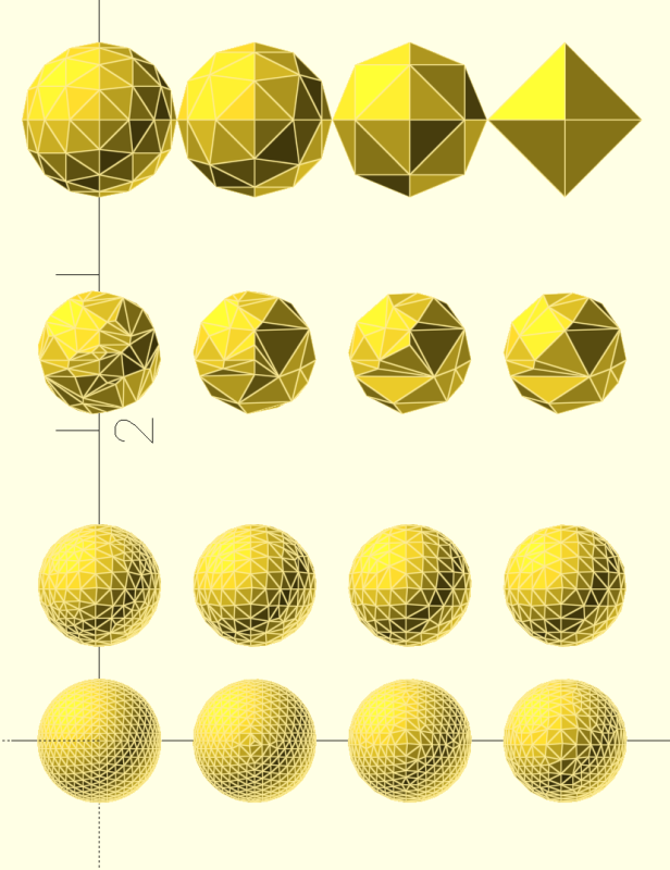

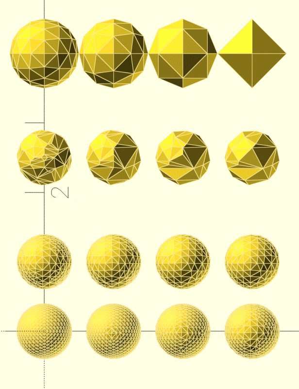

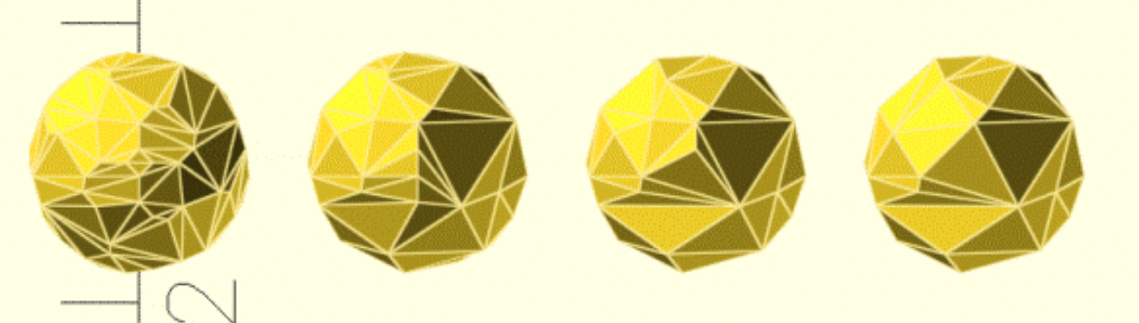

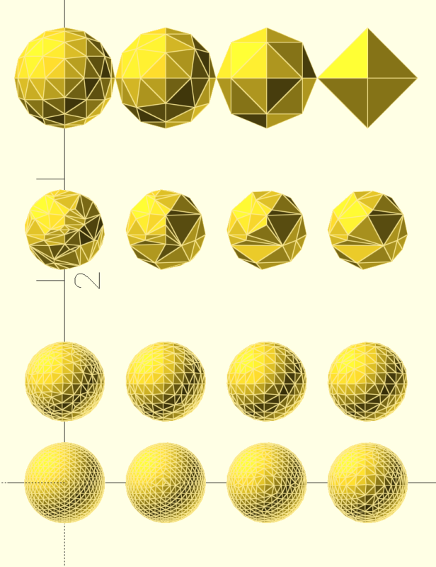

The query wrt manifold and slivers reminded me of some playing around I
did a few months ago, which may or may not be of interest. Manifold
'simplify' states that it tries to reduce the number of vertices,
without destroying the overall shape. I also had had AI to produce the
code for a function to reduce points, so I thought I would compare the
results. I found that simplify was a bit coarse or unpredictable in
generating the final shape. I think maybe finer steps may help, but is
does not seem to preserve the original shape too well. I cannot recall
using it to remove slivers, I think it would merely make them thinner,
so I have a function to specifically remove slivers.
A sphere is generated by triangles, or segments, as is everything in
manifold. Point reduction, if all points are equally spaced, will either
remove all of them or none. I distorted (scaled) the sphere to give
unequal vertex spacing.
For the tests illustrated below, I started with a sphere of 50 segments,
and gradually reduced the points. The bottom two rows were with my point
reduction method, the third row was with simplify, the top row was by
reducing the number of segments in the sphere.
I've included my cad code (which is neither openscad nor python, but it
should be readable, showing the values used), attached the openscad
result, so you can 'spin it around', and the terminal op, which gives
the number of vertices and tris for each shape.
Best wishes,
Ray

reduce points args -
params[0] tol
params[1] return_broken (0/1)
params[2] mode: 0=snap-to-root, 1=nearest-root, 2=centroid
params[3] min_area (optional, default 0)
For “remove sphere on cube corner,” use tol ≈ sphere_radius +
small_epsilon (e.g., 5.05) so you don’t touch other cube corners.
If you see dents, try mode=2 (centroid) and a tiny min_area like 1e-6:
reduce_points(d, 5.05, 0, 2, 1e-6)
For threads, start with mode=1 (nearest-root) and small tol to preserve
crests/flanks.
//verbose_set_global(true)
s0 = sphere(d=0.9, segments=50)
s0 =scale (s0,[0.8,0.8,1])
// Reduce points in steps
s1 = reduce_points(s0, 0.05,1,2)
s2 = reduce_points(s1, 0.055,1,2)
s3 = reduce_points(s2, 0.06,1,2)
s4 = reduce_points(s3, 0.065,1,2)
s5 = reduce_points(s4, 0.07,1,2)
s6 = reduce_points(s5, 0.075,1,2)
s7 = reduce_points(s6, 0.08,1,2)
// Arrange spheres for visualization
s0 = translate(s0, [0, 0, 0])
s1 = translate(s1, [1, 0, 0])
s2 = translate(s2, [2, 0, 0])
s3 = translate(s3, [3, 0, 0])
s4 = translate(s4, [0, 1, 0])
s5 = translate(s5, [1, 1, 0])
s6 = translate(s6, [2, 1, 0])
s7 = translate(s7, [3, 1, 0])
// use manifold simplify to reduce points
p1 = simplify(s0,.05)
p2 = simplify(p1,.055)
p3 = simplify(p2,.06)
p4 = simplify(p3,.065)
p1 = translate(p1, [0, 2.5, 0])
p2 = translate(p2, [1, 2.5, 0])
p3 = translate(p3, [2, 2.5, 0])
p4 = translate(p4, [3, 2.5, 0])
// reduce segments
c1 = sphere(d = .9,segments = 14)
c2 = sphere(d = .9,segments = 9)
c3 = sphere(d = .9,segments = 5)
c4 = sphere(d = .9,segments = 3)
c1 = translate(c1, [0, 4, 0])
c2 = translate(c2, [1, 4, 0])
c3 = translate(c3, [2, 4, 0])
c4 = translate(c4, [3, 4, 0])
show_scad([s0,s1,s2,s3,s4,s5,s6,s7,p1,p2,p3,p4,c1,c2,c3,c4])
[show_scad] Shape 0: mesh verts=678 tris=1352 | raw_mesh verts=0 tris=0
[show_scad] Shape 1: mesh verts=619 tris=1234 | raw_mesh verts=0 tris=0
[show_scad] Shape 2: mesh verts=499 tris=994 | raw_mesh verts=0 tris=0
[show_scad] Shape 3: mesh verts=409 tris=814 | raw_mesh verts=0 tris=0
[show_scad] Shape 4: mesh verts=306 tris=608 | raw_mesh verts=0 tris=0
[show_scad] Shape 5: mesh verts=237 tris=470 | raw_mesh verts=0 tris=0
[show_scad] Shape 6: mesh verts=195 tris=386 | raw_mesh verts=0 tris=0
[show_scad] Shape 7: mesh verts=181 tris=358 | raw_mesh verts=0 tris=0
[show_scad] Shape 8: mesh verts=95 tris=186 | raw_mesh verts=0 tris=0
[show_scad] Shape 9: mesh verts=53 tris=102 | raw_mesh verts=0 tris=0
[show_scad] Shape 10: mesh verts=36 tris=68 | raw_mesh verts=0 tris=0
[show_scad] Shape 11: mesh verts=31 tris=58 | raw_mesh verts=0 tris=0
[show_scad] Shape 12: mesh verts=66 tris=128 | raw_mesh verts=0 tris=0
[show_scad] Shape 13: mesh verts=38 tris=72 | raw_mesh verts=0 tris=0
[show_scad] Shape 14: mesh verts=18 tris=32 | raw_mesh verts=0 tris=0
[show_scad] Shape 15: mesh verts=6 tris=8 | raw_mesh verts=0 tris=0
What is the tolerance you are using for simplify? And manifold changed a
lot in the past few months, and simplification behavior changed.

Michael Marx (spintel)
Fri, Jan 30, 2026 12:27 AM
The 3rd from the bottom-up?
I did a few months ago, which may or may not be of interest. Manifold
the results. I found that simplify was a bit coarse or unpredictable
in generating the final shape. I think maybe finer steps may help, but
is does not seem to preserve the original shape too well. I cannot
recall using it to remove slivers, I think it would merely make them
thinner, so I have a function to specifically remove slivers.
either remove all of them or none. I distorted (scaled) the sphere to
give unequal vertex spacing.
segments, and gradually reduced the points. The bottom two rows were
with my point reduction method, the third row was with simplify, the
top row was by reducing the number of segments in the sphere.
it should be readable, showing the values used), attached the
openscad result, so you can 'spin it around', and the terminal op,
which gives the number of vertices and tris for each shape.
Best wishes,
Ray
/*// Create the original sphere with 50 segments
params[0] tol
preserve crests/flanks.
s0=sphere(d=0.9, segments=50)
s0=scale(s0,[0.8,0.8,1])
s1=reduce_points(s0, 0.05,1,2)
s2=reduce_points(s1, 0.055,1,2)
s3=reduce_points(s2, 0.06,1,2)
s4=reduce_points(s3, 0.065,1,2)
s5=reduce_points(s4, 0.07,1,2)
s6=reduce_points(s5, 0.075,1,2)
s7=reduce_points(s6, 0.08,1,2)
s0=translate(s0, [0, 0, 0])
s1=translate(s1, [1, 0, 0])
s2=translate(s2, [2, 0, 0])
s3=translate(s3, [3, 0, 0])
s4=translate(s4, [0, 1, 0])
s5=translate(s5, [1, 1, 0])
s6=translate(s6, [2, 1, 0])
s7=translate(s7, [3, 1, 0])
p1=simplify(s0,.05)
p2=simplify(p1,.055)
p3=simplify(p2,.06)
p4=simplify(p3,.065)
p1=translate(p1, [0, 2.5, 0])
p2=translate(p2, [1, 2.5, 0])
p3=translate(p3, [2, 2.5, 0])
p4=translate(p4, [3, 2.5, 0])
// reduce segments
c1=sphere(d=.9,segments=14)
c2=sphere(d=.9,segments=9)
c3=sphere(d=.9,segments=5)
c4=sphere(d=.9,segments=3)
c1=translate(c1, [0, 4, 0])
c2=translate(c2, [1, 4, 0])
c3=translate(c3, [2, 4, 0])
c4=translate(c4, [3, 4, 0])
yes, these
