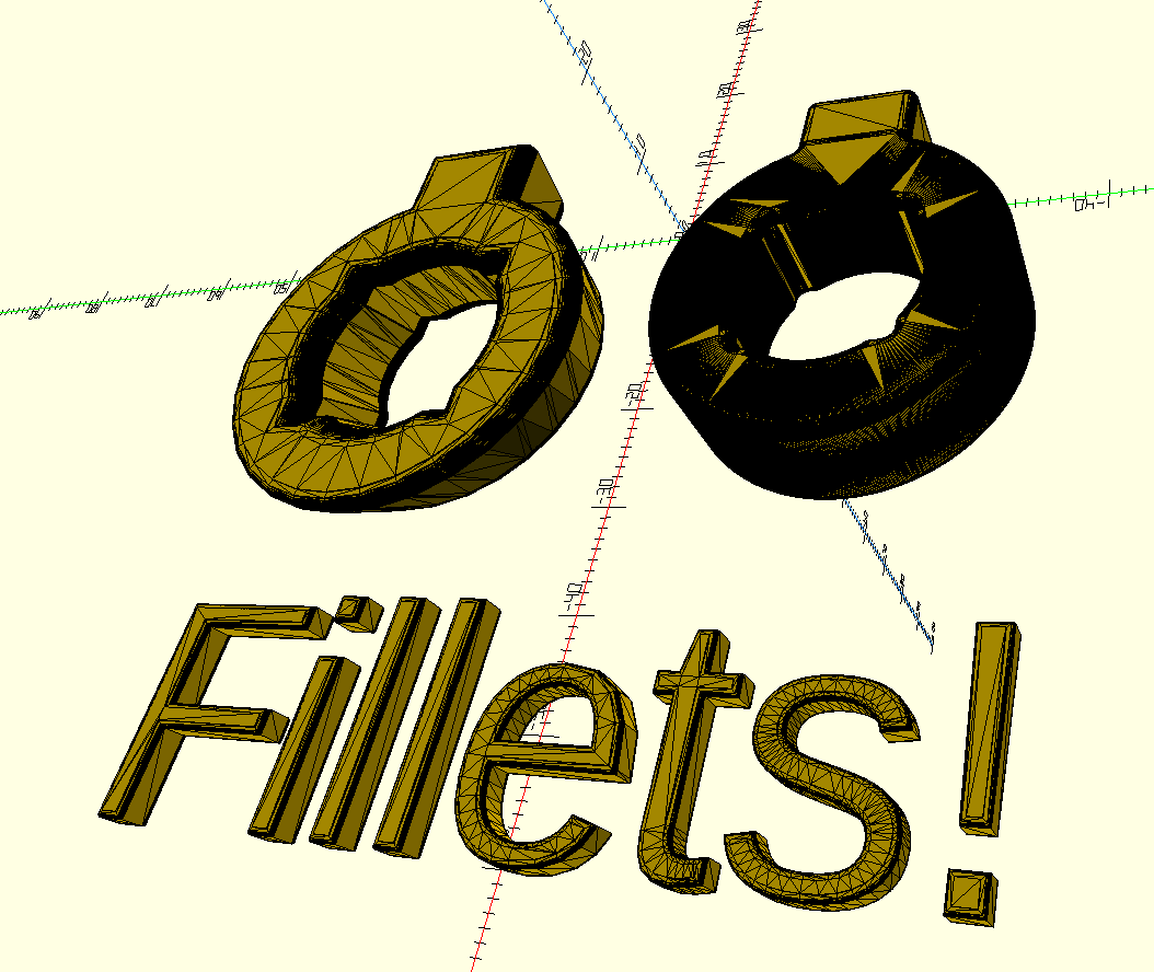

In the past, I've managed to get around the things i want to round the
corners, ether by differencing a sort of Maltese cross shape for simple
square edges, or importing the scad file into freecad and re-exporting
it, sometimes it works, but not if a minkowski is used in the scad file.
I fond this fillet library - https://www.thingiverse.com/thing:2461392
but it takes 10minutes and 22secs just to do the quick view of the demo
files, and a further 31minutes 36seconds to render for the stl. I pasted
the original scad code  into the  AngelCad text editor, saved it as an
scad, and then it only took 9.285 seconds to get to the stl. That is a
pretty big improvement in speed., makes things usable. I still need to
see if the filleting does what I want.

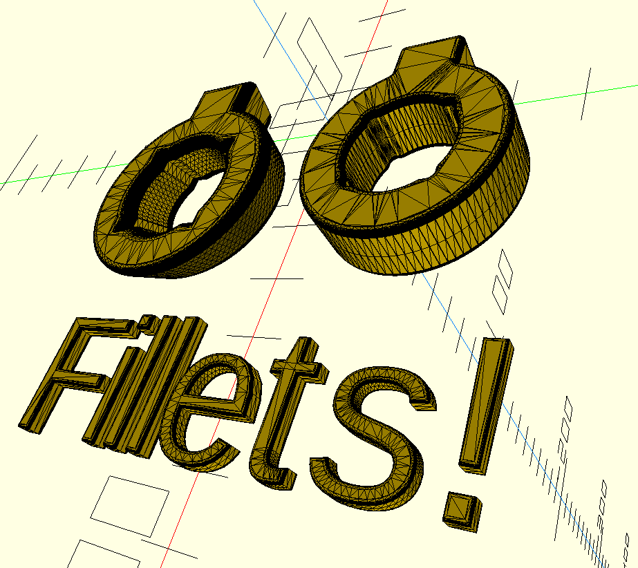

I downloaded/saved fillet2d.scad and fillet3d.scad in the same folder,
then ran fillet3d.scad in OpenSCAD and AngelCAD. Times for getting the
STL on my computer (Kubuntu 18.04, 32GB RAM)
OpenSCAD: 16m 35s  version 2021.04.05.nightly (git 9f01067)
AngelCAD:  1m 10s  version v1.5-06 (secant_tolerance=0.01)
STL File sizes:
OpenSCAD: 8.1 MB
AngelCAD: 5.1 MB
The difference in size is due to different discretization of the result.
