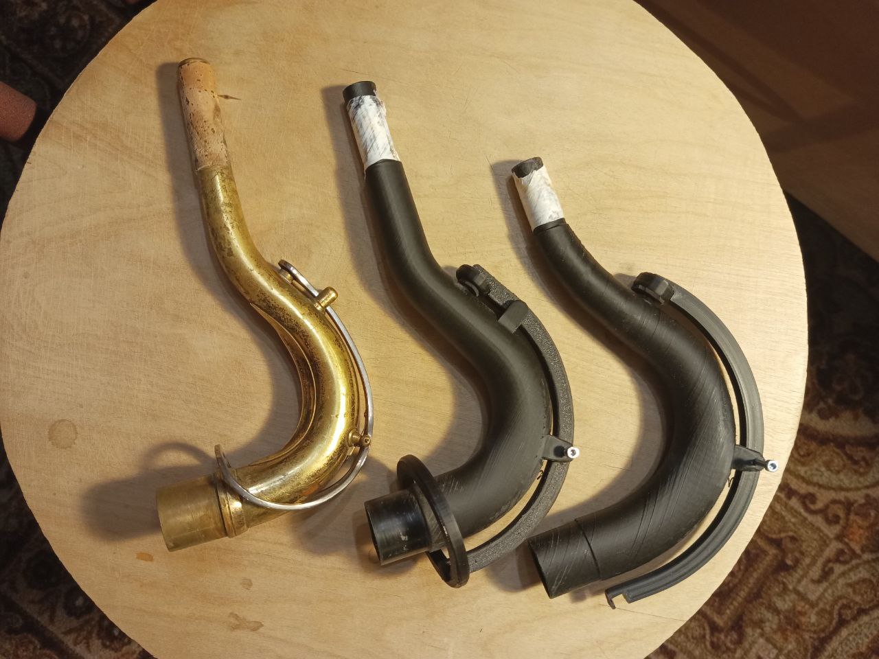

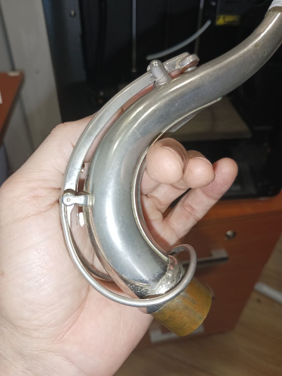

I want to build a sax neck key
it seems firstly to make it flat than to bend
But I believe there is more elegant way|
See attach
I want to build a sax neck key \ it seems firstly to make it flat than to bend\ But I believe there is more elegant way|\ See attach
YV
yur_vol@yahoo.com
Fri, Apr 18, 2025 2:58 PM
Currently I built simplified type but want more original one
