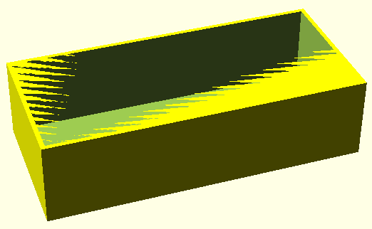

Hi there,
I've tried OpenSCAD for mac (v2015.03) with a sample form.
My goal is to create an empty box (with a cover not yet designed).
The same code doesn't give the same preview.
Under macOS, the box doesn't seem to be empty
http://forum.openscad.org/file/t2373/macos.png
With OpenSCAD.net, the same code does show an empty box
http://forum.openscad.org/file/t2373/openscad.png
I did try the developer version (v2018), I still have the same issue.
I think the code is ok, but just in case, I'll give it attached.
Here it is the code.
emptybox.scad http://forum.openscad.org/file/t2373/emptybox.scad
macOS : High Sierra 10.13.4
Any ideas?

I see Z-fighting:
This is an issue with your code:
https://en.wikibooks.org/wiki/OpenSCAD_User_Manual/FAQ#What_are_those_strange_flickering_artifacts_in_the_preview?
please make the box you are using for the difference a bit bigger then
the volume you want to remove, so that it is not ambivalent whether the
surface has to be removed or not.
