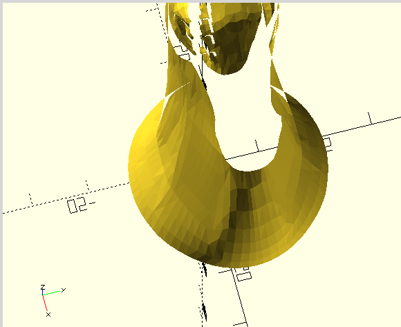

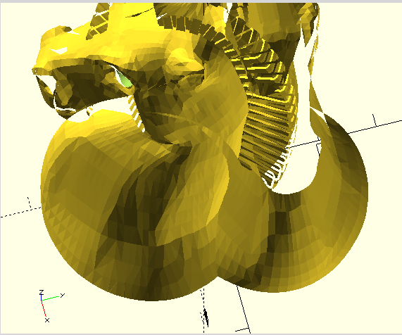

I have another problem with this job.
The preview isn't really good though.
The attached pictures shows that the surface is transparent. I checked and corrected the original file with FReecad.
``` I have another problem with this job. The preview isn't really good though. The attached pictures shows that the surface is transparent. I checked and corrected the original file with FReecad. ```
Fri, Feb 24, 2023 2:52 AM
though.
That one's easy.  You need to set the "convexity" parameter in the import.
In theory you should set it to the largest number of times a ray passing
through the object might enter and exit the object.
In practice it's usually fine to set it to some large but not huge
number like 10.
https://en.wikibooks.org/wiki/OpenSCAD_User_Manual/FAQ#Why_are_some_parts_(e.g._holes)_of_the_model_not_rendered_correctly?

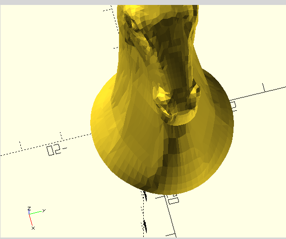

Fri, Feb 24, 2023 10:27 AM
Thanks, convexity solved the preview. :)

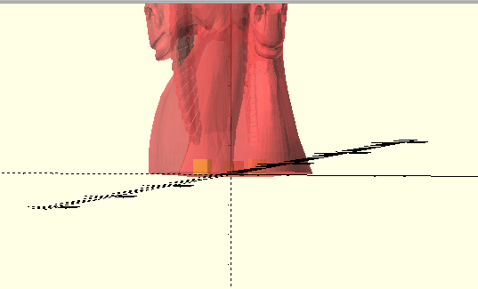

- ”try this”
As you can see in the picture, the cube appears in the preview, but the render does not display the cube either. The CGAL error and "no renderable surface" remained.

The problem is probably that your STL is not good enough for OpenSCAD's
picky CGAL processing.
What mean is it? And what can I do?
> The problem is probably that your STL is not good enough for OpenSCAD's \ > picky CGAL processing. What mean is it? And what can I do?
Fri, Feb 24, 2023 7:22 PM
 OpenSCAD's
I'm not an expert in isolating STL problems.  See the entry in the FAQ
for some hints
https://en.wikibooks.org/wiki/OpenSCAD_User_Manual/FAQ#Why_is_my_imported_STL_file_appearing_with_F5_but_not_F6
or maybe one of the people who is an expert in STL problems can look
at your STL.
The first thing I would do is to set View/Thrown Together, and
preview... anything purple is bad.  The outside of the model is yellow
and the inside is purple, so if you can see anything purple, it means
that something is inside-out.
But beyond that, alas, I don't know.
