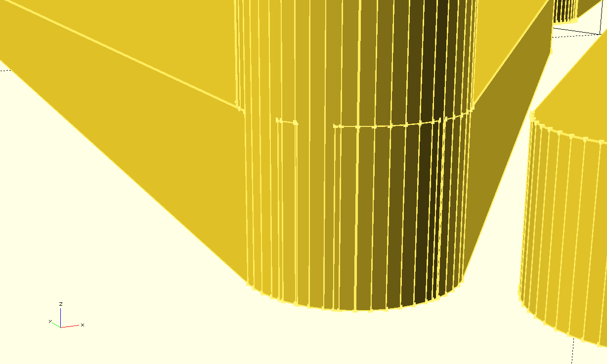

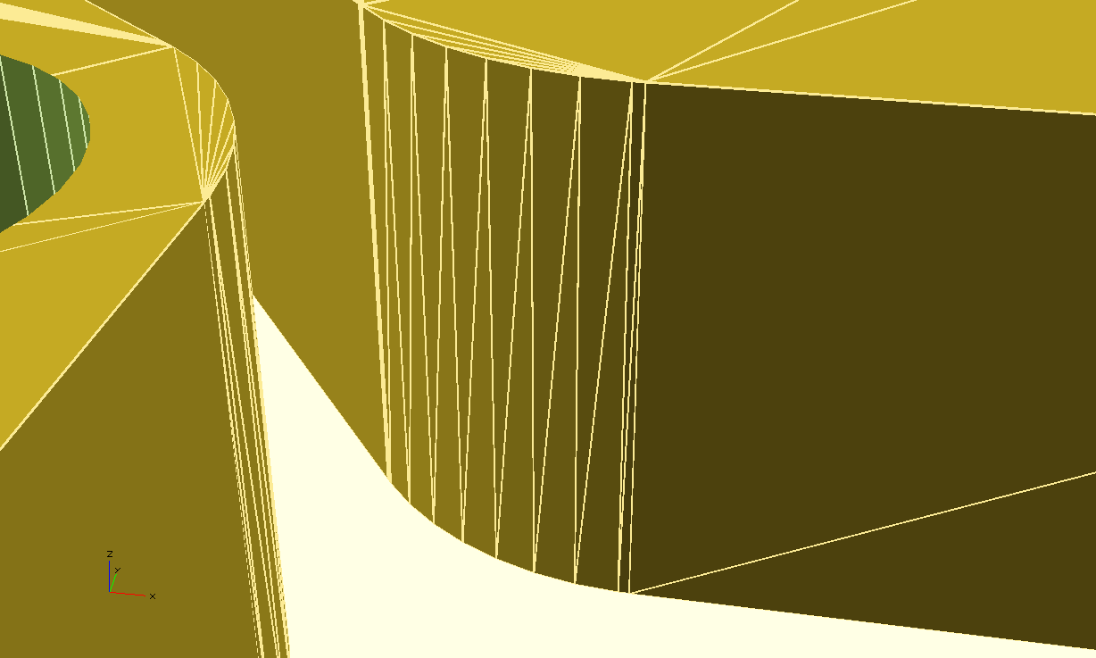

A cylinder is not the same as a linear_extruded circle. The side facets of
a cylinder are rectangles whereas the linear_extrude version are a pair of
triangles. This causes ugliness if you want to union them. Using a
linear_extruded circle instead of a cylinder works in some cases but I
still seem to have problems when the height is very different.
Here is an example:-
A base made from a hull of circles linear extruded.
A cylinder made from exactly the same circle linear extruded.
The union has extra facets and vertices on the base for some reason I don't
quite understand.
Could linear extrude use rectangles in the case when there is no twist so
the points are guaranteed to be planar?

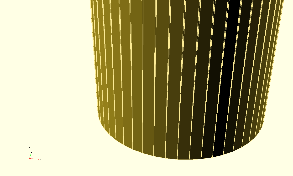

The union seems to make up extra vertices. If I show the cylinder on its
own or the hull on its own the vertices are in the same place. Also they
are as should be with F5 but F6 introduces new vertices that should not be
there. I tried to distil it down to a simple example but that works fine.

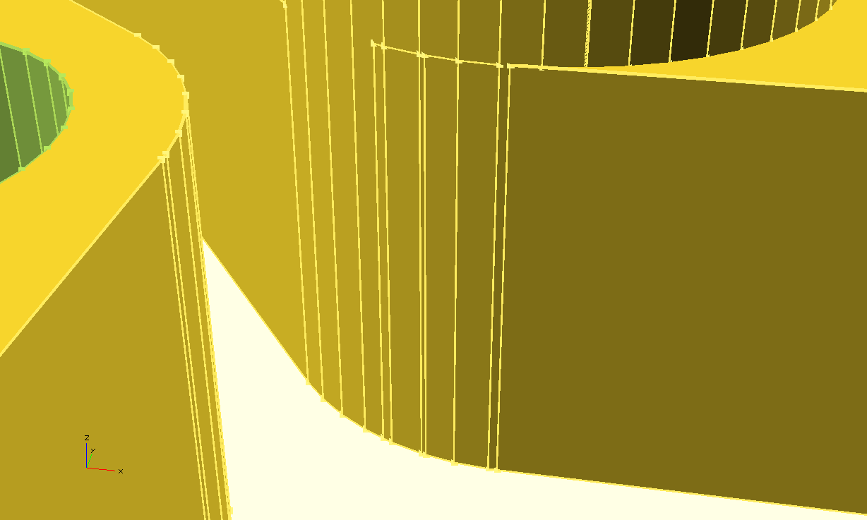

I am trying to get rid of degenerate triangles in the STL. I think they
come from these extra facets and vertices. However I now think it may be a
bug in CGAL union.
Here is the result from my code with a lot removed. There are extra facets

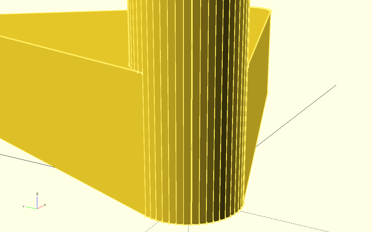

Here is my simple test code to re-create the bug, but it doesn't happen.
$fa = 5;
$fs = 0.5;
cylinder(r = 4, h= 100);
linear_extrude(height = 10) hull() {
        circle(4);
    translate([30, 10, 0])
        circle(4);
    translate([10, 30, 0])
        circle(4);
This is what it should look like because the vertices on the top and bottom
of the cylinder should exactly match those of the rounded corner,
regardless of number representation as they are all created by circle or
cylinder with the same parameters.
