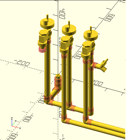

So it's past time to overhaul the sprinklers in the front yard, and that
involved building a new sprinkler manifold.
A normal person would sketch out something, go buy some parts, and start
putting them together.  But that would be too easy!
Besides, I kept losing track of how many of each part I needed.
OpenSCAD to the rescue!
That's a sprinkler manifold, with automatic valves.

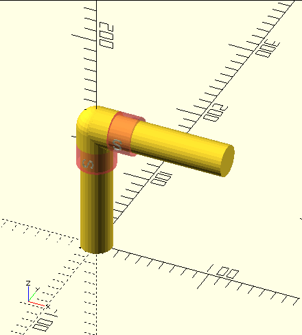

Once I got the components built, describing the plumbing was easy.  You
start with the source of the water, and for each component the
downstream components are its children.  Thus, e.g.:
pipe(length=100) elbow() pipe(length=100);
yields:
Tees are a little trickier, but not much:  they have two children.

This is not product-grade, but it let me "draw" my project and produce a
BOM.
The components come first; a couple of manifold models are at the end.
(Note that only plan2() is rendered; plan1() is an earlier idea that I
didn't end up using.)

// +Y is north
// Eventually I want to have an exploded view.  But not yet.
explode = false;
valve_z = 280;
manifold_depth = 200;
reg_z = valve_z;
sv_sep = sprinkler_valve_dims()[2];
// Variation 1:  with pressure regulator.
// I didn't end up using this variation.
module plan1() {
    pipe(length=reg_z-50)
        connector()
        pipe(length=50)
        rotate(180) elbow(type1=SLIP, type2=MIPT, sched=80)
        rotate(180) regulator()
        rotate(180) elbow(type1=MIPT, type2=SLIP)
        pipe(length=50)
        rotate(180) tee(size3=S34, type3=FIPT) {
            pipe(length=manifold_depth + reg_z - 80)
            rotate(-90) elbow()
                pipe(length=sv_sep)
                tee() {
                    pipe(length=sv_sep)
                        elbow()
                        pipe(length=valve_z + manifold_depth)
                        rotate(-90) sprinkler_valve_assy()
                        pipe(length=valve_z);
            rotate(-90) hosebib();
// Variation 2:  Starting downstream of existing regulator,
// at a different point in the system.
// This is what I ended up building.
module plan2() {
    rotate([180,0,0])
        connector(type1=MIPT, size=S1)
        pipe(length=50, size=S1)
        rotate(90) elbow(size=S1)
        pipe(length=100, size=S1)
        corner(size1=S1,size2=S1) {
            pipe(length=400, size=S1)
                rotate(180) sprinkler_valve_assy(size=S1);
            pipe(length=sv_sep)
                tee() {
                    pipe(length=sv_sep)
                        elbow()
                        pipe(length=300)
                        rotate(180) tee(type3=FIPT) {
                            pipe(length=70)
                                    pipe(length=400)
                                    rotate(-90) elbow()
                                    pipe(length=1450)
                                    rotate(90) angle45()
                                    pipe(length=1000);
                            rotate(90) hosebib();
                    pipe(length=400)
                        rotate(90) sprinkler_valve_assy()
                        pipe(length=430)
                        rotate(-90) elbow()
                        pipe(length=1500)
                        pipe(length=1000);
plan2();
