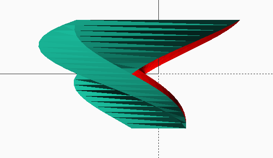

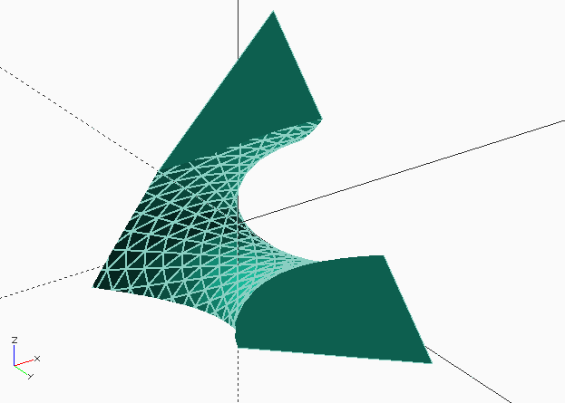

I have used the following modules and functions to model the Hart's Cube
Puzzle, a cousin of your model, that I have published in Thingiverse:
module helicalVolume(r, h, turn, n, gap)
linear_extrude(height=turn*h, twist=-360*turn,$fn=n)
    // scale up the shape to avoid polygon point eliminations
    scale(1/100) polygon(100*shape(r, h/4, n, gap));
// horizontal planar shape for extruding
function shape(r, h, n=20, gap) =
concat(  [for (i=[n:-1:-n]) hlxpoint(h,gap/2,r*i/n)],
         [ [r,-r], [r,r]] );
// this computation is needed to have an uniform gap between pieces
// the intersection point of the the XY plane and the helix through
// point rotY(atan(y*PI/h), [x,y,0])
function hlxpoint(h,x,y) =
let( b  = atan(y*PI/h),
     cb = cos(b),
     sb = sin(b),
     a  = -x*sb*180/h,
     ca = cos(a),
     sa = sin(a) )
[ca*(x*cb) - sa*y, sa*(x*cb) + y*ca];
The module helicalVolume does what you intended with your linear_extrusion.
In fact, it calls linear_extrude but without slices. The function 'shape'
builds the vertices of the polygon to be extruded. Previewing polygon(shape
(r, h, n, 0.1) ) with Show Edges you will see that the "rectangle" has
2*n+1 vertices on the side nearest to the origin. That side is slightly
curved when the parameter gap>0. An extra measure to avoid vertex removal
is to scale up the polygon points and scale down the polygon itself. All
those extra vertices are discarded anyway by polygon() when gap=0.
Helpfully the parameter 'gap' is fundamental to have a workable puzzle: it
is the necessary gap between the two identical pieces that will be screwed
to solve the puzzle.
You will have to find the appropriate values for the helicalVolume()
parameters to model your tetrahedron puzzle. The following image is just a
test.
[image: tetrapuzzle.PNG]

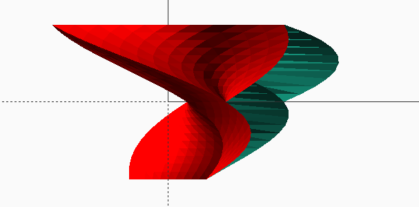

I did a little experiment coding linear_extrude in user space. It receives
as main parameter a polygon expressed by its vertex coordinates instead of
a polygon(). The module extrude_up(), code attached, computes the extrusion
sections according to the input parameters height, center, twist, scale and
slices besides the polygon vertex list. Those sections are input to another
module, also attached, I already had in my libraries: loft(), which wrap up
the sections in one polyhedron.
In order to get a better approximation for twisted extrusions, extrude_up()
refines the input polygon according to slices and height: all polygon edges
longer than height/slices are subdivide in segments smaller than that
value. On other hand, loft() triangulates the quads by taking the smallest
quad diagonal because the system default triangulation doesn't follow that
rule.
The results are good in my appreciation which suggests that linear_extrude
deserves a revision. I have found in addition that linear_extrude
transforms twisted scaled sections in a awkward way. When both scale and
twist are given, linear_extrude() applies the scale after the twist
rotation while extrude_up() applies the scale first. This produces weird
results in my opinion as seen bellow:
[image: comparison2.PNG][image: comparison.PNG]
The red shape was produced by extrude_up() and the other by linear_extrude
with the same parameters scale=[2,1] and twist=180. The provided
extrude_up() code includes commented the transform that seems to be used by
linear_extrude() and the application example above.
