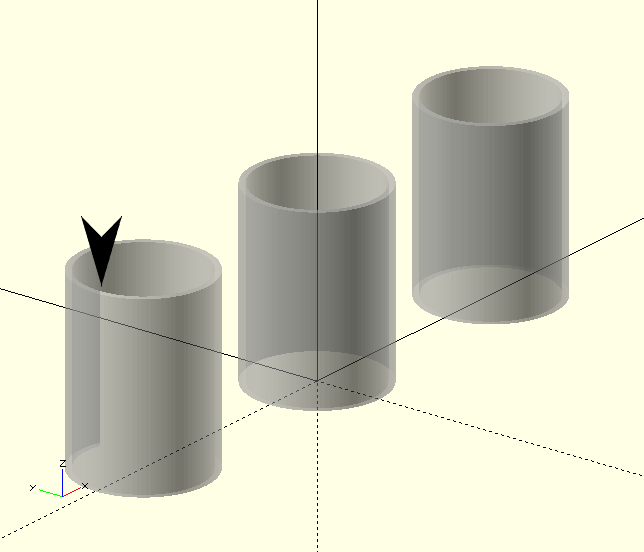

mikeonenine@web.de
Sun, Dec 7, 2025 7:04 PM
Leonard Martin Struttmann wrote:
I agree.  Just removing the color() line made it look much better.
Well maybe, but it has to be transparent grey!
Linear_extrude works. Why does rotate_extrude produce a shadow (with or without render)?
Unfortunately, it is not possible to obtain a step with linear_extrude.
$fn=100;
color([0.7, 0.7, 0.7], 0.4)
translate([-40, 0, 0])
rotate_extrude()
translate([20, 0])
square([2, 60]);
translate([40, 0, 0])
linear_extrude(60)
circle(22);
circle(20);
Leonard Martin Struttmann wrote: > I agree. Just removing the color() line made it look much better. Well maybe, but it has to be transparent grey! Linear_extrude works. Why does rotate_extrude produce a shadow (with or without render)? Unfortunately, it is not possible to obtain a step with linear_extrude. `$fn=100;` `color([0.7, 0.7, 0.7], 0.4)` `{` `translate([-40, 0, 0])` `rotate_extrude()` `translate([20, 0])` `square([2, 60]);` `translate([40, 0, 0])` `linear_extrude(60)` `difference()` `{` `circle(22);` `circle(20);` `}}`
mikeonenine@web.de

Subtle differences:
L > R: Rotate_extrude, linear_extrude, difference of 2 cylinders.

Sun, Dec 7, 2025 7:41 PM
My guess would be that rotate_extrude produces a polygon with the faces in
a different order so that some of the front faces are rendered before the
faces behind.

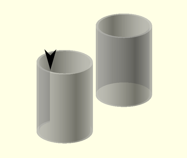

mikeonenine@web.de
Sun, Dec 7, 2025 8:32 PM
faces behind.
Strange behaviour:
translate([-80, 0, 0])
rotate([0, 0, $t*360])
rotate_extrude(angle=330)
translate([20, 0])
square([2, 60]);
You could be right!
