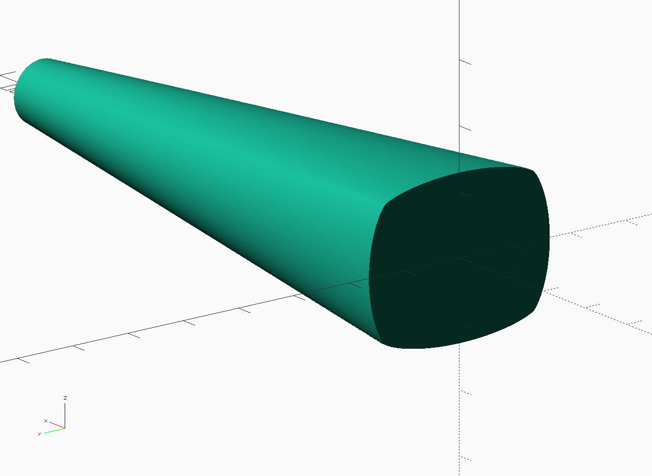

BTW I played with some linear sweeps of size and superellipse
roundness/squareness last night and got the attached out of some pretty
simple code. I should be able to use this to generate a vector
containing all of my body "slices", use a modified sweep function to
skin this as a polyhedron, but also then access the points data from
other code to generate spline control points for attaching tail/wings etc.
This one is going to be a long slog and I don't expect to have anything
close to printable for months!

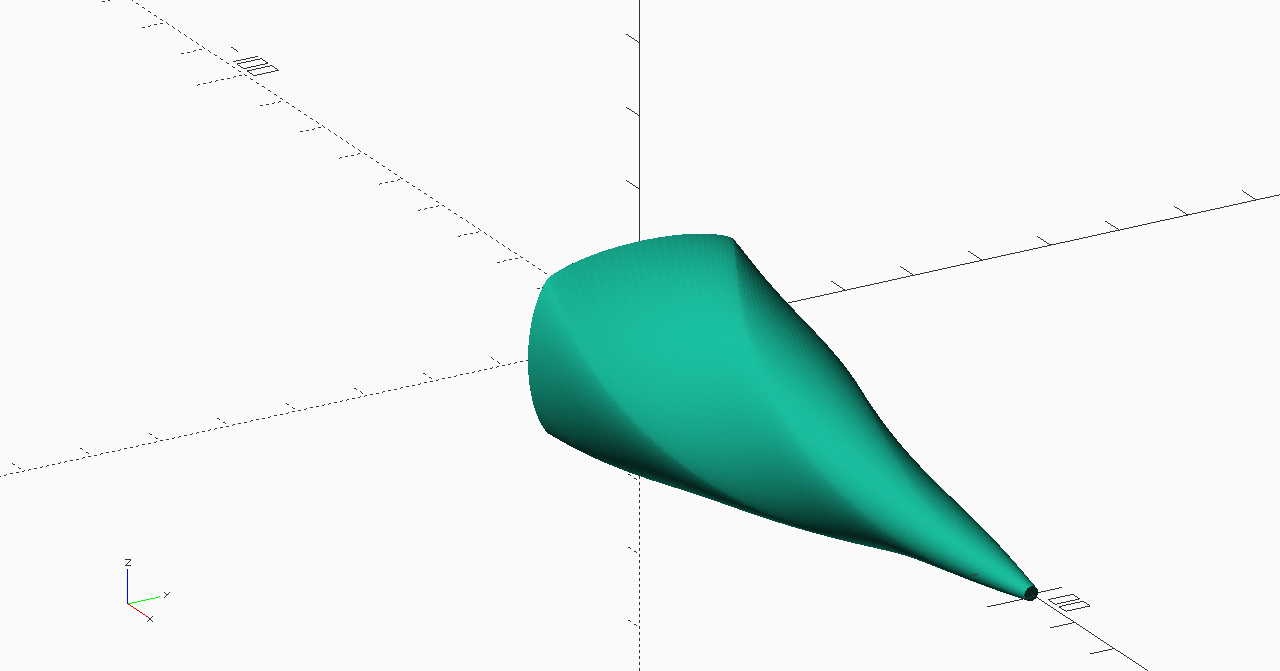

Here is what I have now as a proof of concept.
Rot45 = sin(45);
// Generate one slice of the body
function SESlice (SE=1, xs=1, ys=1) = [
for (t=[0: $fa : 359])
let (
x = pow(abs(cos(t)), 2/SE) * sign(cos(t)) ,
y = pow(abs(sin(t)), 2/SE) * sign(sin(t))
// Rotate 45 degrees so scaling works properly and then scale
[ xs * (x * Rot45 - y * Rot45), ys * (y * Rot45 + x * Rot45)]
BodySE=1.4;    // 1.4 is in the right ball park for centre
Steps = 100;
 skin([
     for (s=[0 : Steps-1])
         let (
             sf = s/(Steps-1),
             // Linear for now, needs a spline/lookup.
             SE = BodySE + sf*(2-BodySE),
             xs = 15 + sf*(1-15),
             ys = 19 + sf*(1-19)
         transform(translation([0,0,s]) * rotation([0,0,s*2]),
SESlice (SE=SE, xs=xs, ys=ys))
Output attached and shows scaling working well and superellipse going
from slightly rounded rectangle to circle. That's a lot of flexibility
from some pretty simple code, but I'm glad I didn't have to write skin()
or the transform library!
I'm not sure I need the unequal number of points logic and currently
have it ripped out of my "cut and paste" version of skin (). Let's see.
