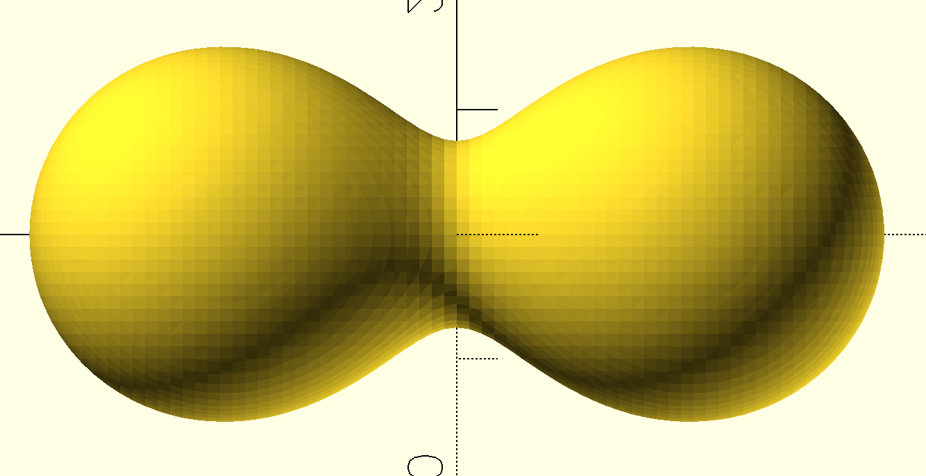

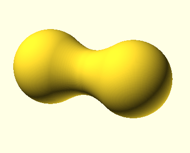

I'm sure that Adrian will be able to answer any questions about
join_prism(), but don't overlook BOSL2/isosurface.scad.
The shapes you describe are simple to do with metaballs().  They work
well for making organic shapes, although it will take some fiddling to
get the sizes exact.
In this sample, the influence argument adjusts the size of the neck.
include<BOSL2/std.scad>
include<BOSL2/isosurface.scad>
inf =.75;
spec =[
left(20), mb_sphere(d=25, influence=inf),
right(20), mb_sphere(d=25, influence=inf)
metaballs(spec, voxel_size=1,
bounding_box=[[-35,-15,-15], [35,15,15]], show_stats=true);
-- Richard

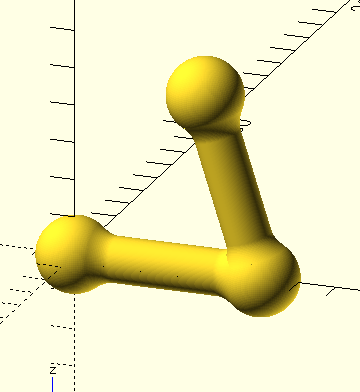

For organic shapes metaballs is definitely worth a look, like Richard
says.
If you want to pursue join_prism then I suggest you try with
prism_connector() instead.  The prism_connector() module is a pass-through
to join_prism().  It can't do everything that join_prism does, but for
the things it does do it's about ten times easier to use.  You will have to
come to terms with descriptions, but I think you'll find it's worth that
hurdle---making the direct join_prism() interface do the right thing can be
pretty painful.  Here's a connection from A->B->C.  See examples in the
wiki for some more sophisticated ways to do things like this.
sphere(r=10) let(first=parent())
right(50) sphere(r=10) let(second=parent())
up(47)left(15) sphere(r=10) let(third=parent())
prism_connector(circle(d=12),first, CENTER, second, CENTER, fillet=3);
prism_connector(circle(d=12),second, CENTER, third, CENTER, fillet=3);

right(20), mb_sphere(d=25, influence = inf)
bounding_box=[[-35,-15,-15], [35,15,15]], show_stats = true);
-- Richard

Adrian already gave another example but the prism_connector takes all the pain out of join_prism. It automatically adapts to the end points.
Some important points to remember.
– All parts must be in sequential indication, no ';' until the last module. All calls need to be stacked.
– You can save the 'current' parent geometry with sphere(r) let ( a = parent())
– If you want to connect two objects then best way is to use CTR. This will actually connect to the surface of the shape on a usually intuitive point. You can of course also use the LEFT, RIGHT, etc. or any unit vector if you want to exactly indicate the position on the surface.
– When you run into asserts, debug_pos=true is your friend
  • Make sure your profile/path parameter has enough points. A circle has many points so it can be plied gently on a sphere. A rect, however, has only 4 points and that cannot be plied to a sphere, it will look as if no smoothing was done. Subdivide the path (subdivide_path()) in more points so the function can interpolate better. (I made this error now 2 times and had to be saved by Adrian.)
    – You can also restore a geometry with restore(a), which makes the remaining calls as if they were called relative to whatever a was.
It is a fantastic function that allows you to do a lot of things without having to do trigonometry and it all adapts whenever you change a module. I use it nowadays all the time. I am actually trying to use this even if it is not perfectly applicable because it rounds so nicely. It is pretty magic when you get the hang of it.
Peter
$fn = $preview ? 30 : 200;
sphere(20)
let(a=parent())
xmove(50)
sphere(20)
prism_connector( circle(12), a, CTR, parent(), CTR, fillet=8)
