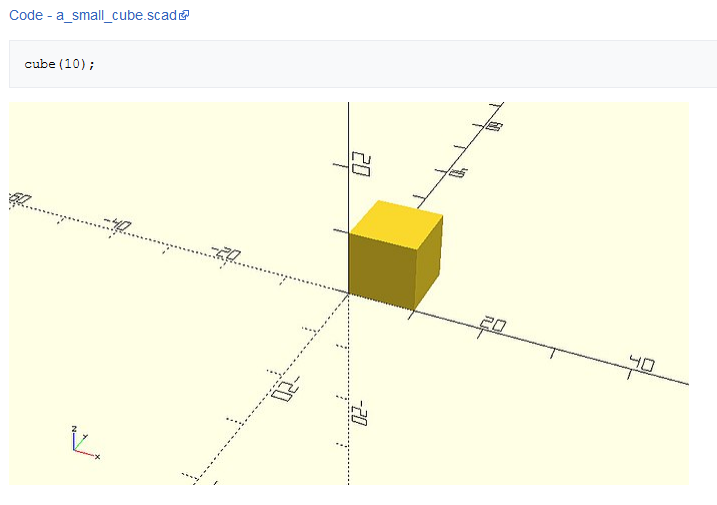

Here's a structure that is in some ways convenient.
I created a template {{User:Jordan Brown/sandbox/tmpl}}.  Its simplest
invocation is
{{User:Jordan Brown/sandbox/OpenSCADExample|name=a_small_cube}}
which generates:
You can see this live at
https://en.wikibooks.org/wiki/User:Jordan_Brown/sandbox/demo .
What it does, in this simple invocation, with a name FOO, is:
So the idea is that you put this simple reference into the main
document, and you create a page FOO with the OpenSCAD program, and an
image file FOO.jpg, and the template takes care of putting them
together into the preferred form.

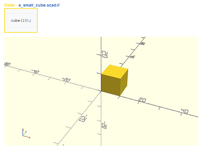

I also put together a slightly different template OpenSCADExample2,
that produces this, which I like a little better:
... but I'm not entirely happy with the title format.
The tricky part of this is in getting it to transclude a page
without processing any wikitext on that page, so that the FOO page
can contain precisely the OpenSCAD program, without needing any
protective markup.  The mechanism that I found, the "msgnw:" modifier,
seems to work but there are hints that there may be a few kinds of
wikitext that will still be processed.
Of course, this requires that the page containing the example, the
image, and the source file on github have the same name.  That could
be viewed as a limitation, or it could be viewed as a feature
encouraging structure.  The current implementation of the template
allows for specifying the name of the image separately, as img=BAR,
and allows specifying the content directly (instead of via another
page) as content=WHATEVER.  There could be a similar override for the
github link, but isn't yet.  The image type defaults to jpg, but can
be overridden with imgtype=XXX.
All of the details are easily changed, at least until we start using it.
Of course it would get put somewhere in the main template namespace,
not in my sandbox.
The key feature is that one template then controls the format of all
examples throughout the book.
