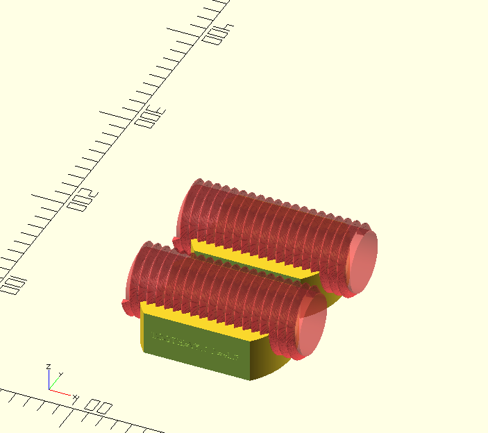

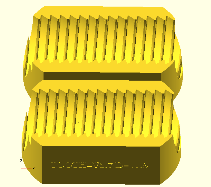

To give an idea how I generate the nuts, I first made a module for the
shape of the tooth. And extruded 7 point polygon. Tilted slightly to
match the pitch tilt.
Then I made a cylinder at the root diameter of a phantom bolt.
Then I used two for loops to wrap the tooth around the bolt at 1 degree
intervals, 180 degrees apart. Several turns extra
Then I added a clearance increase in the size, and rerendered the whole
thing, then subtracted that from the form that is the nut. You see that
"bolt" in red in this .png.
Knowing what my printer can do, this same procedure could model your
bolt, but I do not believe it would be printable using FDM tech like my
modified sapphire-5. A high res photo-resin printer might do it, sure
worth a try. I use PETG for this, but I've no clue as to the wearability
of the photo resins such a printer might use.
Cheers, Gene Heskett.

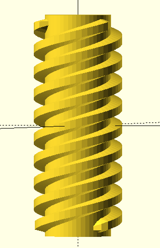

I never saw the original message, but if you need a multistart acme
threaded rod you could do that with BOSL2.  See
https://github.com/revarbat/BOSL2/wiki/threading.scad#module-acme_threaded_rod
I have printed functioning threads at 1/4-20 size, so 6mm diam and 1.3mm
pitch using my FDM prusa, though you wouldn't want to hang heavy weights
from such a printed bolt.  Printing a truncate bolt sideways may give a
stronger result.
include<BOSL2-fork/std.scad>
include<BOSL2-fork/threading.scad>
$fn=48;
acme_threaded_rod(length=20, d=8, pitch=2, starts=3);
stronger result.
$fn=48;

I'm printing quite usable 2 start 6mm tooth, 12mm pitch threads for a
buttress thread with a .4 nozzle but at 2" diameter that is easy, at
8mm
diameter for the screw you are are exceeding what the printer can do
well even with a .2mm nozzle. Because my design is 2 start, both half
nuts, printed face up, are identical. So I just do it twice in
OpenSCAD,
translating it for two locations on the printer bed.
