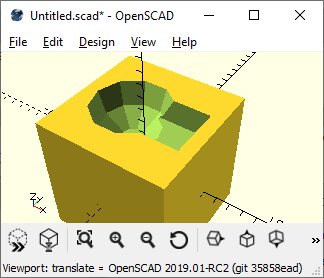

I need a quick sanity check.  Should it be OK to do
objectA();
	objectB();
	objectC();
or
objectA();
objectD();
where objectD itself is built via union()?

If b+c=d, then yes, they should be identical and should work just fine in openscad.

Of course.  You can difference (or intersect or union) any combination
of objects.
Fine print:  must all be 3D or all be 2D, must be legal objects
(manifold, et cetera).
Example:
    cube(10, center=true);
    union () {
        translate([-1, 0, 5]) sphere(3);
        translate([2, 0, 5]) cube(4, center=true);
