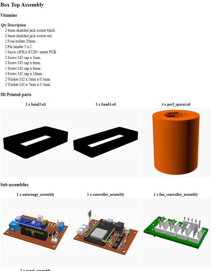

My library NopSCADlib allows STLs to be created automatically using some
Python scripts.
A module that creates an STL has to have a name suffixed by _stl and call
the library module st() with its own name. E.g.
module perf_spacer_stl()
stl("perf_spacer")
r = corrected_radius(screw_radius(perf_screw));
h = perf_gap;
cylinder(r = r + 1.7, h = h);
        poly_cylinder(r = r, h = h, center = false, twist = 2);
Then when it is called to make part of an assembly it will be added to the
bill of materials and running stls.py will create all the STLs for the
project. It also makes assembly instructions like this:

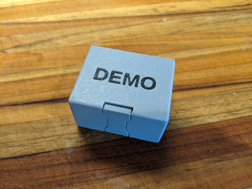

As an example I will use a configurable toolbox I am working on. The
boxes would hold things like socket wrench sets or impact driver bits. A
box type becomes a named configurator parameter set. The parameter set
controls the dimensions of the box, number of hinges and the artwork on
top. A drop down string variable controls which part is to be rendered
and the toplevel .scad file makes that happen with code like
 if (part == "bottom") ToolBoxBottom();
 if (part == "top") ToolBoxTop();
The Makefile defines the dependencies and the commands to run. So if I
only modify the source code for ToolBoxBottom, it will only create a new
bottom.stl file. If I modify the toplevel ToolBox.scad file, it will
recreate all stl files. The command for (re)creating the needed stl
files for my DEMO box (attached) is
 DESIGN=DEMO make
I would need to do some code cleanup before sharing the source code.
