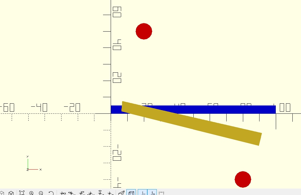

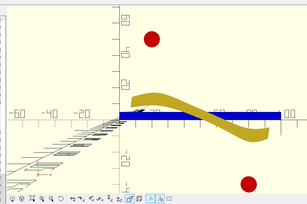

If considering 2d, (the sums are easier than 3d) if you have enough
points in a polygon, you can manipulate them in whatever fashion you want.
the blue is the original 'square'  (100 by 5)
the yellow is a list of 96 points points on the edge of the 'square'
manipulated by an inverse square of distance (sort of) from the two red
points.
If the same manipulation is applied to the original four points of the
square, then the following less interesting shape is obtained.
The manipulation is all within standard scad code, but the extra points
are generated elsewhere.
the values for the two points are  p1 = [20,50,30000];  p2 =
[80,-40,30000];
where 300000 is a value to represent the 'strength' of influence' which
is divided by the (distance of a point on the shape to the point of
influence) squared to get the new point position, but it could be
changed for other effects.

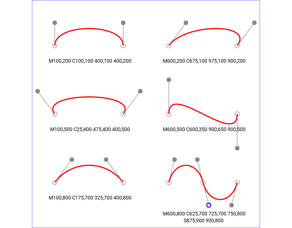

I tried reproducing cubic Bezier curves as given in W3C's specs for SVG
https://www.w3.org/TR/SVG/paths.html#PathDataCubicBezierCommands
The actual code is this:
https://www.w3.org/TR/SVG/images/paths/cubic02.svg
it looks like ths:
w3c svg cubic bezier examples

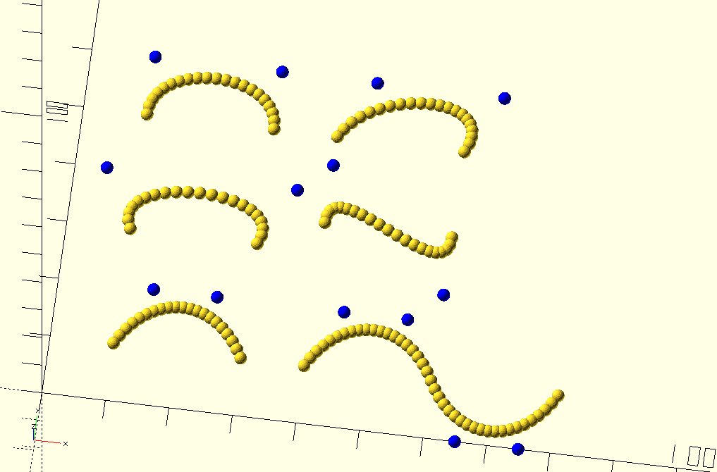

The openscad attempt looks like this:
openscad cubic bezier attempt
The point is if similar primitives can be provided say similar to the
SVG specs.
It would be easier to do things like this SVG to OpenSCAD Bezier
extension for Inkscape
https://www.thingiverse.com/thing:2805184
i.e. the curves (i.e. tuning of the control points) can be edited in
Inkscape and 'imported' into OpenSCAD.
While doing this attempt, I realized there is some 'secrets' for W3C's
SVG cubic bezier curves. They are actually 'locally referenced' at the
origin for the first control (end) point. The whole beizer curve is then
translated with this first control point (which is the origin) to the
desired position (i.e. the SVG coordinates for the 1st control point).
if you used the true absolute coordinates, for the bezier calculations
totally different Bezier curves are created.
For now the Inkscape extension i'd guess works, I've not tried it out
really. But that having a similar implementation makes it easier to
integrate the 'graphical' front end apps, with other inkscape scripts.
It'd certainly be more difficult I'd guess for Bezier surfaces
Cheers,
  Andrew
I've added the openscad script for making these Bezier curves at the end
of the message.
