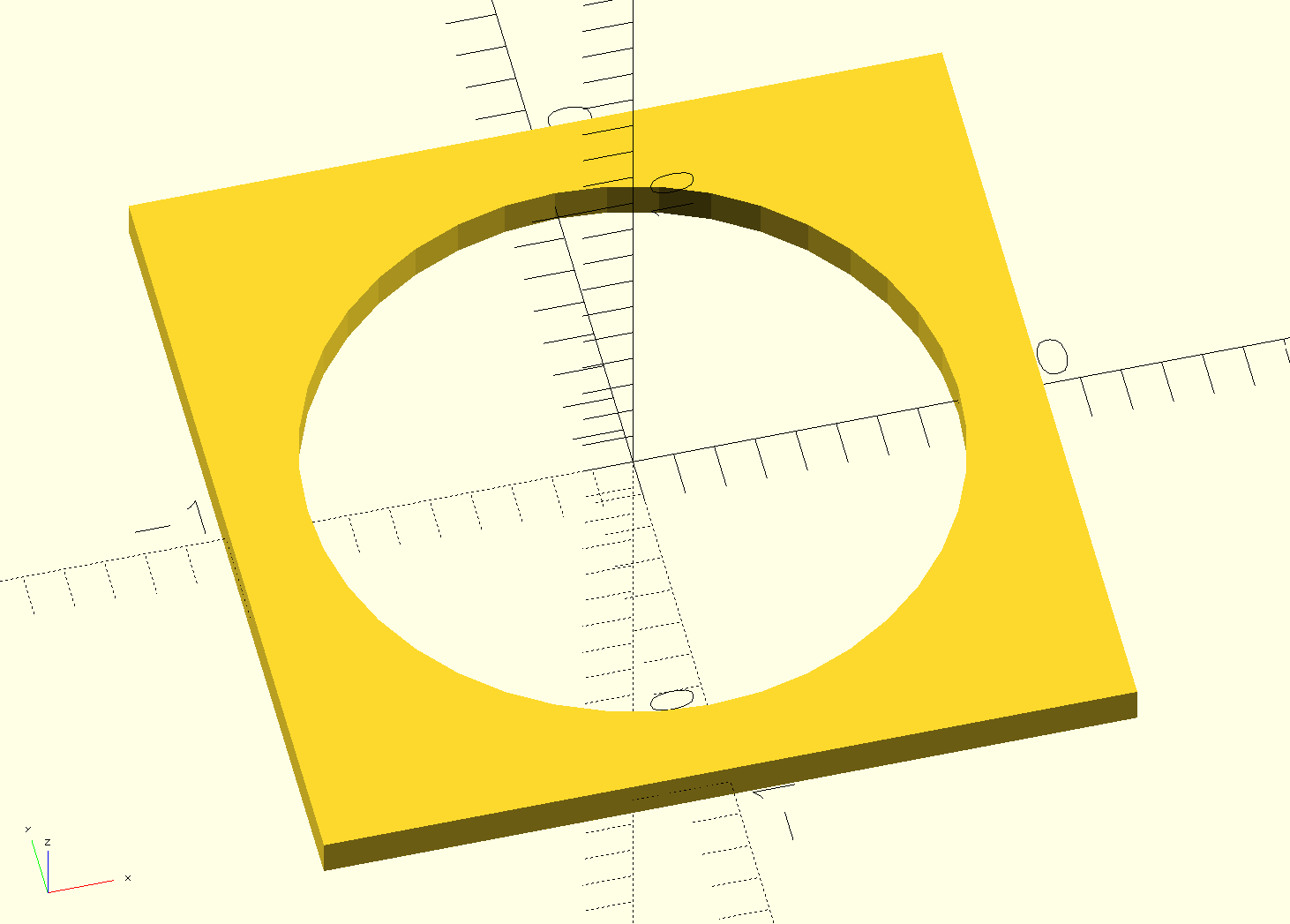

DP
Dan Perry
Sun, Dec 7, 2025 2:19 AM
s = square(20, center=true);
c = circle(r=8, $fn=40);
sh = difference(s, c);
region(sh);
