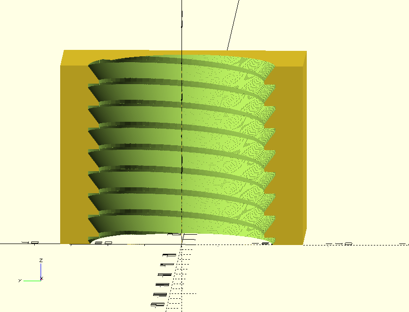

I finally got linear_extrude working. It was fat fingers triggering an
unwanted change in keyboard behavior from insert to overwrite.
So here are two pix from an F5 preview, one of the bolt and one of the
halfnut. Looks pretty solid 3d to me.
But hit F6 on either and get this in the log window in about 2 minutes:
Saved backup file: /home/gene/.local/share/OpenSCAD/backups/new-
buttress_vise_bolt_nut-backup-qQTWHGFE.scad
WARNING: [fast-csg] Corefinement corefinement mesh union #10019 failed
Rendering cancelled on first warning.
Bug?
code mistake?
I just now fixed it. I could see the z line laid separately from the base
of the tooth if I blew it up big enough. A translate([-.0005,0,0]) in
front of the rotate made it work. Now to see if it survives tipping the
tooth another 3.5 degrees. This gives a dead flat top to the tooth shape
on the high load face,but also warbles the x, putting a slight pattern
into the back slope of a buttress thread. It would be the ultimate fine
tuning if, rather than tipping the whole tooth, we could tip the basic
tooth shape ONLY on the Y axis, making the rectangle into a trapezoid,
then we could lay down a dead smooth surface on both sides of the
buttress thread.

The bolt renders in 1:50 on my Mac using 22.03.14 but throws a warning
WARNING: Object may not be a valid 2-manifold and may need repair!
You may have a gap between the thread and bolt infiltrated

As I thought setting the cylinder diameter slightly larger
cylinder(h=54.25,d=mdt+tal+0.01)
removes the 2d manifold issue and speeds up rendering 300%
When creating a union I never place two object adjacent to each other I always add a minuscule overlap.
Chuckle... You are observant. :) That gap is intentional and only for
display and fitting checking as its thread clearance. They will neveer be
printed together as you see them in that pix.
Works nicely since that thread is formed by rendering the bolt a tad
oversize (.25 mm) and using it as the difference to form the nuts
threads.  The bolt will be printed -.25mm undersized to verify the fit
but the final bolt in hard maple OTOH will be done by a 1/16" round nose
mill in a 4 axis milling machine I've heavily rebuilt, but should have
spent way more sheckles to buy something worth buying. Something with
500+ lbs of cast for a bed. Rigid, these alu extrusions used in the 6040
I think my translate X-.0005 does the same thing, in threadshape.
So do I, but I missed that one. Couldn't see that guilty gap until I had
blown the tooth up to fill the whole viewscreen.
