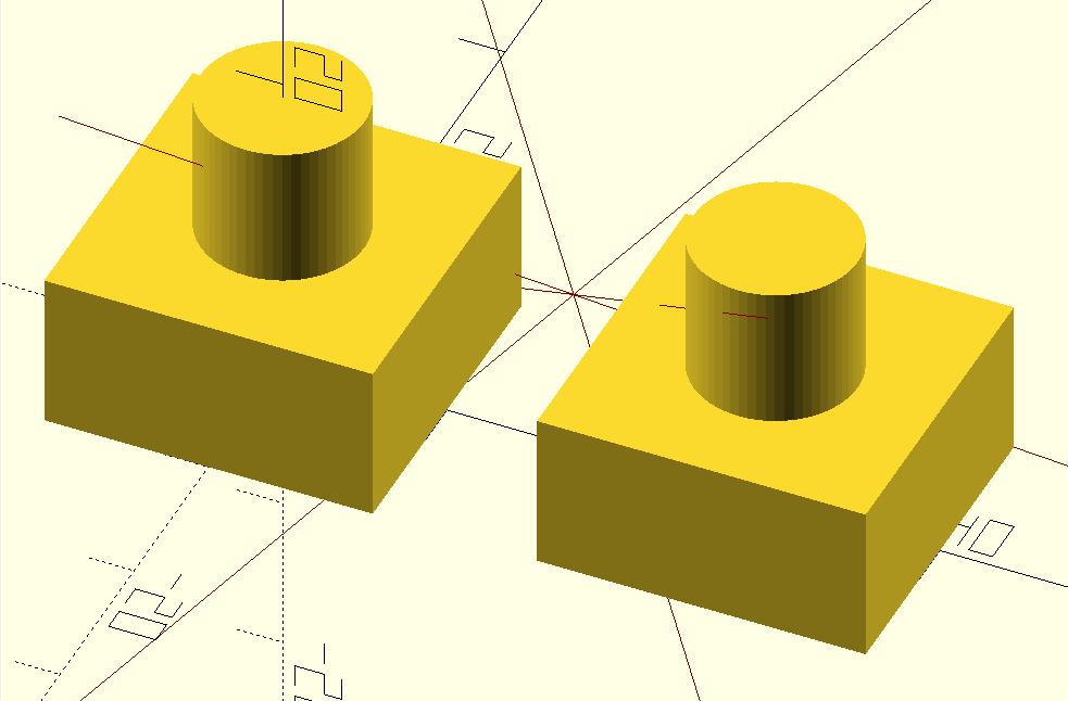

addSub(isAdding=true) unions. addSub(isAdding=false) differences. I should
have included a screenshot:
[image: Screenshot 2022-11-22 at 1.32.38 PM.png]

addSub(isAdding=true) unions. addSub(isAdding=false) differences. I should have included a screenshot: [image: Screenshot 2022-11-22 at 1.32.38 PM.png] You can do more interesting things with the child array. Here is something like a switch statement that uses integer cases: scale = 1.3; base = 4; rookH = base*0.8; bishopH = base; pawnH = base*scale; knightH = base*scale*scale; queenH = base*scale*scale*scale*scale; kingH = base*scale*scale*scale*scale*(1.15); // alias 'children' to make the meaning clear module switch(n)children([n]); module bothMirror(vec3){ children(); mirror(vec3)children(); } module frustum(h){ linear_extrude(height=h, scale=0.4) square([5,5], center=true); } module rook(){ frustum(rookH); translate([0, 0, 2*rookH])mirror([0, 0, 1])frustum(rookH); } module knight(){ frustum(knightH); translate([0, 0.4, 5.5])rotate([65, 0, 0])linear_extrude(height=4, scale=0.4) square([3,3], center=true); } module pawn()frustum(pawnH); module bishop(){ translate([0,0,bishopH])bothMirror([0,0,1])frustum(bishopH); } module queen(){ frustum(queenH); rotate([0, 0, 45])frustum(queenH); } module king()frustum(kingH); module pieces(){ for (i = [0:7]) { translate([i*8, -7, 0])pawn(); translate([i*8, 0, 0])switch(i){ // *this!* rook(); knight(); bishop(); queen(); king(); bishop(); knight(); rook(); } } } scale([3,3,3])pieces();

I did run it.  See attached. I'm running:
version 2021.01
Is there a different version I should be running?
