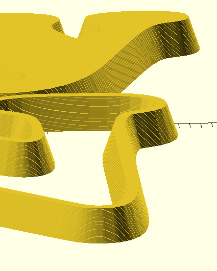

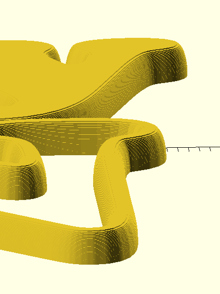

Every once in a while I need rounded raised text, and reinvent this.
What I've written below isn't truly general-purpose, but it's adaptable
to a number of needs.
And the actual application is seasonal.

or, with a different function:
This version is a little more general, accepting the profile function as
an explicit argument to offset_extrude().

For the bevel case you get a better result by using the roof() operator.
And from this there is a more or less stony path to calculate sloped
slices to get a better approximation ...
intersection()
scale([1,1,2])
roof(method = "straight", convexity=10)
D()
offset(.5)txt();
offset(-2)txt();
cube([400, 400, 3], center=true);
