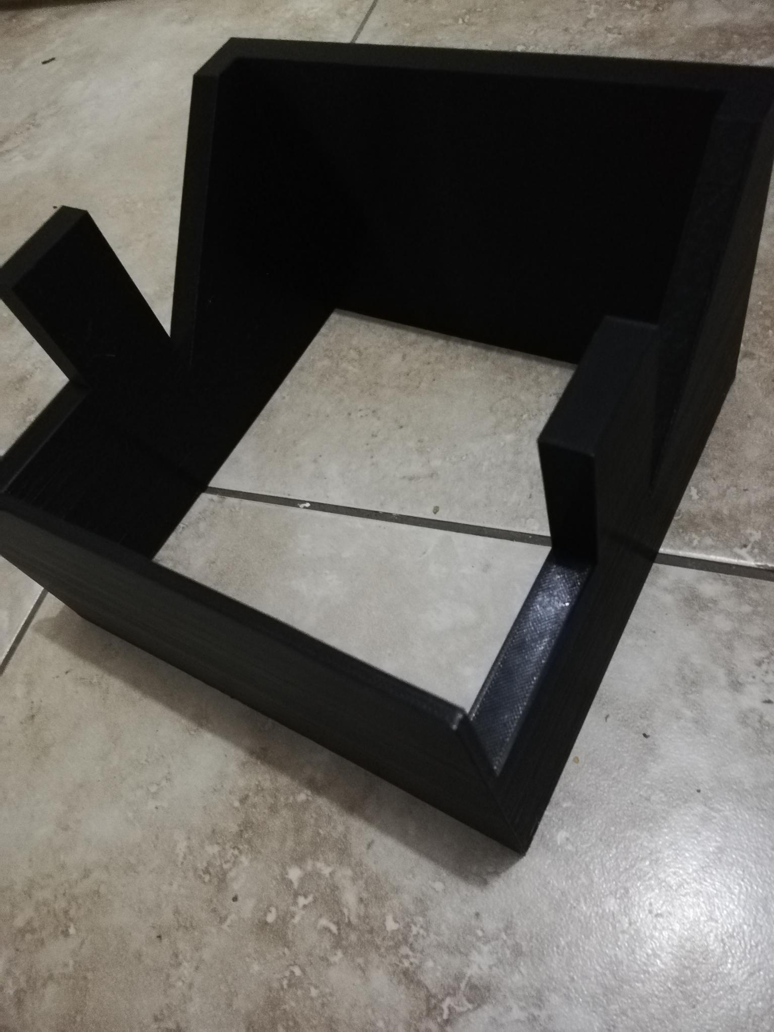

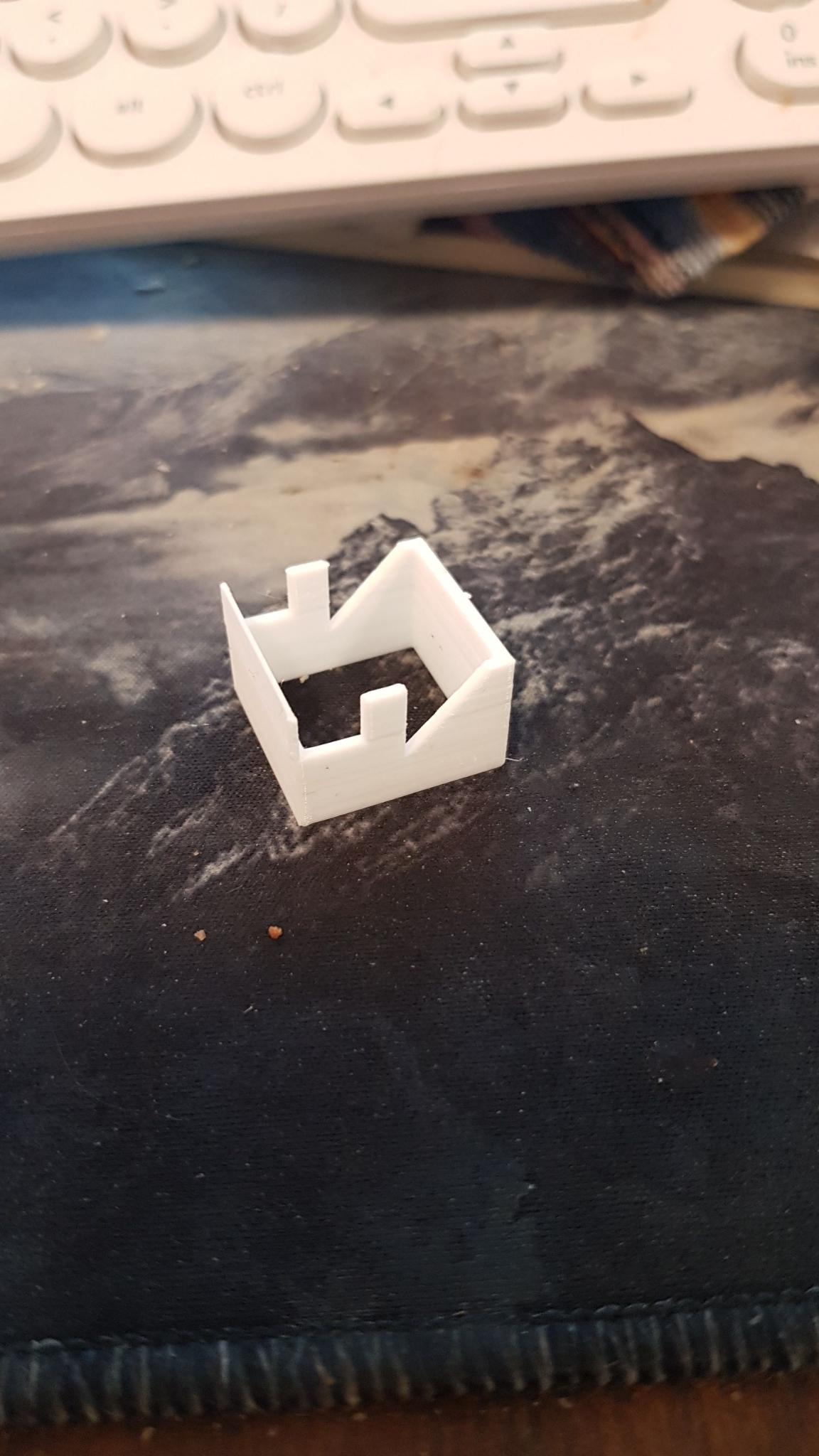

Please help. I cannot convert the above Openscad code to STL.
On trying it, I received the above blank page with the notice/warning below
it.
I read somewhere that it might be owing to the % I used, yet I
don't know how to fix it. The keyboard dimension (top of source code) is
the actual length for the artefact.
Here is the code in editable form -
https://pastebin.mozilla.org/wjo2V2xj
Entire code and grahics can be downloaded from here -
https://file.pizza/download/gt0tfawi

Error image, desired output and code screenshots are attached.
Kindly assist.
Thanks in advance.

Sat, Jan 8, 2022 1:51 AM
Final 3D print is ridiculously small. See attached. The length should be
about that of the keyboard beside it. I have changed values in the square
and cube. The difference in square values make the thickness. Given that I
want 7.2x12x7in, converting inch into mm and inserting the values (in the
square and cube functions) yielded the wrong outcome. The entire project
vanished in the .STL. Kindly assist.

DP
David Phillip Oster
Sat, Jan 8, 2022 2:29 AM
OpenSCAD's natural units are millimeters. STL files tend to use either
millimeters or inches. When I need to work in inches, I say:
function in(n) = 25.4 *n;
for example from Sanjeev Prabhakar's email:
resize([in(7.2),in(12),in(7)]) …
OpenSCAD's natural units are millimeters. STL files tend to use either millimeters or inches. When I need to work in inches, I say: function in(n) = 25.4 *n; for example from Sanjeev Prabhakar's email: resize([in(7.2),in(12),in(7)]) … On Fri, Jan 7, 2022 at 5:52 PM user user <user35b@gmail.com> wrote: > Attachment > > On Sat, Jan 8, 2022, 09:51 user user <user35b@gmail.com> wrote: > >> Final 3D print is ridiculously small. See attached. The length should be >>>> about that of the keyboard beside it. I have changed values in the square >>>> and cube. The difference in square values make the thickness. Given that I >>>> want 7.2x12x7in, converting inch into mm and inserting the values (in the >>>> square and cube functions) yielded the wrong outcome. The entire project >>>> vanished in the .STL. Kindly assist. >>> >>> >> _______________________________________________ > OpenSCAD mailing list > To unsubscribe send an email to discuss-leave@lists.openscad.org >
DG
David Gustavson
Sat, Jan 8, 2022 3:15 AM
STL files don't have and can't remember dimension units.
When you slice it, you'll have to specify the scale.
Often your slicer will default to something useful, but if you want inches and it thinks you want millimeters, you get very tiny objects.
David Gustavson
dbg@scizzl.com
On Fri, Jan 7, 2022 at 5:52 PM user user user35b@gmail.com wrote:
On Sat, Jan 8, 2022, 09:51 user user user35b@gmail.com wrote:
Final 3D print is ridiculously small. See attached. The length should be about that of the keyboard beside it. I have changed values in the square and cube. The difference in square values make the thickness. Given that I want 7.2x12x7in, converting inch into mm and inserting the values (in the square and cube functions) yielded the wrong outcome. The entire project vanished in the .STL. Kindly assist.
STL files don't have and can't remember dimension units. When you slice it, you'll have to specify the scale. Often your slicer will default to something useful, but if you want inches and it thinks you want millimeters, you get very tiny objects. -- David Gustavson dbg@scizzl.com On Fri, Jan 7, 2022, at 6:29 PM, David Phillip Oster wrote: > OpenSCAD's natural units are millimeters. STL files tend to use either millimeters or inches. When I need to work in inches, I say: > > function in(n) = 25.4 *n; > > > > for example from Sanjeev Prabhakar's email: > > > resize([in(7.2),in(12),in(7)]) … > > > > On Fri, Jan 7, 2022 at 5:52 PM user user <user35b@gmail.com> wrote: >> Attachment >> >> On Sat, Jan 8, 2022, 09:51 user user <user35b@gmail.com> wrote: >>>>> Final 3D print is ridiculously small. See attached. The length should be about that of the keyboard beside it. I have changed values in the square and cube. The difference in square values make the thickness. Given that I want 7.2x12x7in, converting inch into mm and inserting the values (in the square and cube functions) yielded the wrong outcome. The entire project vanished in the .STL. Kindly assist. >>> >>>>> >> _______________________________________________ >> OpenSCAD mailing list >> To unsubscribe send an email to discuss-leave@lists.openscad.org > _______________________________________________ > OpenSCAD mailing list > To unsubscribe send an email to discuss-leave@lists.openscad.org >
DP
David Phillip Oster
Sat, Jan 8, 2022 3:18 AM
David Gustavson's explanation is better than mine. When you slice for a 3D
printer, you can set the scale.
David Gustavson
dbg@scizzl.com

Thu, Feb 10, 2022 1:34 PM
Print is out. Hardware perfectly fits in after resizing. Thanks to everyone.
