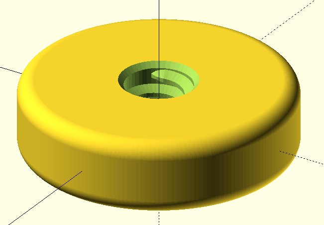

I tried the original code in the dev version and it finishes preview in 55s
on my machine.  But even if you want to wait you have another problem:  it
destroys the screw threads:

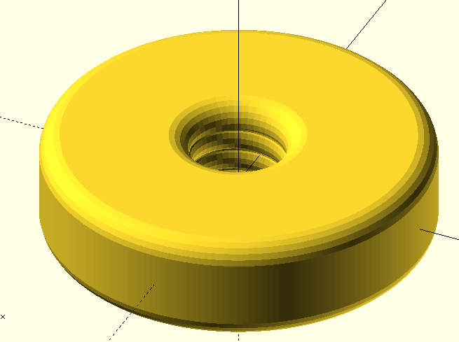

You can add a bevel to the screw hole, but not a rounding, though if you
use radius 1.5 it doesn't leave much thread on a 7mm hole.
diff()
cyl(d=25,h=7,rounding=1.5)
tag ("remove") screw_hole("M6x1.5,7.01",anchor=CENTER,
thread=true,bevel=0.5);

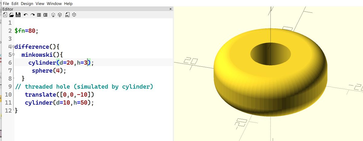

This is quick enough. (not bothered with OP dimensions, nor thread)
