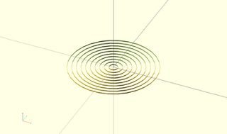

Does OpenSCAD have the capability to produce simple shape outlines vs a filled-in shape?
I need to create a model that contains multiple concentric circles that I can export as an SVG or DXF file?
If  I do:
for (i=[1:1:10]) {
circle(d=I\*10) ;
All I see is a 100mm circle.  The other 9 are lost under the larger one.
Is such doable in OpenSCAD or must I look for another program?
Mike
Does OpenSCAD have the capability to produce simple shape outlines vs a filled-in shape? I need to create a model that contains multiple concentric circles that I can export as an SVG or DXF file? If I do: for (i=\[1:1:10\]) { circle(d=I\*10) ; } All I see is a 100mm circle. The other 9 are lost under the larger one. Is such doable in OpenSCAD or must I look for another program? Mike

Primitive shapes are filled in. If you just want the outline, create a difference with a slightly smaller shape.
for (i=[1:1:10])
circle(d=i10) ;
offset(-0.1)
circle(d=i
10) ;
Primitive shapes are filled in. If you just want the outline, create a difference with a slightly smaller shape. > for (i=[1:1:10]) > { > difference() > { > circle(d=i*10) ; > offset(-0.1) > circle(d=i*10) ; > } > }

Use difference() !
for (i=[1:2:10])
        circle(d=(i+1)*10) ;
        circle(d=(i)*10) ;

Use difference() ! for (i=[1:2:10]) {     difference()     {         circle(d=(i+1)*10) ;         circle(d=(i)*10) ;     } } Am 12.12.24 um 16:53 schrieb mike.fraser.1945+osc--- via Discuss: > > Does OpenSCAD have the capability to produce simple shape outlines vs > a filled-in shape? > > I need to create a model that contains multiple concentric circles > that I can export as an SVG or DXF file? > > If //I do: > > for (i=[1:1:10]) { > > circle(d=I*10) ; > > } > > All I see is a 100mm circle. The other 9 are lost under the larger one. > > Is such doable in OpenSCAD or must I look for another program? > > Mike > > > _______________________________________________ > OpenSCAD mailing list > To unsubscribe send an email todiscuss-leave@lists.openscad.org

No.  As others have said, you can make a 2D donut - formally, an annulus
(yes, I had to look it up) - by differencing circles, but that's not an
outline per se.
OpenSCAD has only solid shapes - filled-in polygons in 2D, and filled-in
polyhedra in 3D.  (Incomplete polyhedra excepted; they don't really work
with the operators.)
