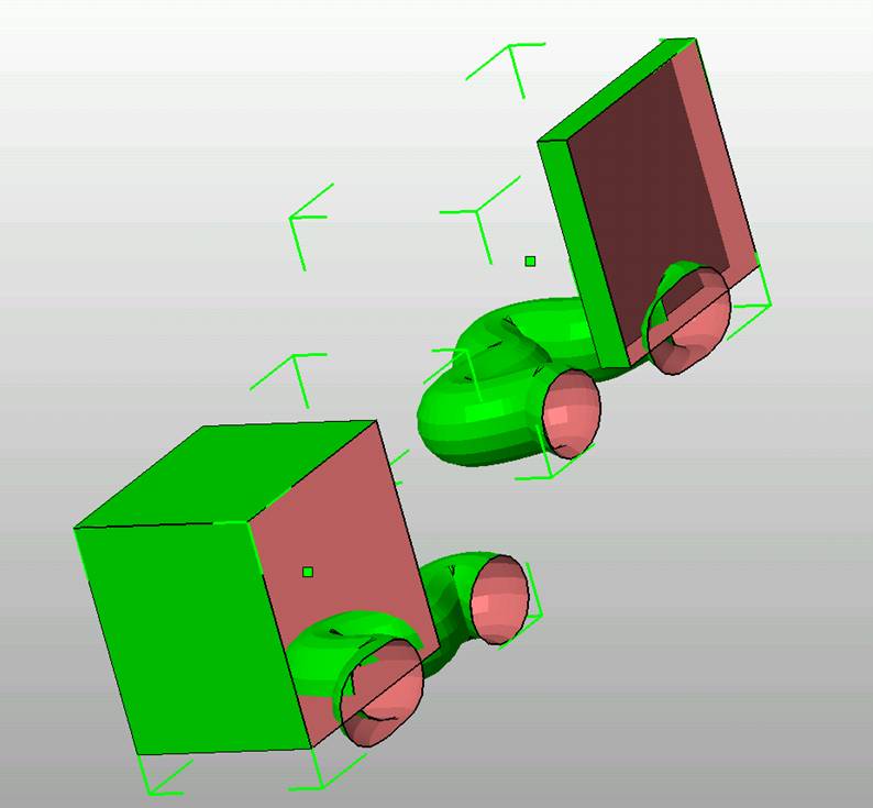

What happens with lazy union if you don't union the top level items?
It does not do CSG so all top level objects are fully present.
i.e Cut in half to see internals.
With a union() the cube would be empty, and cube bits would not be inside the sweep'ed part.

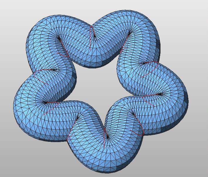

BTW, the sweep has self-intersections.

I didn't even think of possible lazy union here.  I know that lazy union is
enabled for my RC---I previously tested this.  And yes, I did turn it on in
a snapshot, so that seems to explain why.
I wrapped with a union() and then I get a CGAL error as expected.

Did you use a snapshot to test Lazy-Union?
Wrap the path_sweep & cube in a union.

I wrote the code below to help a user on another thread, but I noticed a
weird thing.  With the parameters below, the sweep gives a bad polyhedron
with self-intersections.  And yet, with the RC I do not get a CGAL error,
at
least under Linux.  With 2019.05 I do get a CGAL error, but under the
RC:

Yep with Lazy union, multiple top level objects can be exported.  Whether
they are disjoint or not, it's up to the user (or slicer, as it may be) to
deal with.
Honestly, I'm not sure how well various slicers handle overlapping objects,
ie if they properly union the results themselves, or could possibly
generate overlapping toolpaths which "double extrude", or force each object
to be arranged separately on the build plate.

Yep with Lazy union, multiple top level objects can be exported. Whether they are disjoint or not, it's up to the user (or slicer, as it may be) to deal with. Honestly, I'm not sure how well various slicers handle overlapping objects, ie if they properly union the results themselves, or could possibly generate overlapping toolpaths which "double extrude", or force each object to be arranged separately on the build plate. By the way, the lines from your console output are a dead giveaway that lazy union is enabled: Top level object is a list of objects: Objects: 2 That "list of objects" is only possible with lazy union. On Fri, Dec 11, 2020 at 9:58 PM MichaelAtOz <oz.at.michael@gmail.com> wrote: > > What happens with lazy union if you don't union the top level items? > > > > It does not do CSG so all top level objects are fully present. > > > > i.e Cut in half to see internals. > > > > > > With a union() the cube would be empty, and cube bits would not be inside > the sweep'ed part. > > > > BTW, the sweep has self-intersections. > > > > > > > > > > > > > > > -----Original Message----- > > > From: Adrian Mariano [mailto:radian@cox.net] > > > Sent: Sat, 12 Dec 2020 14:47 > > > To: MichaelAtOz > > > Subject: Re: [OpenSCAD] 2020.12-RC2 bogus model does not give CGAL error > > > > > > STL attached. > > > > > > It seems like a big gotcha for lazy union if forgetting to wrap your > > > top level in union() results in a bad STL output without a warning. > > > > > > On Sat, Dec 12, 2020 at 02:39:46PM +1100, MichaelAtOz wrote: > > > > (not posted to mailing-list) > > > > > > > > Adrian, > > > > > > > > Send me the STL if you want me to have a look at it. > > > > > > > > Michael > > > > > > > > > -----Original Message----- > > > > > From: Discuss [mailto:discuss-bounces@lists.openscad.org] On Behalf > Of adrianv > > > > > Sent: Sat, 12 Dec 2020 14:25 > > > > > To: discuss@lists.openscad.org > > > > > Subject: Re: [OpenSCAD] 2020.12-RC2 bogus model does not give CGAL > error > > > > > > > > > > I didn't even think of possible lazy union here. I know that lazy > union is > > > > > enabled for my RC---I previously tested this. And yes, I did turn > it on in > > > > > a snapshot, so that seems to explain why. > > > > > > > > > > I wrapped with a union() and then I get a CGAL error as expected. > > > > > > > > > > What happens with lazy union if you don't union the top level > items? I took > > > > > my bad (?) file (without the top level union) and saved an STL and > my slicer > > > > > seemed happy. (But I don't have the various mesh analysis tools > everybody > > > > > uses to figure out just how bad the STL might be. Maybe PrusaSlicer > is > > > > > really good at repairing/interpreting bad inputs.) > > > > > > > > > > > > > > > MichaelAtOz wrote > > > > > > Windows 7, I get CGAL errors on both 2019.05 & RC2. > > > > > > > > > > > > I get different console output. > > > > > > On 2019.05, similar to Adrian's, but with the CGAL error after > 'Rendering > > > > > > Polygon Mesh using > > > > > > CGAL...'. > > > > > > > > > > > > RC2 is truncated: > > > > > > > > > > > > Parsing design (AST generation)... > > > > > > Compiling design (CSG Tree generation)... > > > > > > Rendering Polygon Mesh using CGAL... > > > > > > ERROR: CGAL error in CGALUtils::applyUnion3D: CGAL ERROR: assertion > > > > > > violation! Expr: > > > > > > G.mark(v1,0)==G.mark(v2,0)&& G.mark(v1,1)==G.mark(v2,1) File: > > > > > > > /mxe/usr/x86_64-w64-mingw32.static.posix/include/CGAL/Nef_S2/SM_overlayer.h > > > > > > Line: 303, location > > > > > > unknown > > > > > > UI-WARNING: No top level geometry to render location unknown > > > > > > > > > > > > i.e no cache stats or time. > > > > > > > > > > > > Adrian, see https://github.com/openscad/openscad/issues/3517 > > > > > > Did you use a snapshot to test Lazy-Union? > > > > > > > > > > > > Wrap the path_sweep & cube in a union. > > > > > > > > > > > >> -----Original Message----- > > > > > >> From: Discuss [mailto: > > > > > > > > > > > discuss-bounces@.openscad > > > > > > > > > > > ] On Behalf Of adrianv > > > > > >> Sent: Sat, 12 Dec 2020 12:00 > > > > > >> To: > > > > > > > > > > > discuss@.openscad > > > > > > > > > > >> Subject: [OpenSCAD] 2020.12-RC2 bogus model does not give CGAL > error > > > > > >> > > > > > >> I wrote the code below to help a user on another thread, but I > noticed a > > > > > >> weird thing. With the parameters below, the sweep gives a bad > polyhedron > > > > > >> with self-intersections. And yet, with the RC I do not get a > CGAL error, > > > > > >> at > > > > > >> least under Linux. With 2019.05 I do get a CGAL error, but > under the > > > > > >> RC: > > > > > >> > > > > > >> Parsing design (AST generation)... > > > > > >> Compiling design (CSG Tree generation)... > > > > > >> Rendering Polygon Mesh using CGAL... > > > > > >> Geometries in cache: 7 > > > > > >> Geometry cache size in bytes: 1662680 > > > > > >> CGAL Polyhedrons in cache: 0 > > > > > >> CGAL cache size in bytes: 0 > > > > > >> Total rendering time: 0:00:00.582 > > > > > >> Top level object is a list of objects: > > > > > >> Objects: 2 > > > > > >> Rendering finished. > > > > > >> > > > > > >> > > > > > >> include&lt;BOSL2/std.scad&gt; > > > > > >> include&lt;BOSL2/skin.scad&gt; > > > > > >> > > > > > >> $fn=16; > > > > > >> ofs = 1; > > > > > >> r=4; > > > > > >> number=5; > > > > > >> radius=1.4; > > > > > >> > > > > > >> path = [for(i=[0:2:359]) (r+ofs*sin(number*i))*[cos(i),sin(i)]]; > > > > > >> path_sweep(circle(r=radius), path, closed=true); > > > > > >> cube(8); > > > > > >> > > > > > >> > > > > > >> I've also noticed that the RC doesn't always print blank lines > before > > > > > >> starting a new computation, which can make it hard to read the > output. > > > > > >> > > > > > >> > > > > > >> > > > > > >> > > > > > >> -- > > > > > >> Sent from: http://forum.openscad.org/ > > > > > >> > > > > > >> _______________________________________________ > > > > > >> OpenSCAD mailing list > > > > > >> > > > > > > > > > > > Discuss@.openscad > > > > > > > > > > >> > http://lists.openscad.org/mailman/listinfo/discuss_lists.openscad.org > > > > > > > > > > > > > > > > > > -- > > > > > > This email has been checked for viruses by AVG. > > > > > > https://www.avg.com > > > > > > > > > > > > > > > > > > _______________________________________________ > > > > > > OpenSCAD mailing list > > > > > > > > > > > Discuss@.openscad > > > > > > > > > > > > http://lists.openscad.org/mailman/listinfo/discuss_lists.openscad.org > > > > > > > > > > > > > > > > > > > > > > > > > > > > > > -- > > > > > Sent from: http://forum.openscad.org/ > > > > > > > > > > _______________________________________________ > > > > > OpenSCAD mailing list > > > > > Discuss@lists.openscad.org > > > > > > http://lists.openscad.org/mailman/listinfo/discuss_lists.openscad.org > > > > > > > > > > > > -- > > > > This email has been checked for viruses by AVG. > > > > https://www.avg.com > > > <http://www.avg.com/email-signature?utm_medium=email&utm_source=link&utm_campaign=sig-email&utm_content=emailclient> Virus-free. > www.avg.com > <http://www.avg.com/email-signature?utm_medium=email&utm_source=link&utm_campaign=sig-email&utm_content=emailclient> > <#m_2570480591202271868_DAB4FAD8-2DD7-40BB-A1B8-4E2AA1F9FDF2> > _______________________________________________ > OpenSCAD mailing list > Discuss@lists.openscad.org > http://lists.openscad.org/mailman/listinfo/discuss_lists.openscad.org >
Sat, Dec 12, 2020 9:12 AM
Skeinforge XORs them so you end up with unexpected voids where they overlap.
I don't think OpenSCAD should export STLs with overlapping volumes.
'Rendering
Polygon Mesh using
CGAL...'.
RC2 is truncated:
assertion
violation! Expr:
Line: 303, location
unknown
noticed a
polyhedron
CGAL error,
at
under the
RC:
Objects:    2
Rendering finished.
include<BOSL2/std.scad>
include<BOSL2/skin.scad>
$fn=16;
ofs = 1;
r=4;
number=5;
radius=1.4;
path = [for(i=[0:2:359]) (r+ofssin(numberi))*[cos(i),sin(i)]];
cube(8);
