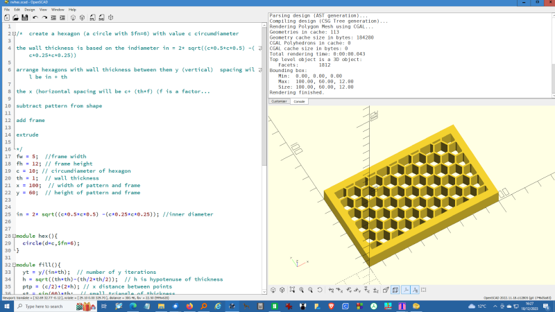

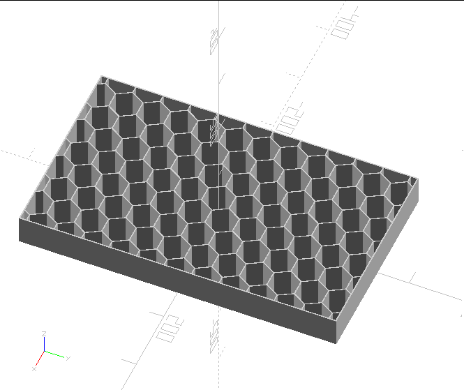

hello!
Once again something that looked fairly simple in the start got to a huge
headache....
i hope the attachment goes through, there you can see my actual tries to
get this working....
it started by wanting to remix a nice fountain found on thingieverse, but
where the sizes were just so wrong for me that my available pump didn't fit
into it....
So I needed some slanted outer walls, and pierced inner walls, since the
theme was hexagons, I did everything in hexagons.....
I started by using cubes, but the slanting didn't go too well.... so I
started with a polygon, but the need for a splash guard on certain walls
arose .... so  I went polyhedron.....
i noticed that my polyhedron had some funny features depending on the angle
looking onto it, but on compiling it didn't complain AFAIK.....
for the hole i still tried to go 2D first, with a lot of pain to my old
brain, i finally managed to get a centered and working hex grid....
extruded it and diffed it with the polyhedron, and now it looks frankly
weird..... nearly all of the polyhedron is gone and compiling well i get
the dreaded mesh is not closed.....
integrating the hexes directly into the polyhedron will be a major pain
considering my incompetence...  So if someone might be kind enough to point
out what I did wrong?
ciao
Bruno

hello! Once again something that looked fairly simple in the start got to a huge headache.... i hope the attachment goes through, there you can see my actual tries to get this working.... it started by wanting to remix a nice fountain found on thingieverse, but where the sizes were just so wrong for me that my available pump didn't fit into it.... So I needed some slanted outer walls, and pierced inner walls, since the theme was hexagons, I did everything in hexagons..... I started by using cubes, but the slanting didn't go too well.... so I started with a polygon, but the need for a splash guard on certain walls arose .... so I went polyhedron..... i noticed that my polyhedron had some funny features depending on the angle looking onto it, but on compiling it didn't complain AFAIK..... for the hole i still tried to go 2D first, with a lot of pain to my old brain, i finally managed to get a centered and working hex grid.... extruded it and diffed it with the polyhedron, and now it looks frankly weird..... nearly all of the polyhedron is gone and compiling well i get the dreaded mesh is not closed..... integrating the hexes directly into the polyhedron will be a major pain considering my incompetence... So if someone might be kind enough to point out what I did wrong? -- ciao Bruno =========================================== http://nohkumado.eu/, <http://bboett.free.fr>http://aikido.nohkumado.eu/, <http://bboett.free.fr> http://aikido.zorn.free.fr
Mon, Dec 18, 2023 1:51 AM
if you press f12, it shows the top face turns "magenta", that means it is
not closed.
You need to check that

if you press f12, it shows the top face turns "magenta", that means it is not closed. You need to check that On Mon, 18 Dec 2023 at 03:35, Bruno Boettcher via Discuss < discuss@lists.openscad.org> wrote: > hello! > Once again something that looked fairly simple in the start got to a huge > headache.... > > i hope the attachment goes through, there you can see my actual tries to > get this working.... > it started by wanting to remix a nice fountain found on thingieverse, but > where the sizes were just so wrong for me that my available pump didn't fit > into it.... > > So I needed some slanted outer walls, and pierced inner walls, since the > theme was hexagons, I did everything in hexagons..... > > I started by using cubes, but the slanting didn't go too well.... so I > started with a polygon, but the need for a splash guard on certain walls > arose .... so I went polyhedron..... > > i noticed that my polyhedron had some funny features depending on the > angle looking onto it, but on compiling it didn't complain AFAIK..... > > for the hole i still tried to go 2D first, with a lot of pain to my old > brain, i finally managed to get a centered and working hex grid.... > extruded it and diffed it with the polyhedron, and now it looks frankly > weird..... nearly all of the polyhedron is gone and compiling well i get > the dreaded mesh is not closed..... > > integrating the hexes directly into the polyhedron will be a major pain > considering my incompetence... So if someone might be kind enough to point > out what I did wrong? > > -- > ciao > Bruno > > =========================================== > http://nohkumado.eu/, <http://bboett.free.fr>http://aikido.nohkumado.eu/, > <http://bboett.free.fr> > http://aikido.zorn.free.fr > _______________________________________________ > OpenSCAD mailing list > To unsubscribe send an email to discuss-leave@lists.openscad.org >
Mon, Dec 18, 2023 2:11 AM

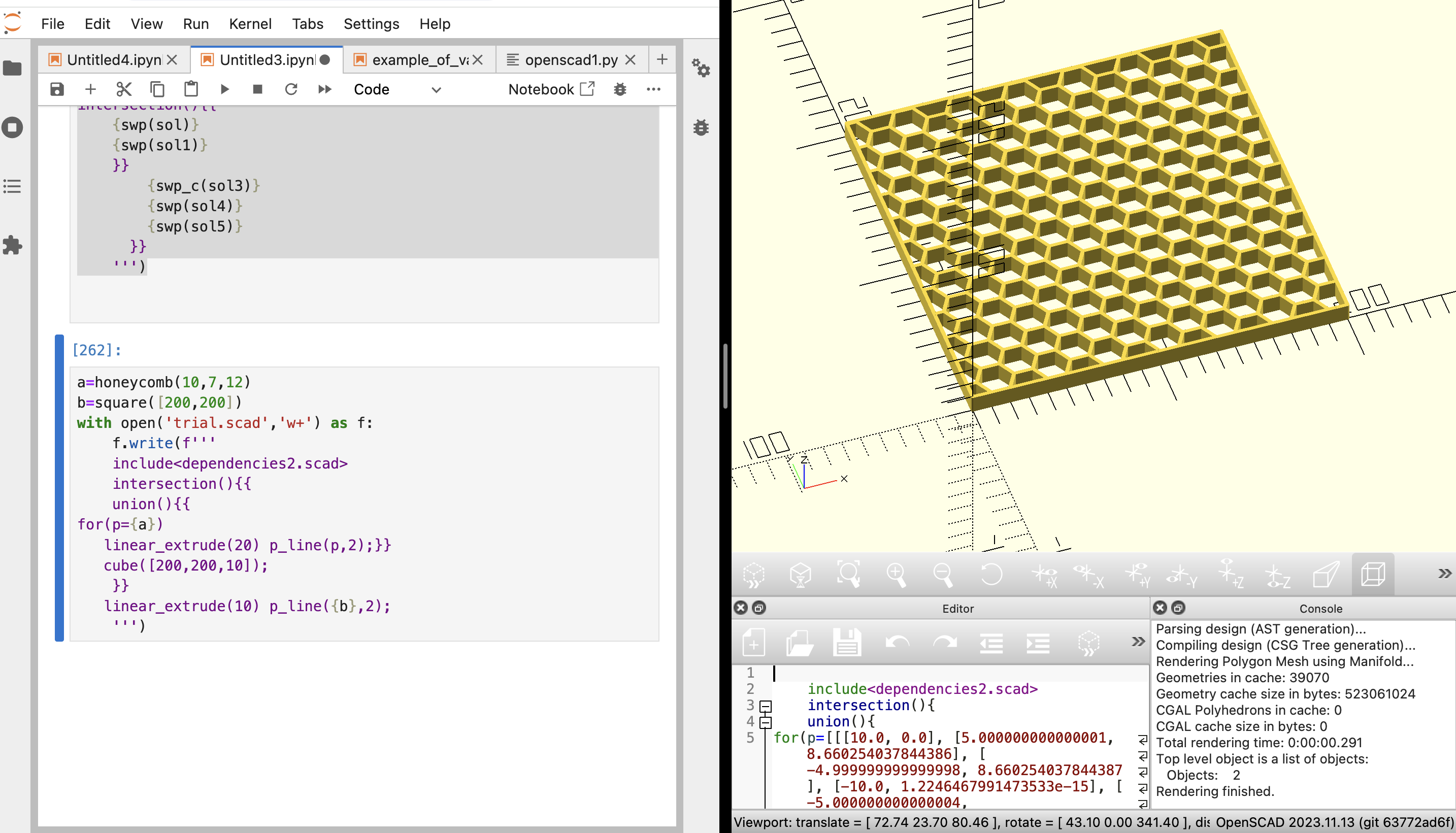

Is this you are looking for?
[image: Screenshot 2023-12-18 at 7.38.57 AM.png]
python code for the same is in the left window
For those that don't want python extensions, the honeycomb pattern in  pure OpenSCAD. // Parameters blockX = 300; blockY = 500; blockZ = 50; WallThickness = 2; cellSize = 50;             // cell diameter measured from vertex to opposite vertex (when wall has zero thickness). // Derived values used for construction dHex = cellSize * sin(60);    // distance between cell centres tileX = 2 * dHex * sin(60);   // honeycomb repetition distance in X tileY = 2 * dHex;              // honeycomb repetition distance in Y // 2D honeycomb is made by repeating these 2D rectangular tiles module tile() {    difference() {       square([tileX, tileY], center = true);       for(i = [30 : 60 : 330]) translate([dHex * cos(i), dHex * sin(i)]) circle(d = cellSize - WallThickness, $fn = 6);       circle(d = cellSize - WallThickness, $fn = 6);    } } // lay out enough tiles for size of block then crop to exact size and extrude to desired block height linear_extrude(blockZ) intersection() {    rows = ceil(blockY / tileY);    columns = ceil(blockX / tileX);    for(a = [-columns / 2 : columns / 2]) for (b = [-rows / 2 : rows / 2]) translate([a * tileX, b * tileY]) tile();    square([blockX - 2 * WallThickness, blockY - 2 * WallThickness], center = true); } // add block wall linear_extrude(blockZ) difference() {    square([blockX, blockY], center = true);    square([blockX - 2 * WallThickness, blockY - 2 * WallThickness], center = true); } On 2023-12-17 6:11 p.m., Sanjeev Prabhakar via Discuss wrote: > Is this you are looking for? > Screenshot 2023-12-18 at 7.38.57 AM.png > > python code for the same is in the left window
GB
Glenn Butcher
Mon, Dec 18, 2023 1:36 PM
This!
I've been using $fn=6 cylinders to make hex bolt heads for some time
now, works like a treat.  Y'know, sometimes that flatblade screwdriver
makes a great pry bar...   :D

Here's  my attempt, code attached below. .
Best wishes,
Ray

Today, Ray and I both posted code to make a honeycomb / hex grid. Ray's
approach is to simply subtract a load of hexagons from the required
area. Somehow my thought process took me down the route of defining a
module that creates a rectangular tile represents the basic repeat
pattern, and then I Iay down a bunch of my tiles.
It turns out that Ray's code renders much faster than mine. I suspect
the difference is that my version is repeatedly using a module, and
perhaps the module calculations are being repeated over and over, each
time producing an identical object That would certainly slow things down.
I have very little understanding of how OpenSCAD works internally but I
visualize it as using some kind of a hierarchic tree of objects. I did
not realize my module was going to be evaluated repeatedly. I realize
that a module with parameters likely needs to be recalculated, but I
somehow imagined that if there are no parameters involved there would be
some kind of copying of one branch of the tree to make another, thus
avoiding recalculation.
Okay, so now it seems to me that I was wrong in my assumption that a
modules would not always be recalculated. That's fine, but the mistake
that got me thinking ... would it be helpful to have a way to indicate
to OpenSCAD that a module only needs to be evaluated one time, and the
resulting object can simply be cloned on each subsequent use? (I guess I
could save the object generated by the module as an STL and then import
the STL for use over and over, but I'm asking about something I could do
within OpenSCAD.)
And, if there's no current way to do what I'm asking about, could it be
added in the future? Perhaps a special keyword to indicate that the
object generated on the first invocation can be cloned for all all other
invocations?
For today's example, it's easy enough to change how my program works to
be more like Ray's version, but I can image cases where a module is
useful for creating a complicated object but recalculating it for each
instance is to be avoided.
Steve
